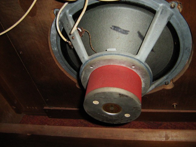

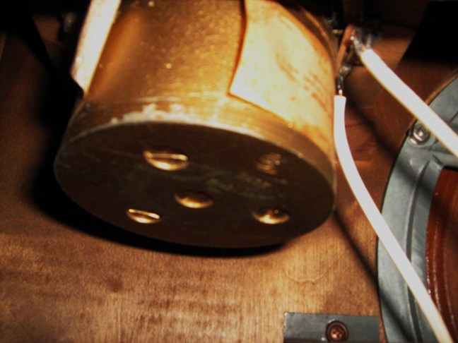

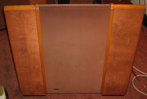

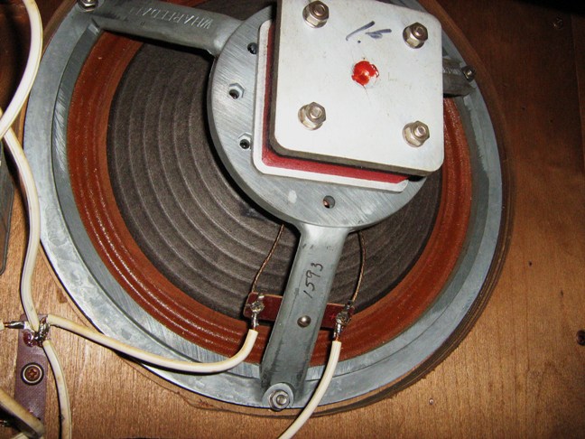

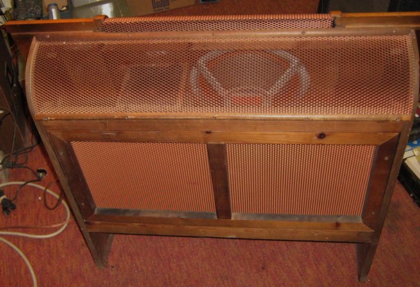

Some pics of my SFB/3s for reference for those who might be interested...will post measurements as OP requested when I can.

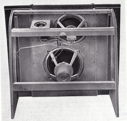

I am assuming you have this photo of the SFB/3 already Marinus, but if not it will come in very handy as I will reference my measurements to it.
Regards. Leon
Yes, had found it already. Thank you, it always helps to know one is referencing to the same item (picture).
