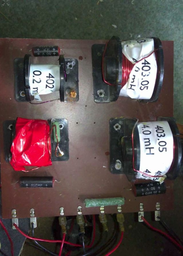

If you have swapped the midrange drivers between the speakers and
confirmed its a driver issue then fair enough get a replacement driver.
You got them dirt cheap and keep it that way, they are good
cheap and very poor if you start chucking money at them.
The red tape might be that they simply didn't have the right value tape.
rgds, sreten.

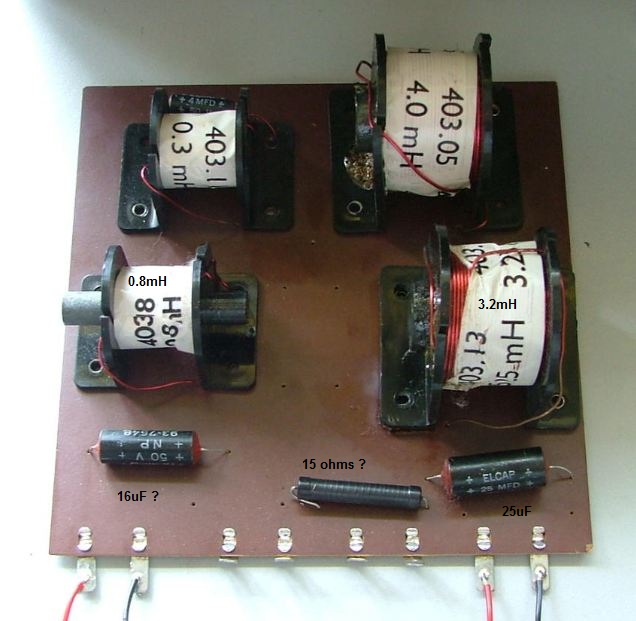

Those are the XP3 Glendales you are hotlinking, sreten. Different animal altogether. Dome tweeter, you see.
You really need to draw that schematic of the crossover, H Burch. We've got lucky with the coils being mostly marked along with the familiar Non Polar Capacitors of which I spot a 25uF. TWO 4mH coils. These speakers have a lot of bass I reckon.
10" bass, 4" mid and 3" cone tweeter it seems.
The mid evidently sits in a stuffed cardboard tube. The tweeter will have a stuffed plastic teacup-sized enclosure glue on, IIRC.
Need the hole diameters, and the PCD of the screws is useful too, being the diameter of the circle that makes the screw centres. This is 86dB sensitivity, so I'm looking for a 86-88dB 4" mid or midbass or even full range that will fit. Or, as you say, get the eBay one.
Let's get on with it.

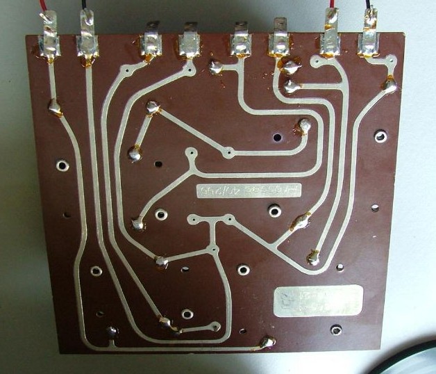

hello again.
i was as previously stated looking to get my hands on the mid from ebay but someone has helpfully put an automated bidding program onto it and it keeps increasing way to far. i only paid £10 for the pair and aint happy payin nearly twice that for one driver!, especially considering i imagine i could find two new ones for that price. which brings me neatly onto my new/ original idea of buying two new midranges one for each.
if i was to draw up the crossover for the mid range output as you suggested steve with the capacitor and resistor values i can see and have a punt at measuring the midrange cardboard tube enclosure could someone help by heding me in the right direction for specs i would need for new driver.
I am quite new to the electronics aspect of speakers but its something i am very keen to get my head around so i can progress to building full range cabs and custom crossovers.
or if the replies above already have all i need to know i apolagise for being a tad useless but as i said the electronics are a bit new.
thanks for the help guys
Hugh

H. Burch, you gotta trust us on this. We need to know the hole diameters to guess what might fit physically. I'd like to know the size of the midrange enclosure too to get the Vas and Qts right too.
See if you can work out the crossover layout and as many values as you can get. It can be adjusted to fit the new midrange unit on sensitvity. We'll do that for you. Attenuators are quite straightforward. Just supply the information as requested. Sreten and me know what we are doing.

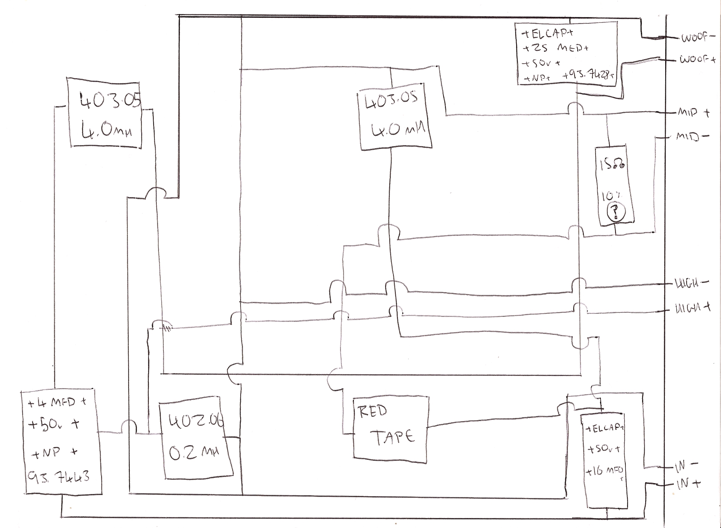

right then here we go!
I measured the Mid Range tube thus
diameter 12cm
length 20.4cm
the volume came out as
2268.5142857142837 cm cubed
OR
2.26851 liters (i assume this is the unit of choice)
the cap on the back of the tube is a bit warped due to age but this is as close as i can get.
the cutout for the driver is
10cm
the baffle is 1.5 cm thick
the screw holes are 13 cm apart and form a square
i have attached a schematic of the crossover on here for your viewing pleasure and as much of each component as i can read without taking it apart. (sorry its an attachment not on the post but for size seems better)
hope this is enough info for you guys
thanks again for your help
Hugh

This is not a cheap fix, H Burch. Best I can see is this £33 89dB Monacor MSH-115 at Falcon Acoustics:
Monacor MSH-115. IMF 4/200 Midrange replacement
It's 101mm cutout. Looks OK on 2L enclosure size (Vas 4L, Qts 0.43). The 87dB MSH-115HQ is a possibility too, but looks awkward to fit to me with a 97mm cutout but not much margin on the screws or bolts.
Monacor: Products
Thing is this LEAK midrange you are replacing is a goodish component. I don't think a radio speaker will do.

mmmm. very irritating, the unit on ebay sold to the auto bidding thingy. as a radical idea what would you think of rewiring the crossover to a two way and leaving out the mids. these are going to be part of a bigger system with subs taking care of the bottom predominantly. would it be possible to bypass the mid range of the crossover and cross the high and low at maybe 1500hz or a bit above? is this feasable?
Be very difficult to turn these into a 2-way really. I just don't know what crossover values to use. That tweeter had a tendency to blow at parties when driven hard on a low crossover point around 1.2-1.5kHz. Reason being it really didn't like the excess midrange it was having to deal with. It would be hard also to guess how to raise the woofer crossover point.
At a guess you might run the woofer just on the 4mH coil to extend its response, and disconnect the midrange crossover components altogether because undamped crossover sections without drive units do horrible resonant things to amps. I might then experiment with some modest rolloff on the bass with a shunt of about 10uF and 2 ohms 10W wirewound. You'll be struggling with the harsh cone breakup of the woofer above 2kHz. Very DIY, but then we ARE!

Old Non Polars like yours will be ageing badly by now. Falcon Acoustics do 50V non-polar electrolytic replacements which would be worth investigating.

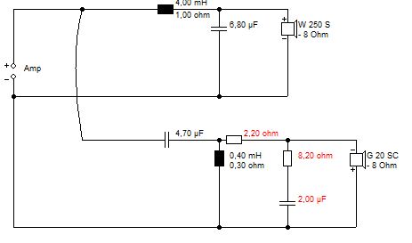

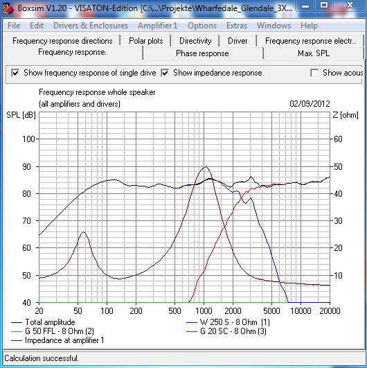

Hmm, was I the only person scratching my head over doubtless worthy picowallspeaker's contribution there.
I did a bit of modelling in Visaton Boxsim. Looks like a twoway conversion might be doable.
I roughly quartered the 25uF bass shunt capacitor to 6.8uF to roughly double the rolloff frequency from its original 800Hz. Then bumped up the tweeter crossover from 4uF/0.2mH to 4.7uF/0.4mH to increase its midrange output to fill the hole. The components in red are optional if the tweeter is too bright. It's my guess at the Zobel value plus a bit of tweeter rolloff at very HF, because I believe the Wharfedale tweeter is a bit peaky at the top end.
This sort of approach is very rough and ready because I really don't know much about the drivers, but nothing will break although you've lost about 6dB Max SPL on the tweeter, so I can't guarantee it won't fry at parties.

Let's do a review of where you are right now, Hugh. You have some splendid old Wharfedale cabinets probably around 35 litres. A decent 10" bass and 4mH slope coil prearranged so decent bass and still serviceable. This sort of speaker would cost near a £1000 these days. Blown midrange and a rather aged tweeter is your problem.
To me, this decent old cabinet and bass is just crying out for new midrange and tweeter drivers.
I could suggest you think near £250 in new drivers and crossover. Visaton have a modelling program called Boxsim that will allow you to design a dome midrange and tweeter to suit your setup. The dome midrange Visaton G50 FFL would not only fit your baffle, but give you a system of extraordinary ability along wth almost any Tweeter you fancy.
Visaton - Lautsprecher und Zubehör, Loudspeakers and Accessories
You might study Troels Gravesen's 3 Way Classic to get an idea of what is doable here.
But for now, for the two way conversion, which will not be as smooth as a 3 way because you're going to hear some rough cone breakup from the bass above 1kHz, you just need some smallish 250V polypropylene capacitors as suggested. 4.7uF and 6.8uF, along with a 0.6mm wire aircore 0.4mH coil. Looks like you'll have to drill out a few pop rivets to modify the crossover as to my schematic. You can hotglue or nylon ziptie the new components. Try Falcon Acoustics or Wilmslow Audio for the bits. You'll also need an electric soldering iron, a solder sucker and some new solder. With soldering, the idea is to use a hot gun and get in and out QUICKLY. Maybe less than 5 seconds to avoid baking components. With coils you need to scrape off the enamel on the ends to get good tinning. Capacitors also benefit form being pre-tinned before final application. Soldering is about being fast and confident and bailing out quickly if it gets problematic. LOL
