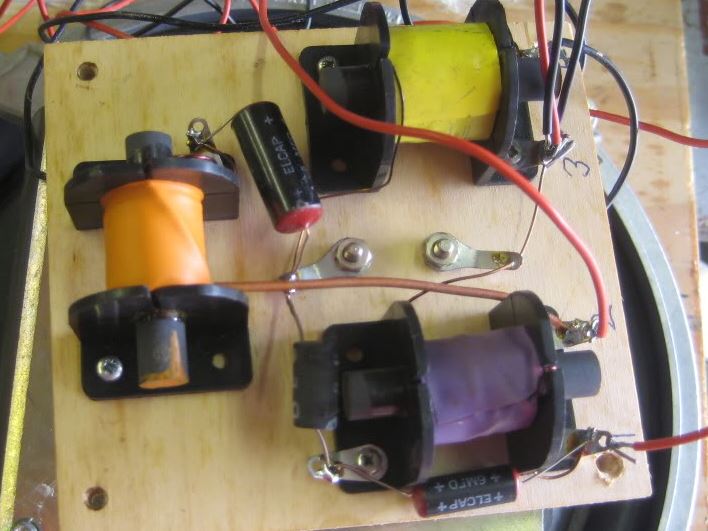

I uploaded the xover schematic for the early version with 6 components on Audiokarma in 2008.

I am sure they are. They read "Dovedal 3A" so assuming "A" being the beginning. The crossover looks right on.
