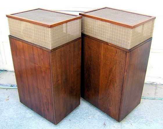

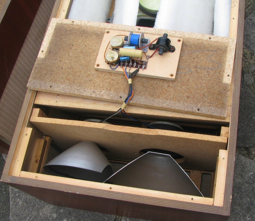

Wharfedale Teesdale (the omni-directional 3-way)
Any pictures? Seacrhing comes up with a couple omnis none called Teesdale. The SP2 version with the same name is a more convential 3-way.

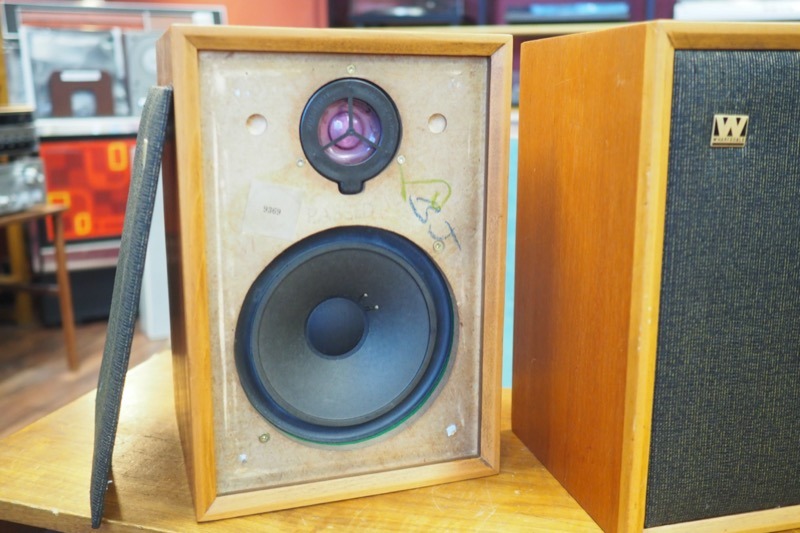

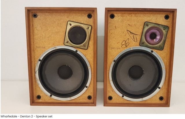

Denton 2
If they are these there is a chance i still have a pair kicking around.
dave

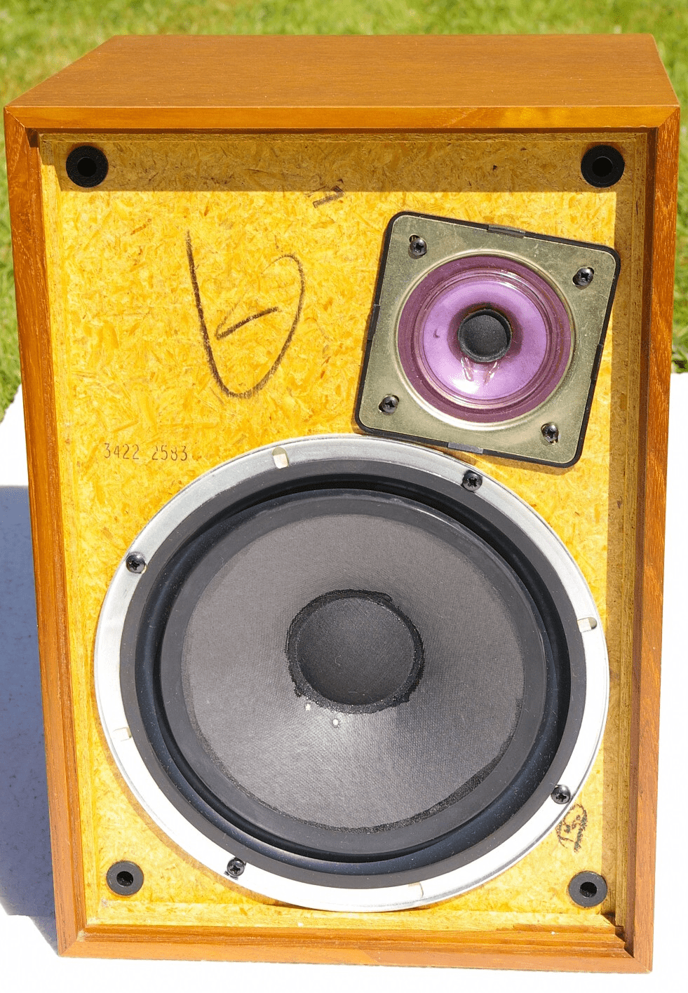

There were lots of models of the Wharfedale Denton style.
The old ones had two mounting bolts on the bass, recessed on the baffle and the purple jellyfish tweeter. The back panel was removeable. As in Dave's shot.
Later ones had a front of baffle mounting, a smallish bass and a cone tweeter with a little coffee cup sized enclosure. The crossover was quite low (1750Hz?) and tended to fry the tweeter at parties.

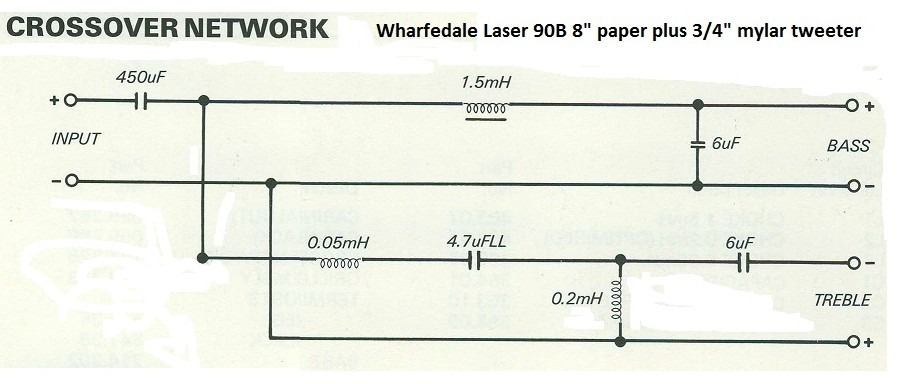

The Wharfedale Laser 90B was another we covered here. Quite a nice filter. The small coil on the tweeter input tames a plastic tweeter.
The 450uF on the bass is optional.

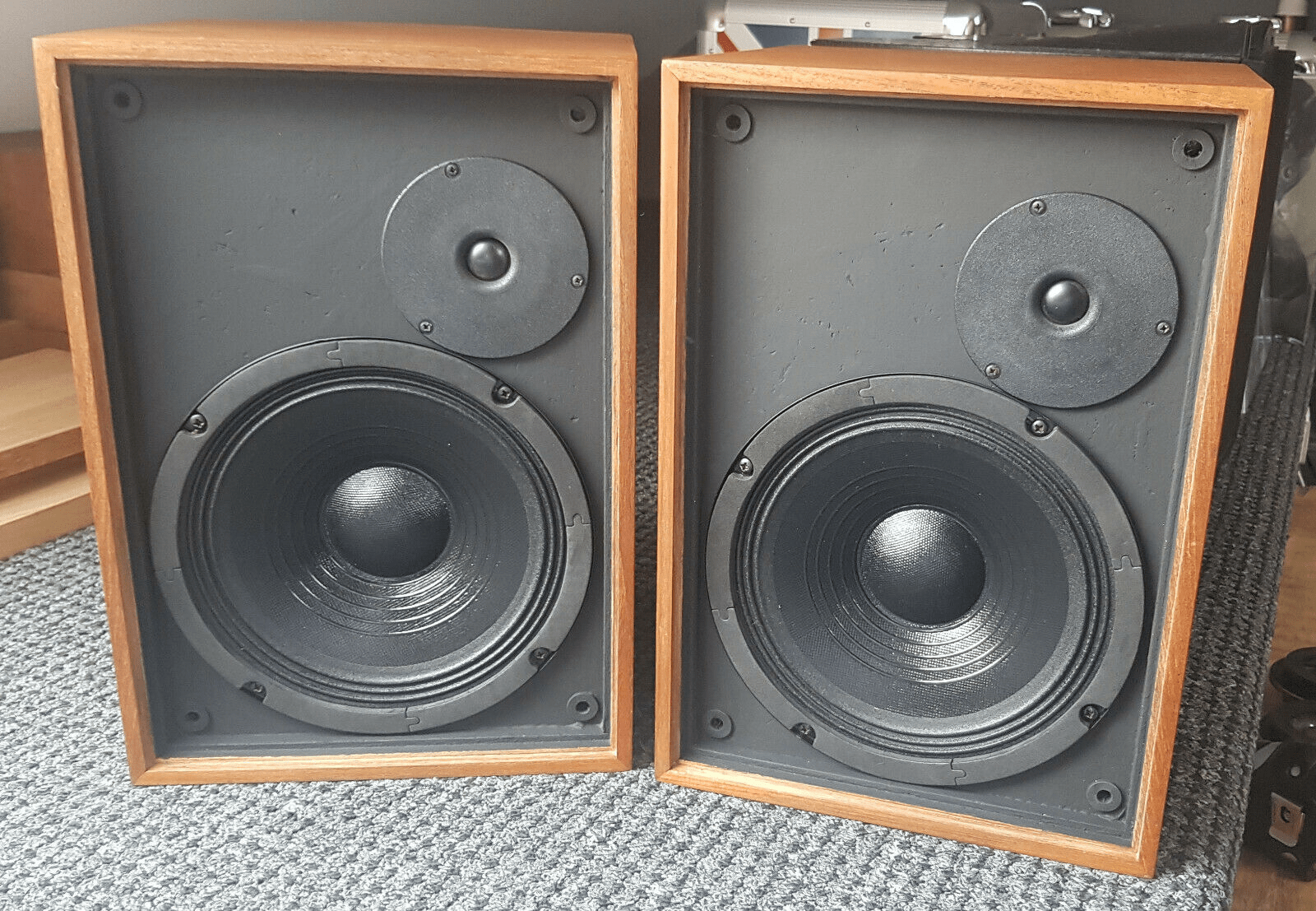

This is a refurbished pair of Denton 2 that I spotted at auction a while back:
The woofer turned out to be a cheap PA replacement and the tweeter was unspecified.
However, it does indicate what can be achieved appearance wise.

This a photo of one of my Denton 2s:

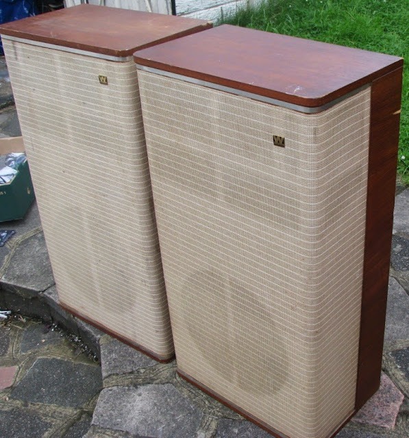

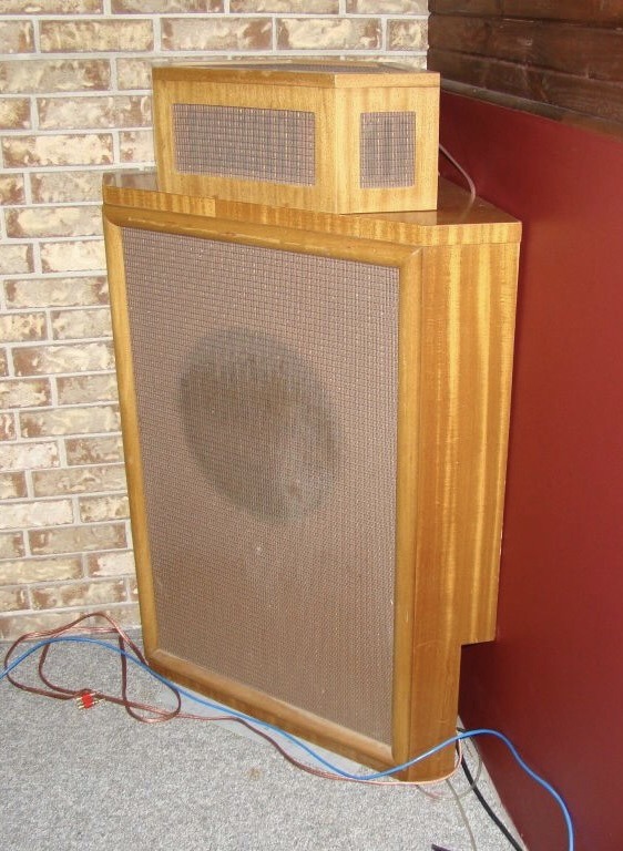

I may have a wire crossed, I have one of the large Teesdales that look like the below image. I believe the aluminium cones in the top half (pictured) were supposed to disperse the sounds from the mid-range driver and tweeter. The enclosures for these definitely warrant the term 'cabinets', quite impressive furniture making going on really.Any pictures? Seacrhing comes up with a couple omnis none called Teesdale. The SP2 version with the same name is a more convential 3-way.
The model I have is identical to the one posted by Galu (sans tweeters). The 1750Hz crossover frying tweeters might indeed line up with these lacking their drivers!There were lots of models of the Wharfedale Denton style.

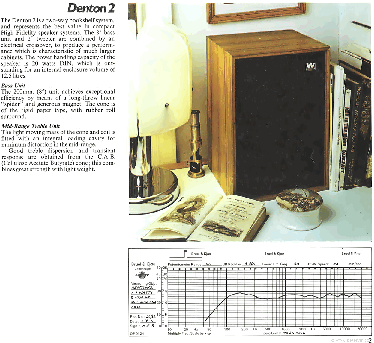

Supplied Denton FR, suggests 97dB/400mm/1.5W input.
Thanks for the caution.
What would that figure translate to in dB/m/W I wonder?
Below, for all to see, is the very FR curve you mention:
I'm affraid not even FR58-4 would be loud enough.
I see now that I had a brain freeze when looking at its specs! I read 81 dB/W/m as 91 dB/W/m. And that would still not be high enough it would appear!
I am not sure. SPL reduction due distance increase from 0.4m to 1m, about -8dB and power reduction 1.5=-1.76dB.
If they meant 1.5W as 50% voltage increase, then it's -3.52dB. There is no voltage reference and impedance/dcr also unknown.
SPL reduction
Thanks for your calculations!
Reading off the graph at 1,000 Hz gives me an SPL of around 96 dB.
According to your calculations we might be justified in subtracting 10 or 12 dB to get the dB/W/m sensitivity figure.

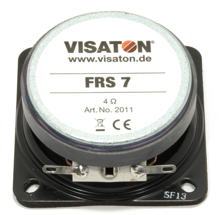

I can't find a system sensitivity figure for the Denton 2, but the later Denton 2XP (XP for extra power) was quoted as 88 dB/W/m - although it did use a different tweeter!
The Visaton FRS 7 (4 or 8 ohm) is quoted at 88 dB/W/m and might prove suitable if its physical dimensions check out.
https://www.visaton.de/sites/default/files/dd_product/FRS 7_2011_2012_0.pdf
However, the protruding circumferential lip at the rear necessitates rear mounting or the use of an adaptor plate.
A pair costs around £25 from cpc: https://cpc.farnell.com/visaton/frs7-2012/speaker-full-range-2-5-15w-8ohm/dp/LS01665
Not too much of a monetary risk! N.B. Must be FRS 7 and not one of its variants.
