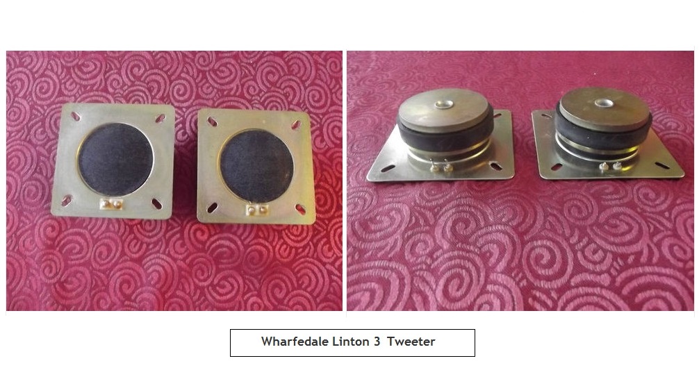

There a few references for a Linton tweeter (some with a cap as crossover, maybe earlier).
Also for the 3" cone tweeter, it seems there is also a alnico tweeter version. I will post a reference for one of the versions for the Linton 2. It was reading (first pic below),

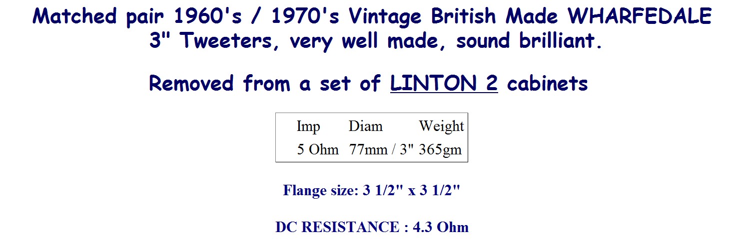

MATCHED PAIR WHARFEDALE TWEETERS 3" LINTON 2 & 3 EXCELLENT WORKING ORDER
(ebay)
Some W vintage stuff available on ebay (google, there are some tweeters for sale), Wharfedale Linton Speakers | eBay
www.ebay.com
www.ebay.co.uk/
References (I don't have any more details on the tweeters), 🙂

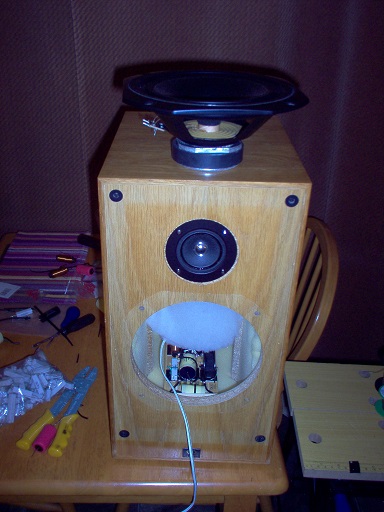

Wharferdale Linton 2
Thanks you all! Grazie mille! Obrigado!

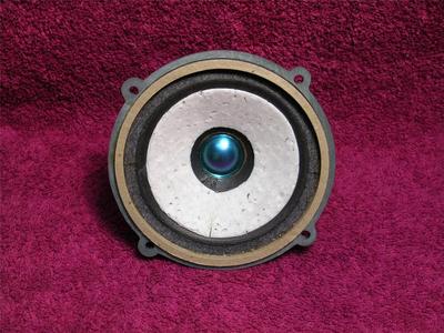

Yes, I'll replace the caps with new ones. But I'm really impressed with the 8" woofers! (picture below)
There's no further info on them, but hese speakers, according to TVK website, were made between 1971 and 1974!! Maybe same materials which can be found also on the Doverdale 3 model 12" woofers?? :scratch2:
For a 1,2 kHz crossover point, you should be able to determine if the tweeter is 4-6-8 Ω
by looking mainly at the value of the cap. I see that in the photo there are a 10 and a 25 uF, so the 10 uF should be on the tweeter path, and its impedance 8 Ω. Otherwise if the 25 uF is for high-pass, the tweeter is 4 Ω .

Wharfedale used a lowish 1.5kHz crossover point on that 3" mylar cone tweeter, and they TENDED TO FRY as a result. 😱
The tweeter crossover was something like series 10uF cap and shunt 0.18mH coil which has a rather nasty low impedance.

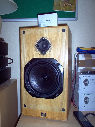

I also used Linton boxes for a satisfying later build using more modern 8" bass and dome tweeter and an off the shelf crossover.

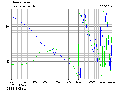

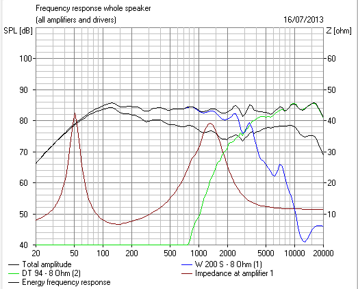

Measure the tweeter cutout to see what you might fit in the modern catalogue. I favour this Visaton DT 94 - 8 Ohm Mylar dome which is doable for good phase.
The crossover will look something like below, with a higher crossover and a simpler first order bass which suits 8" units (actually 6" paper cone) . We could tweak that to a 0.82uF tank capacitor according to your existing bass coil value which looks like 1.25mH.
This is diy, so who knows if it will all work out, but it's worth a stab. 😎

Picowallspeaker, the 10uF cap is on the tweeter path, thus it's a 8 ohm HF driver. Thanks for that.
System7, I have also two pairs of brand new crossovers. One of them has a cut-off of 4500Hz (6 / 18 dB). If original 1.2kHz xo-point tends to fry as a result, then could the 4500Hz be a solution? I have a pair of Visaton tweeters which have freq. response from 1000 to 20.000kHz that requires a crossover point of 3500Hz.
Otherwise, another pair of Signat x-overs I posted here before, but have no info on its crossover point. 😕
I'm not really into coils, so my limitations would push me to use the existing (recapped) original crossover... or one of the two pairs I already have... 🙂

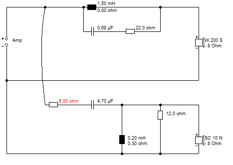

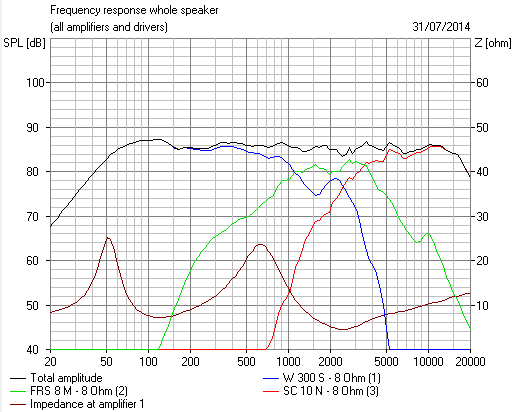

Your Visaton SC10N tweeter works pretty well. I give you a PROPER crossover below, not some MICKEY MOUSE first order effort that distorts at high level and has no phase alignment and hence rotten imaging. The treble filter could be 3.3uF and 0.3mH without much difference overall.
The red resistor adjusts level on the top end. As it is, it's likely to be unobtrusive. 🙂

It's the 0.68uF/22R tank that aligns the phase so nicely. 😎

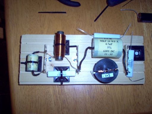

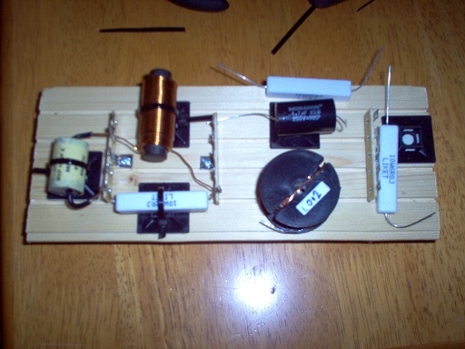

Yup. Nothing exotic. Ferrite Coil on the bass, 10W wirewounds and an air coil on the tweet. Small 250V or fatter 630V polypropylene capacitors on the tweeter. Get 4.7, 6.8 and 8.2 ohm resistors to adjust treble level.
Something that ends up looking roughly like this before you wire it all up, though you might adapt a PCB:

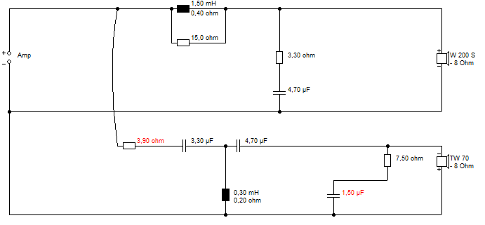

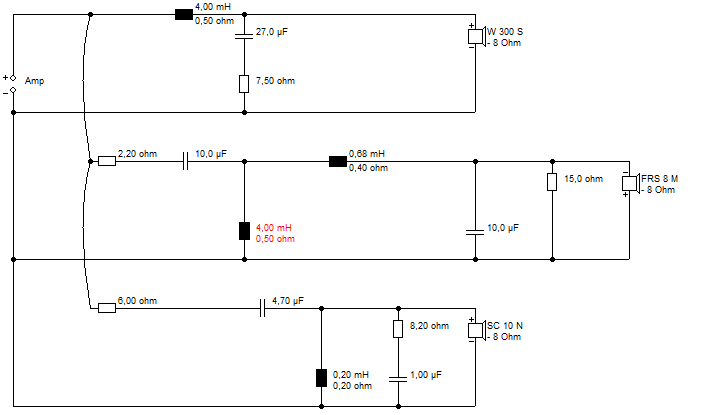

I can't quite figure out the crossover, but suspect it must be something like this:

The 3-way Dovedale is a lot more complicated I suppose, but actually a 12 ohm DC reading on the bass is not uncommon with old speakers. 16 ohms nominal used to be the standard, and the Celestion HF1300 was a 16 ohm unit AFAIK.

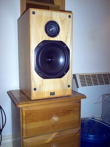

Believe it or not, I paid 4 (four) euros in a 2nd-hand shop for a very well build (diy) speakers including the incredible CA25RE4 in it. 🙂
I'm using them most of the time. The x-over has those metallic blue bipolar Philips caps. Don't know if the speakers were assembled more than 20 years ago. They look in good condition.
Nice 2-way speakers! I think I saw them before! 🙂
