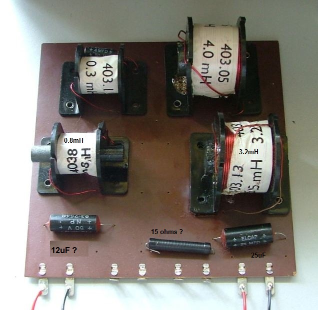

Just been given a nice looking pair of Linton 3XP, but I was disappointed by its sound: muddy, dull, lack of trebble, no presence...
So I decided to try and recap them (after 40 years, it could be necessary) and followed your recommendations to cypher007.
One is recapped, but I do not hear any improvement, so before I start with the other one, I have a couple of question.
Couldn't find the exact replacement caps: 10 µF iso 12 and 22 µF iso 25.
Is that a real problem?
There seems to be very little reaction from the mid and no feel in the tweeter: are these prone to fail? Should I look for replacements? Recap doesn't change anything.
Did change the 15 Ohms resistor. Is there a required position for it (gold ring vs black and green)?
Many thanks in advance for your help and comments. I'm not a tech at all, just a keen DIYer with a basic knowledge of mechanics and soldering.
Hugh.
I wasn't too sure about the exact values of what I guessed were 12uF and 15R, but the resistor and capacitors have no preferred polarity.
Sadly, it sounds like the drivers are failing. You'd need to take the drivers out of circuit to test them. The crackle test with a 1.5V battery works for me. You just wire a battery briefly across the driver +ve to +ve (red) and it should move forwards and crackle, or better still test the resistance with a multimeter. It should be around 6 ohms.
Your capacitor values are near enough, I'd think. Be very hard to hear, anyway.

Followed your advice and disconnected the tweeters, then used both the 1,5V battery test and the multimeter: dead. All other drivers show 6 Ohms.

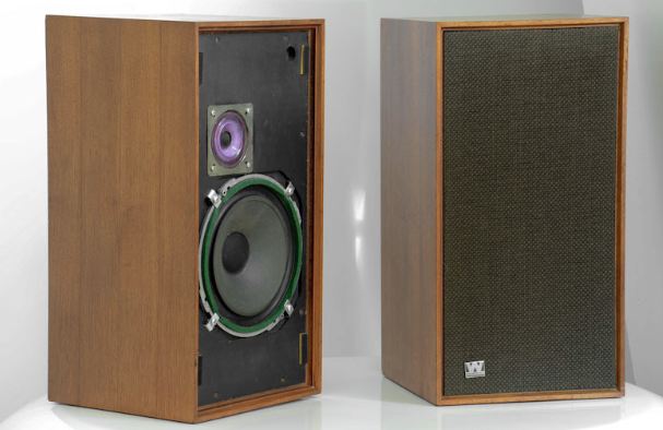

Afraid the well known fried egg shaped tweeters are ... fried indeed. That's why the speakers sound so dull, no more tweets. Pity, since you mentioned somewhere that it's the soft top which make these drivers sound so smooth.
All I have to do now is try and find a pair of tweeters, originals if possible.

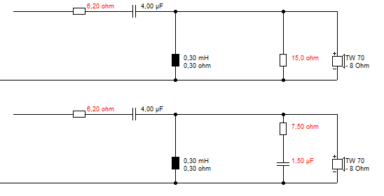

The Monacor HT-22/8 is a near 93dB tweeter. Quite loud in fact, because it has a much larger radiating area than most 1" soft domes.
HT-22/8
I find you need to halve the voltage it gets with near 87dB 8" bass speakers. Or 87db tweeters. 6dB being half voltage or quarter power. So, since it is about 6 ohms DC, a 6.2R 10W wirewound in front of the tweeter filter should mostly get you there. I would pick up a couple of 15 ohm resistors too. Or the Zobel network in the second example which use a 1.5uF polypropylene capacitor.
Try it just with the 6.2R, and regard the other two options as just adding a bit more reduction. You should be able to solder the resistors in easily enough. You've really just got to replace the 4uF with 4uF and 6.2R in series and add the zobel or 15R if required.

Thank you Steve.
Will try and find a 6.2 Ohm 10W wirewound resistor.
Where exactly should I fit it on my printed circuit?
Suppose it should connect the printed lines arriving at the tweeter cap...
Could I ask you to indicate the exact points on the attached pic, where I'm supposed to drill a hole to fit the wires of the wirewound resistor?

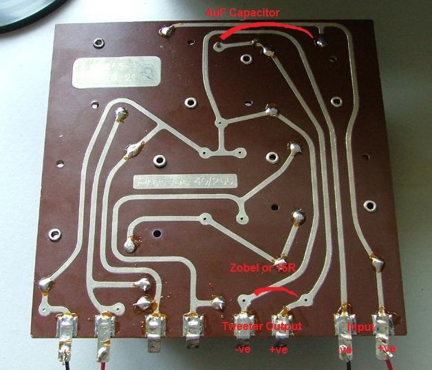

PS: Just attempted to join a couple of pics, but I keep getting a message asking me to enter URL of my pics, which I don't have a clue about...
Maybe you could use your pics and show me the exact places where I can solder the extra resistor?
Thanks a bunch!!!
It's a simple wiring job. The 4uF capacitor currently connects the speaker's +ve input track to the tweeter +ve output track. You can do it any point on the tracks.
488176d1434162935t-wharfdale-linton-3xp-no-mid-response-recap-wharfedale_linton_3xp_modifications.jpg
You've got to redo that connection with 6.2R and 4uF in series. You might drill a hole or two in the fibreglass to twist and tie down the ends where the 6.2R and 4uF connect. The zobel or 15R position is trivial to fit.
