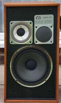

I have 6 wharfdale linton 3xp's. at least one of them has very little mid, ive connected the mid to the tweeter output and the driver works, but on the mid connection the sound is very faint.
also the crossovers have the original elcap capacitors!!! ive tried finding replacements but it would seem the only thing I can use is some motor 250v caps.
really need advice on best way to get them back to running order. ive replaced the tweeters already with some from maplins by audax.
is it worth recapping them?

You can connect the midranges directly to your amplifier and crank up carefully to hear if their sensitivity is about normal and if they don't make objectionable noises.
New NP electrolytic capacitors as usually preferred in the bass section where fitted as original. They are also small.

Really we have no idea yet why the mid is faint. Could be a dry joint, a faded 12uF capacitor or the mid itself.
Below is what I know about this nice little Wharfedale Linton XP3 speaker and crossover.
I would definitely use 12uF and 25uF non-polar wet electrolytics in the bass and mid section. You need their small DC resistance (less than 1 ohm) to keep filters well behaved here. A 3.9uF polypropylene should be OK in the tweeter filter.
Check and write down wiring polarity on the drive units before disassembling anything. I seemed to get ++- on my sim, and it all lined up quite nicely. 1kHz and 3kHz crossover, so the tweeter gets an easy ride.

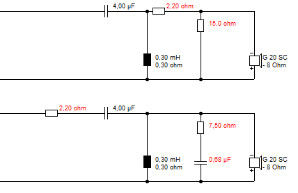

Ye Gods, attenuators are easy enough! They go before the driver and are designed to keep impedance around 8 ohms. You must always consider level when changing tweeters. Nothing worse than an overly bright tweeter. 🙂
Another way is to fit a calculated Zobel to correct impedance, and adjust a single resistor in front of the filter. Each ohm attenuates about 1dB. 5.8R and 0.03mH for the audax. I find this less fiddly overall, and corrects the rising response which the Audax has.

sorry total noob at this stuff. done electronics before but not speakers. I take it the diagram shows two possible ways of wiring it. so this will bring the audax back inline more with the other drivers?

which diagram should I use to balance the tweeter?

also if I build the zobel thingy what tolerance should the resistors and 0.68uf cap be and what material?
on the zobel front I can only find a 10w 2.4ohm and 7.5 ohm, would this suffice?

I have disassembled your Linton 3XP crossover effectively. It's no great shakes, but works. Frankly it needs a 8uF shunt too on the mid filter, but that is deeper stuff.
You need a new 4uF or 3.9uF polypropylene or N.P tweeter capacitor. Also some new regular 12uF and 25uF 50V N.P. electrolytics in the bass and mid section.

We really need to figure out what is wrong with the midrange. It would be good to take it out of circuit and test it alone. It should read 6 ohms on a multimeter for starts if functional. Your quick and dirty soft-dome Audax tweeter replacement was ill-judged. A cone tweeter and attenuator is indicated here for the musical Wharfedale sound. Soft domes are the worst thing that has happened to audio in the last 30 years, IMO.

the mid measures 5.2-5.3ohms using the meter ive got at work.

Well, that's good news with the mid. Sounds like it's functional. 🙂
Go ahead and order some regular N.P. electrolytics and reflow all the solder joints. Cheap enough so you might as well have a few lying about. They only last about 20 years really before the wet electrolyte dries out.
Straight swap for the existing capacitors. Replacement tweeters are untried territory, but I'd think those monacor HT22/8 units will work well with some level adjustment. Certainly sound better than soft domes, but do what you like!
