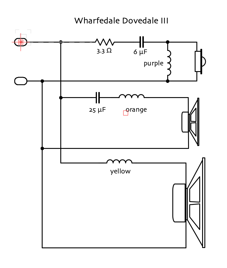

I have recently purchased a pair of Dovedale IIIs and am unsure if they are wired correctly. They only have the two speaker terminals on the back so I assume they are older ones.
I have seen a photo of the crossover on here but cant see which driver goes where. I will attach photos and a basic schematic of what appears to be happening in the cabinet.
I think that the woofer is wired the wrong way around but am happy to be put right thanks for any help.

Hi Dave thanks for the reply. Funny I could not get my head around the tweeter and I think my drawing made it worse.
So in simple terms the purple inductor allows the lower frequencies to go direct to the return and bypass the tweeter?
I was following the wire instead of seeing the connection.
Yes, it's a 2nd order electrical high-pass, so the choke shunts / bypasses a portion of the low-frequencies around the tweeter (as they would say back in the '50s & '60s. And I suppose we still do, one way or another), steepening the crossover slope. In this case, probably to give the tweeter extra protection & to improve the phase matching through the crossover region.
