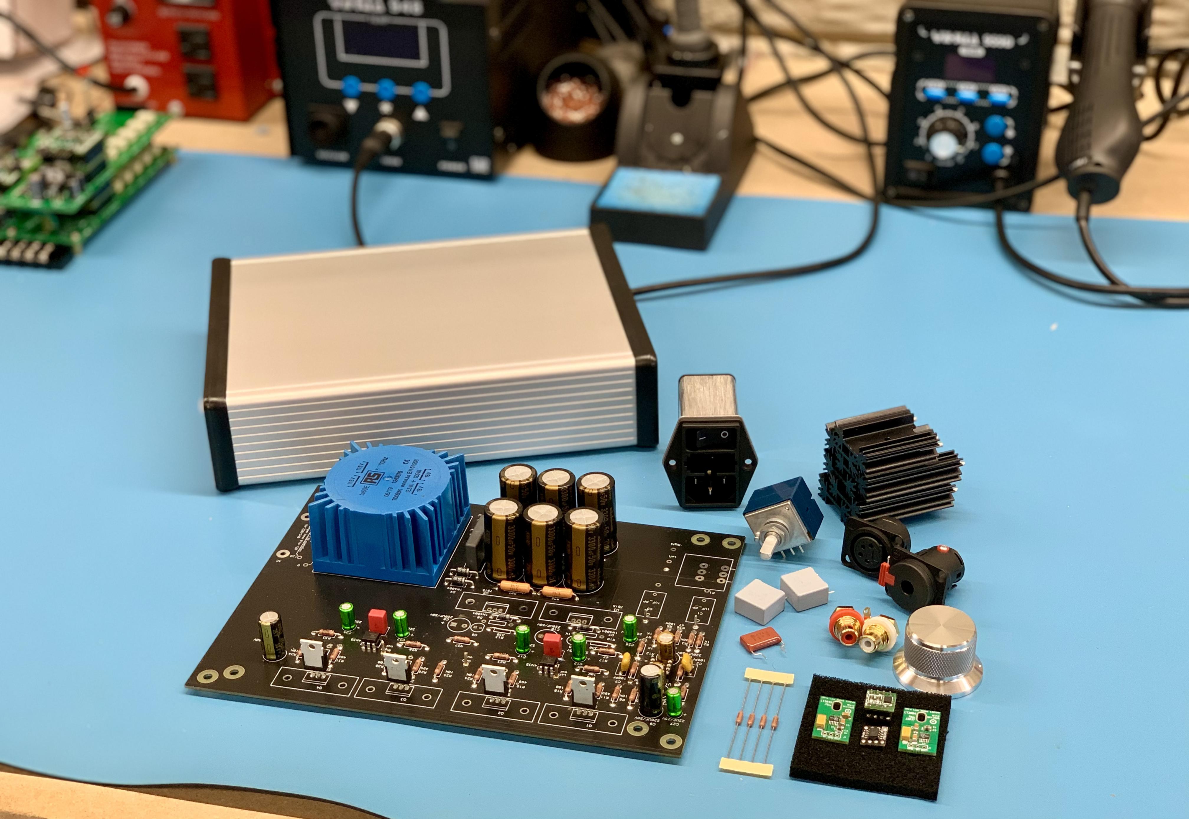

This project is a bit of a cheat since our friend @passive420 had a partially-assembled kit on the swap meet. He packed it in a box and sent it all the way across the pond to the USA, and now I have a weekend project ahead. After gathering a few accessories and a case, I'm ready for business.

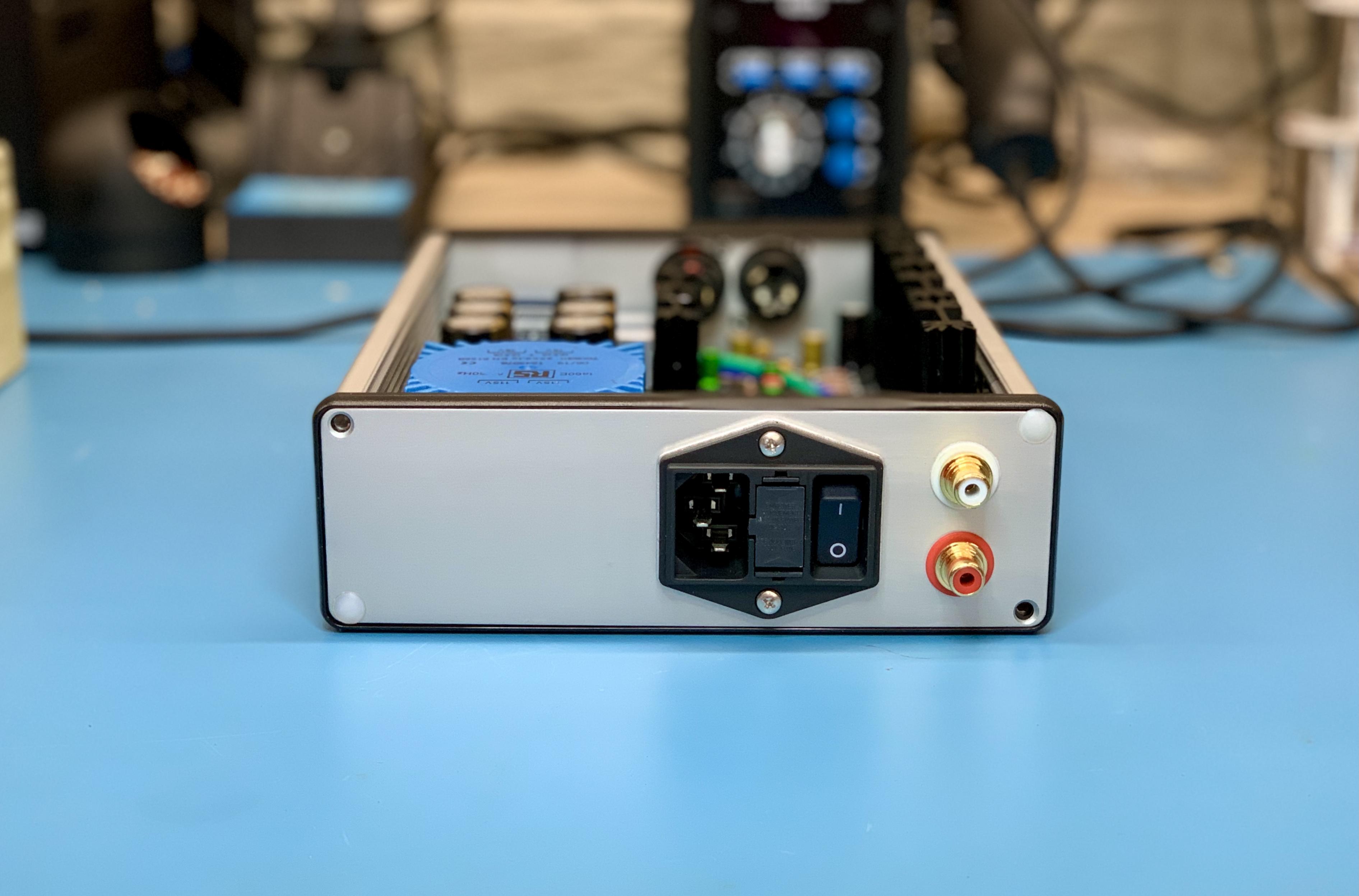

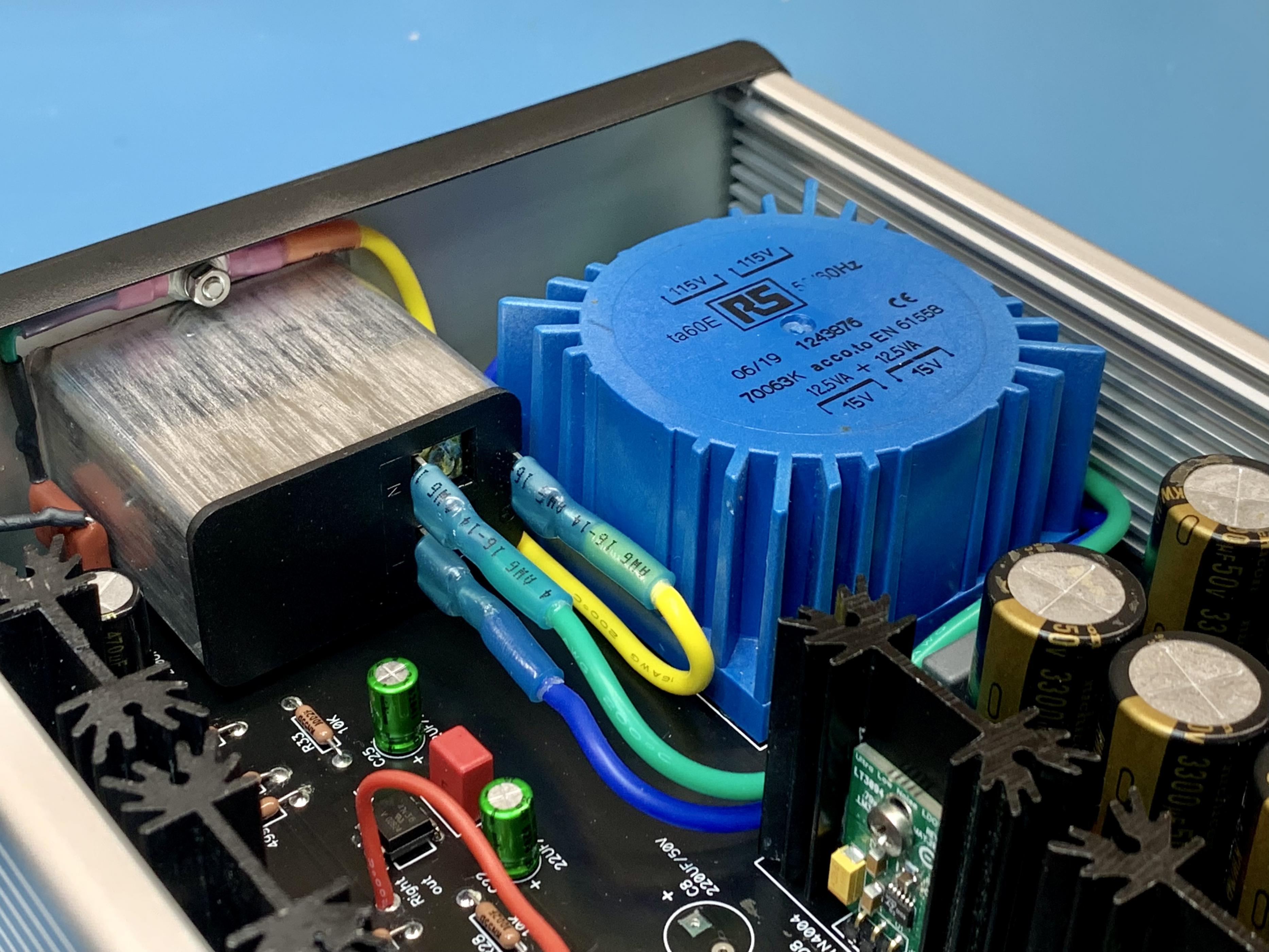

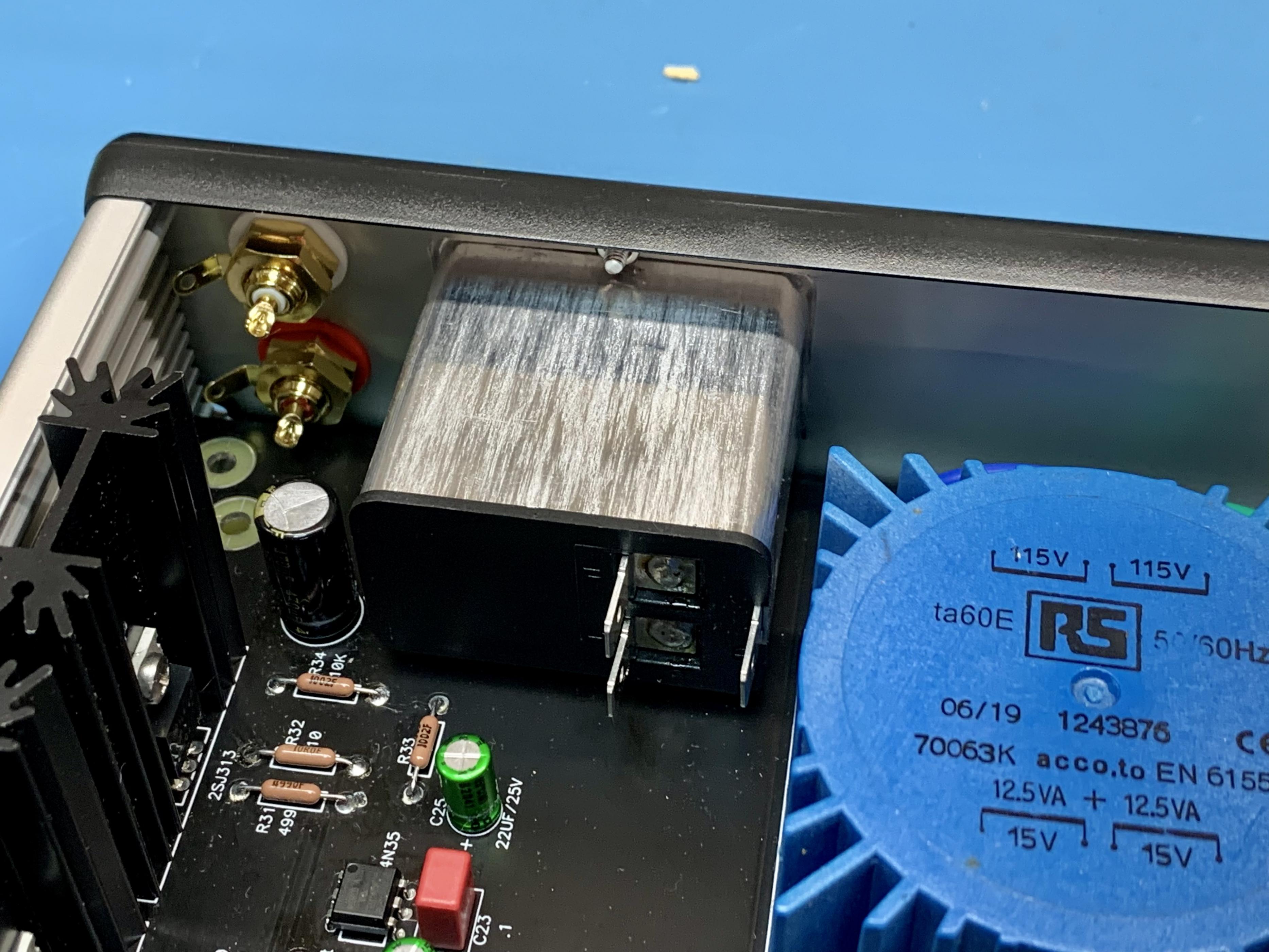

I bought the Hammond case that @6L6 suggested, and as noted it's a fairly tight fit. So I'll be following his suggestions for managing that space (primarily the location of the power input module) and hopefully get along with little problem.

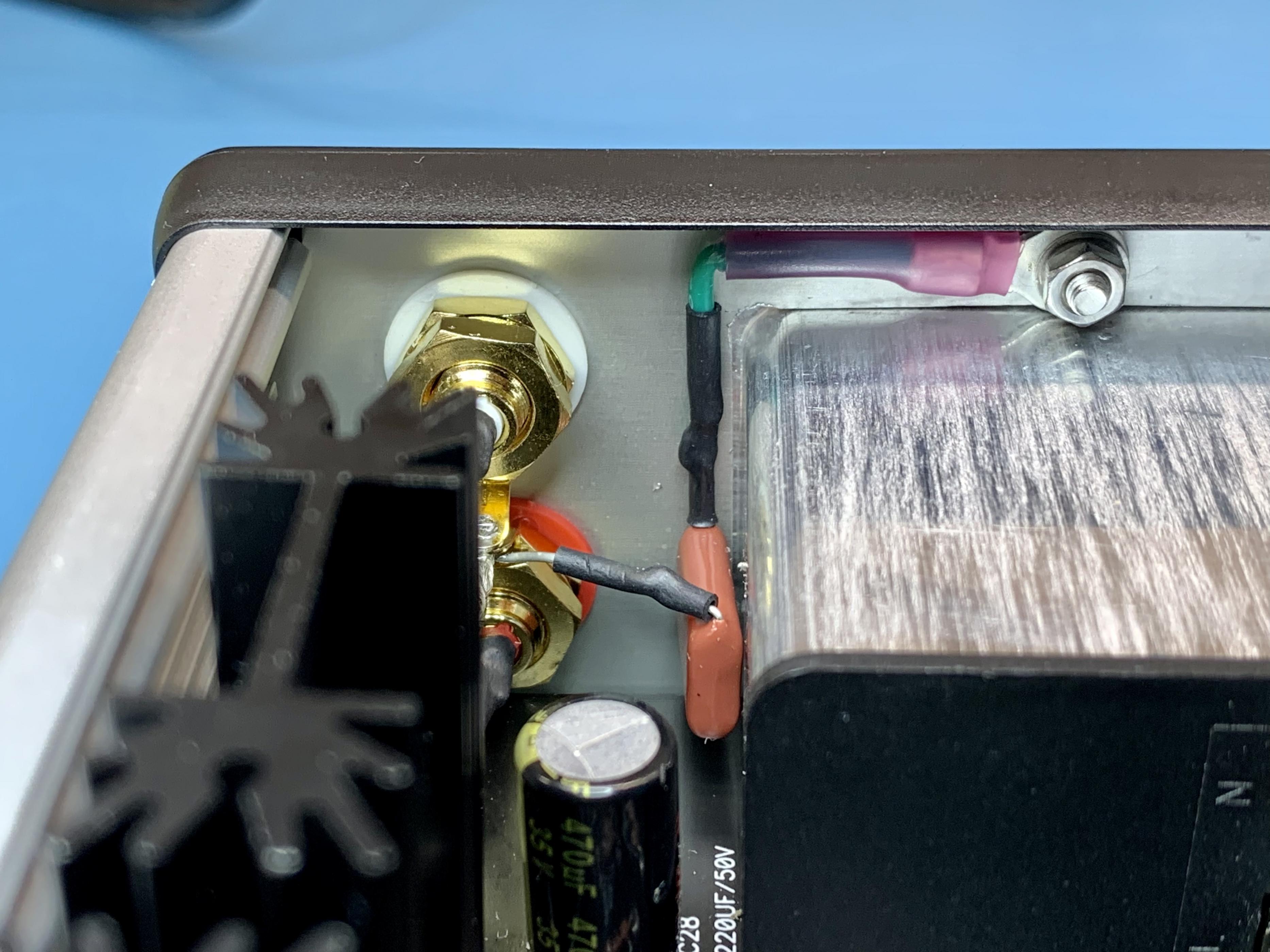

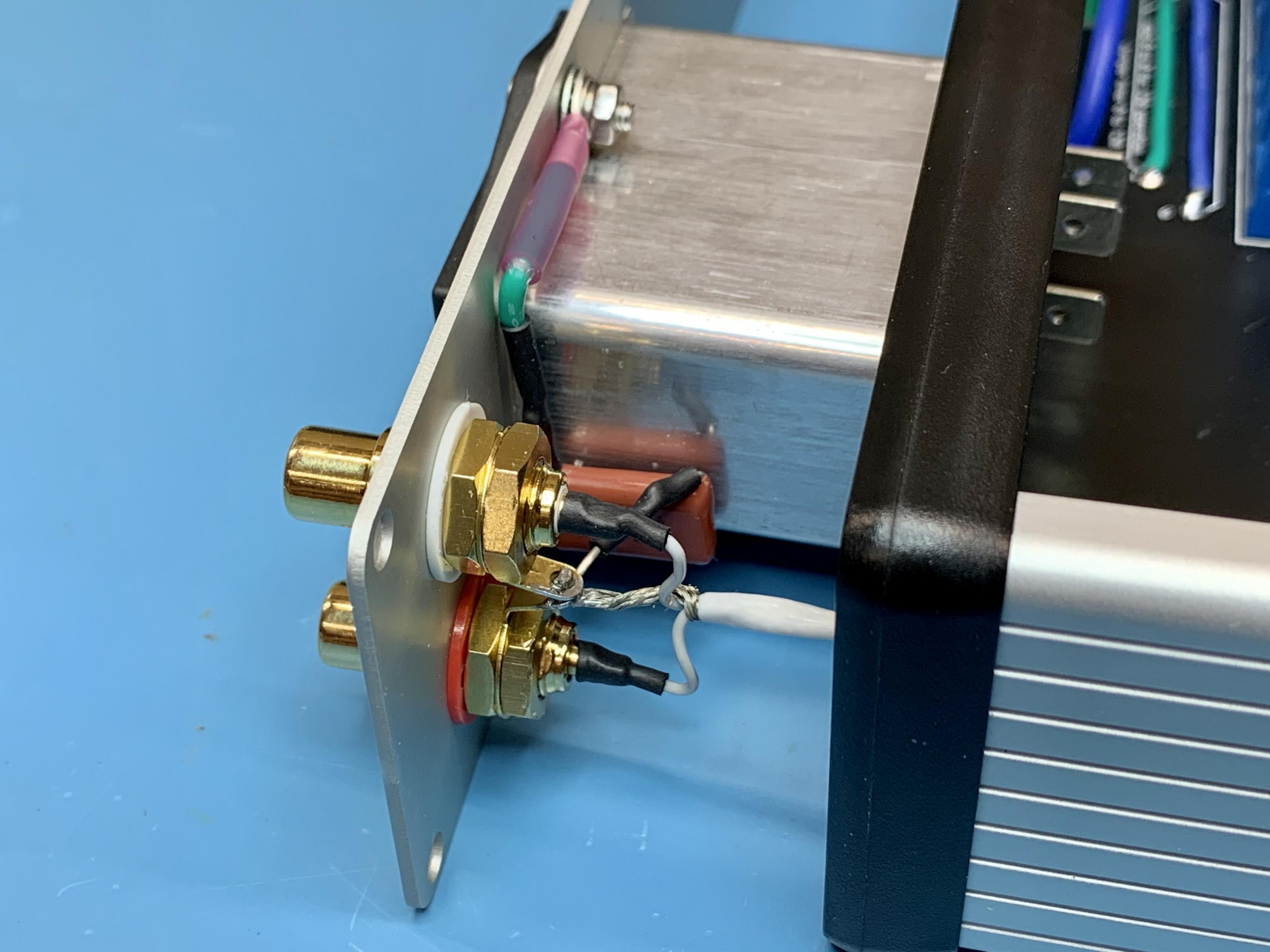

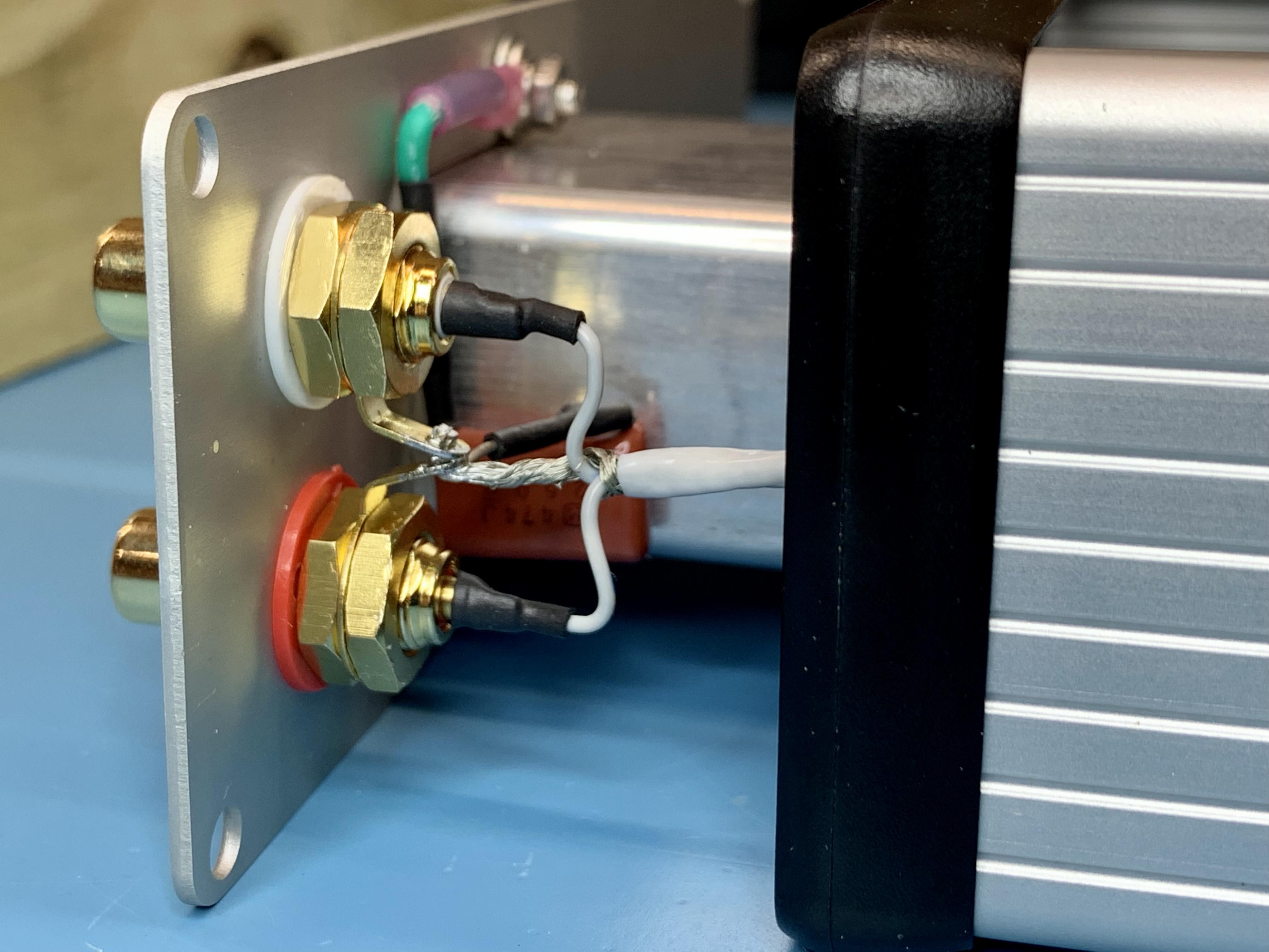

Because of the tight quarters, I picked up a shielded power input module to keep noise down where possible. Did you know they don't come with fuse drawers? I didn't. Another order, another five bucks. I had hoped to use the Neutrik-style RCAs I had left over from my Aleph J back panel kit, but alas they're too large. So a couple of normal compact RCA jacks will be used. On the amp that I have on loan from dB, he installed both 1/4" and XLR jacks on the front for flexibility, even though the device isn't balanced. I'll be doing the same.

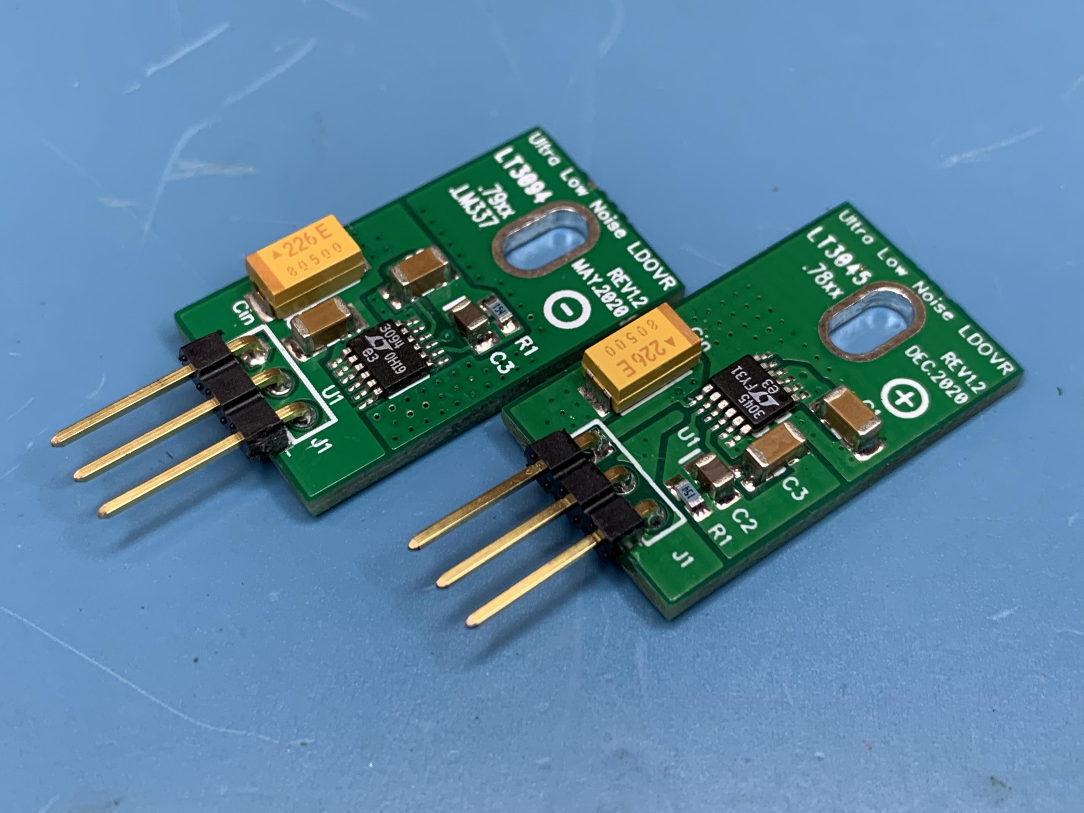

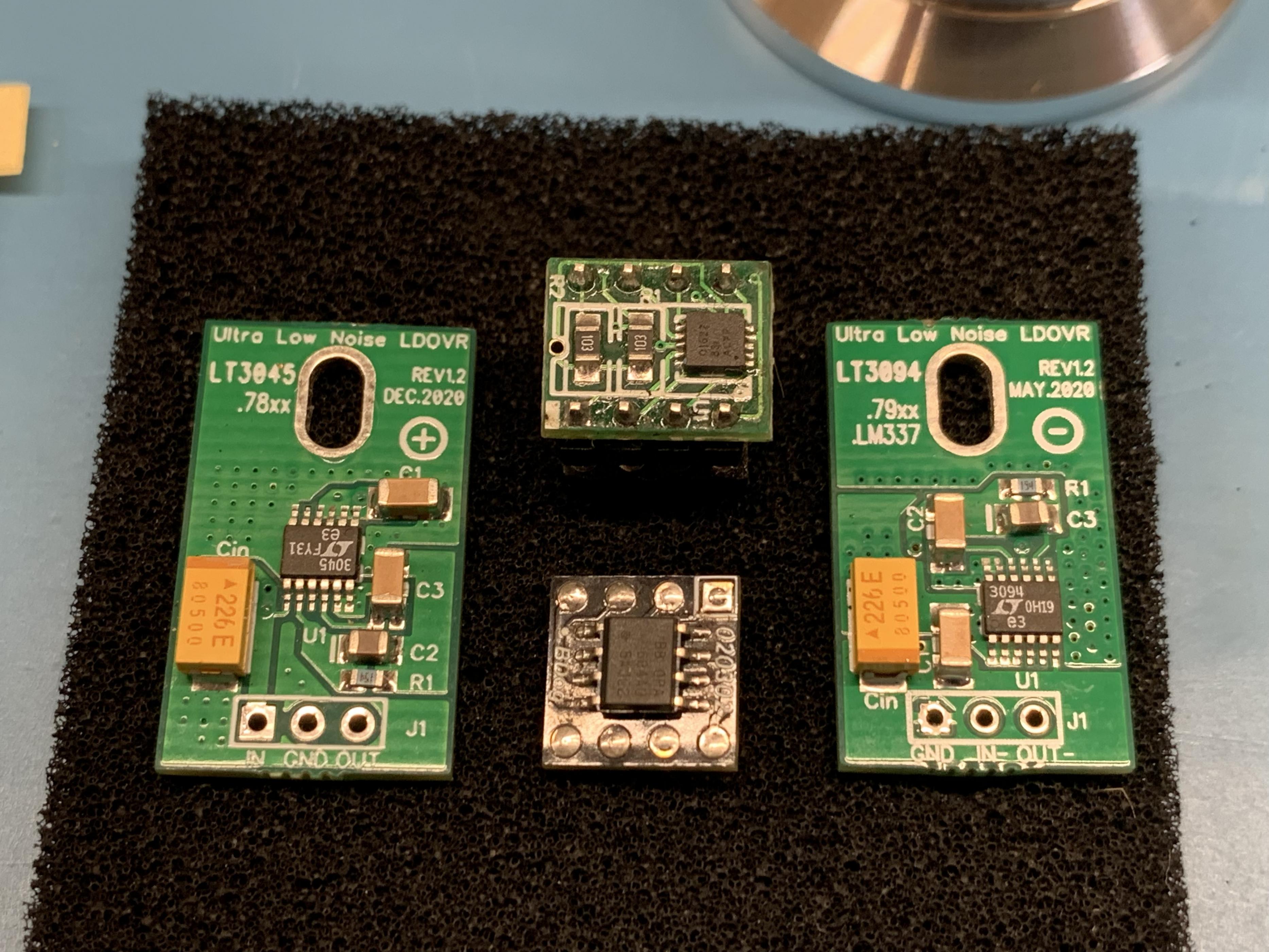

@passive420 sent along a couple of nice discrete regulators with the equipment he sent me. He also provided OPA604AU and OPA1622 opamps for my first venture into opamp rolling. This should be a fun experiment since I've never really A/B'd anything before. All part of the experience.

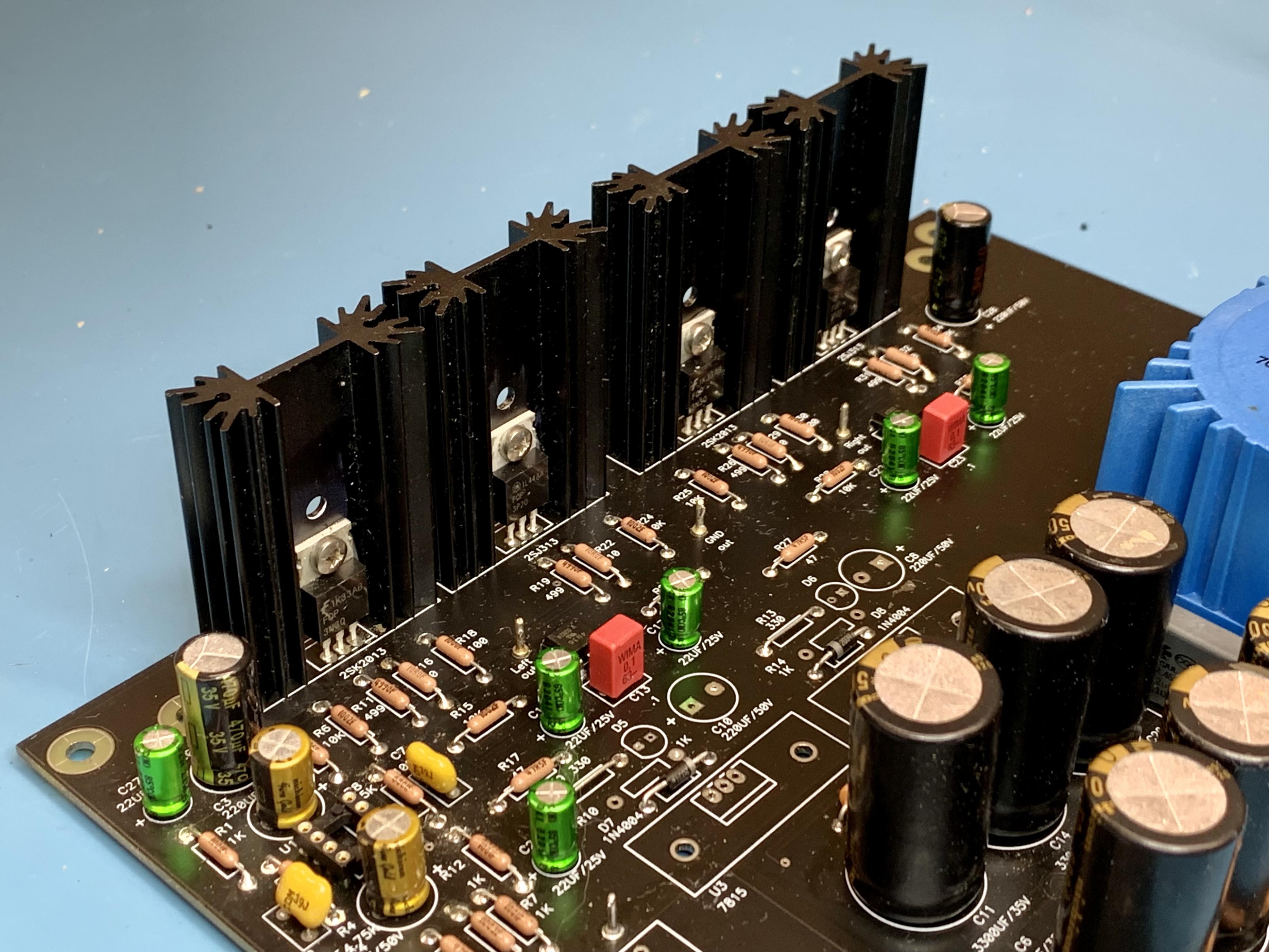

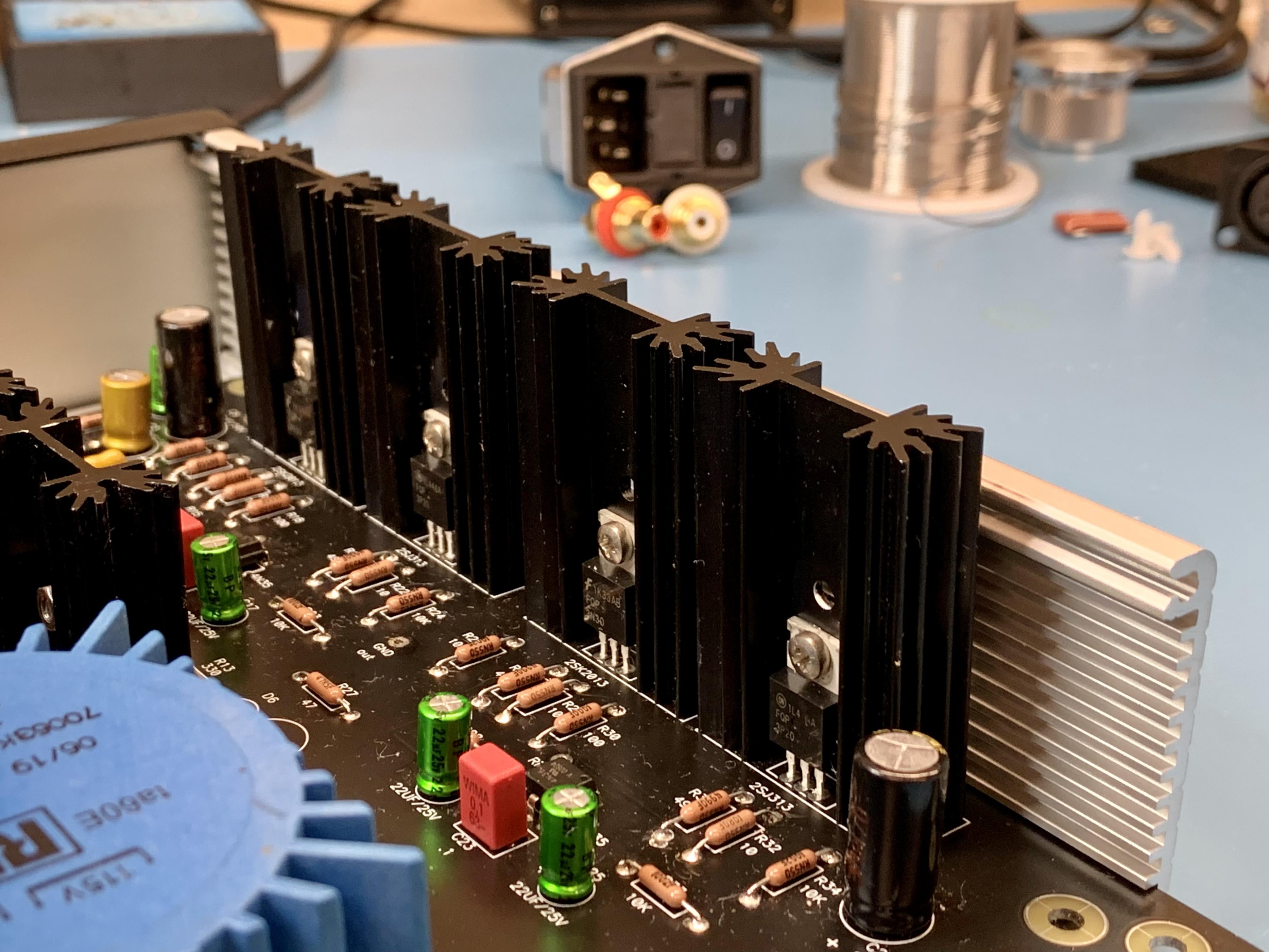

Put the heat sinks on the FETs and soldered 10 ohm resistors in. Not sure why they were missing, but they’re in there now. Also soldered some legs on the fancy voltage regulators.

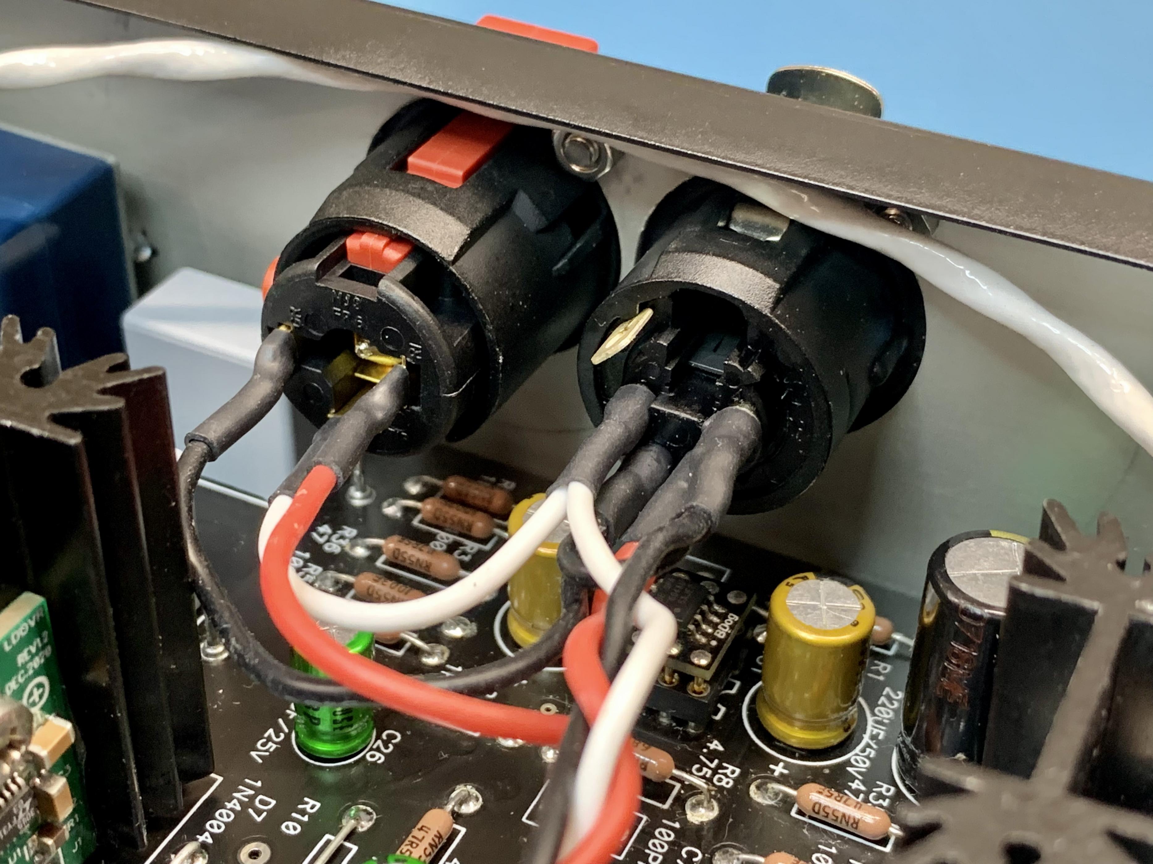

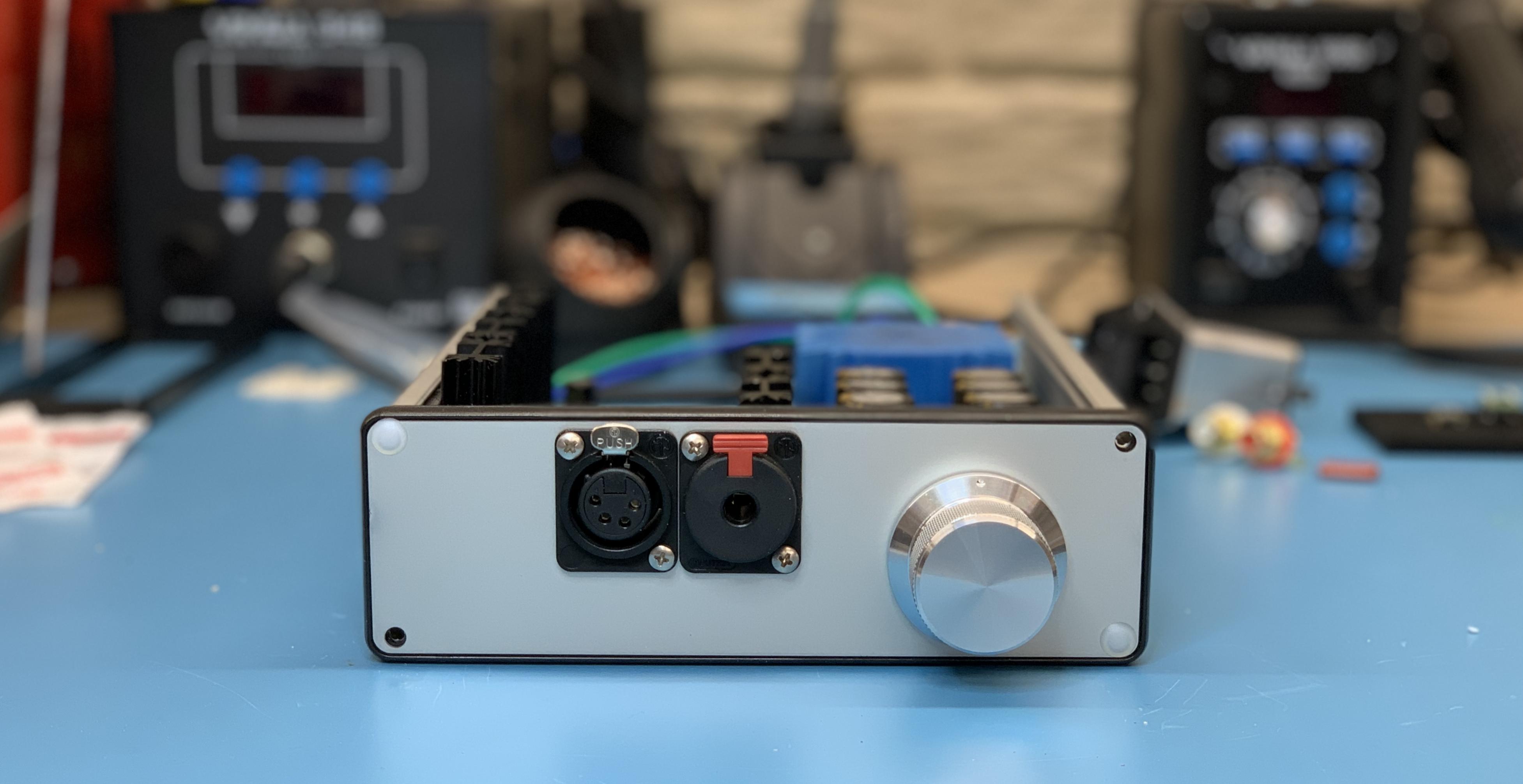

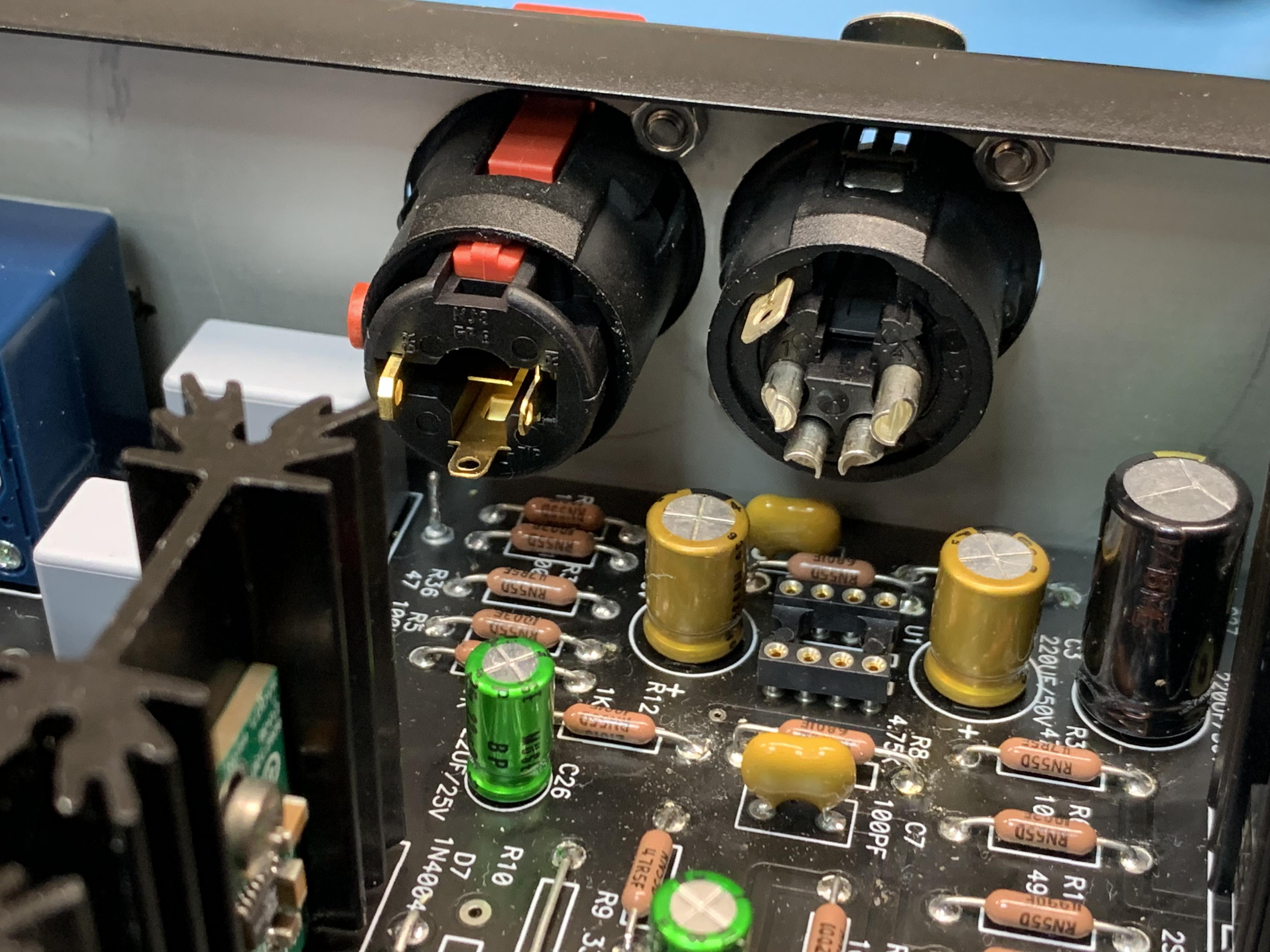

Fiddling with front panel layout tonight. The volume control is where it is, but I did have some flexibility with the output jacks. I mounted them fairly high on the panel to make opamp rolling a little easier. I’ll have to remove the knob and retaining nut from the volume control and take the front panel off to more easily access the opamp socket. And, of course no tall devices because of the balanced jack placement. That’s okay, though. Plenty of regular-height devices that will fit.
As noted earlier, the balanced jack is there for convenience, not function. It’s not a balanced output. I took the cue from dB’s amp and like the feature. Screws are temporary, as some will no doubt notice they aren’t tapered flat head. Seems like you never have the hardware you need.
Debating on power light location still. Probably upper right of the volume control tangent to the top/right edges of the knob. Small blue LED will look lovely.

Nice build so far Chris. Don’t worry about that little heat sink oopsie. Happens to the best of us, especially when surfing Mouser late at night. 😉

Maybe I should install a roll bar. 😛

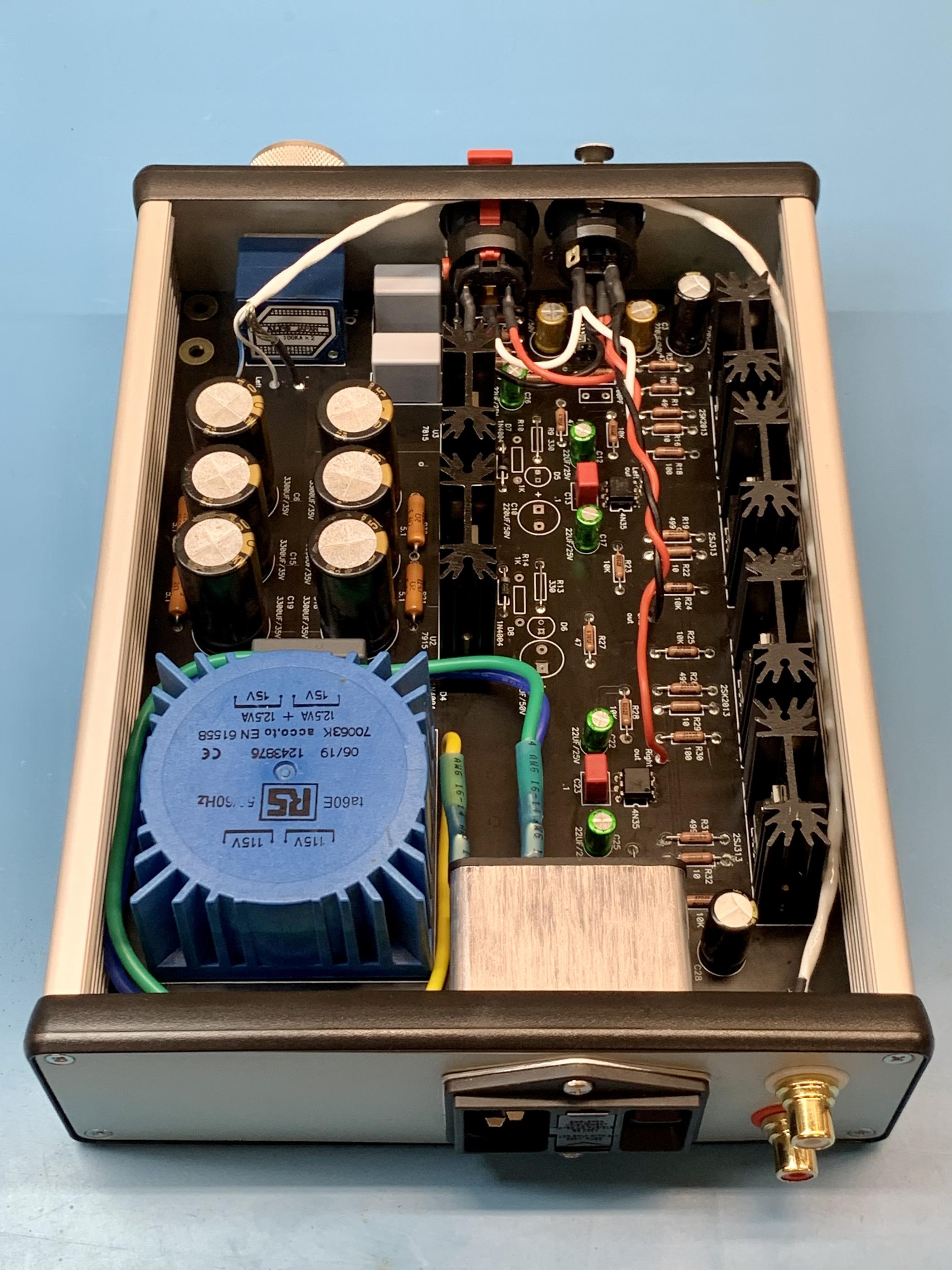

It's a wee bit snug in that Hammond chassis.
Love the open top config. 😀
I see you already installed C2 and C7. But they are optional and depend on opa used. In my case I did not need any.
Thanks for letting me know. I’ll dig into the main discussion and see where the dependencies are.

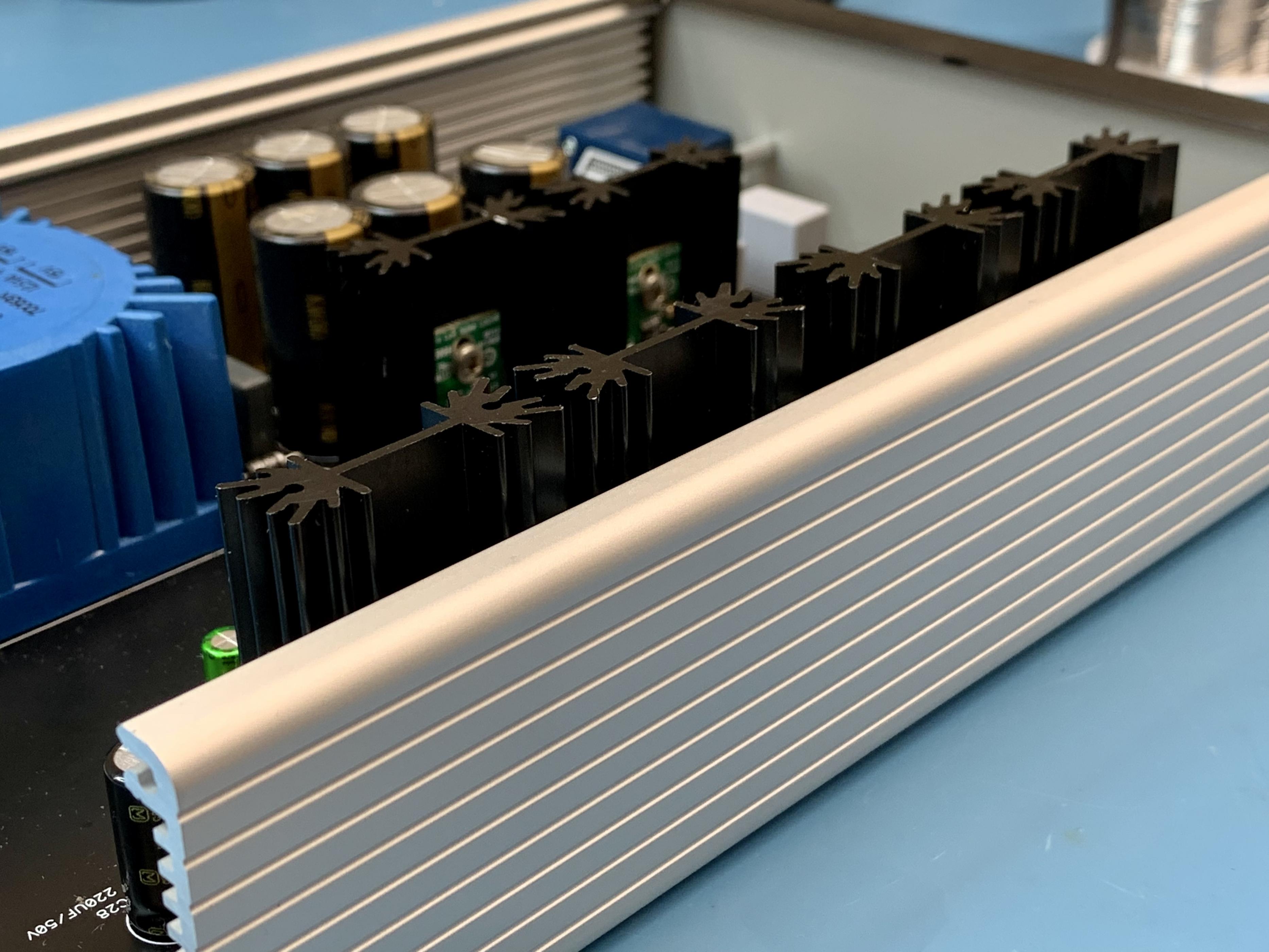

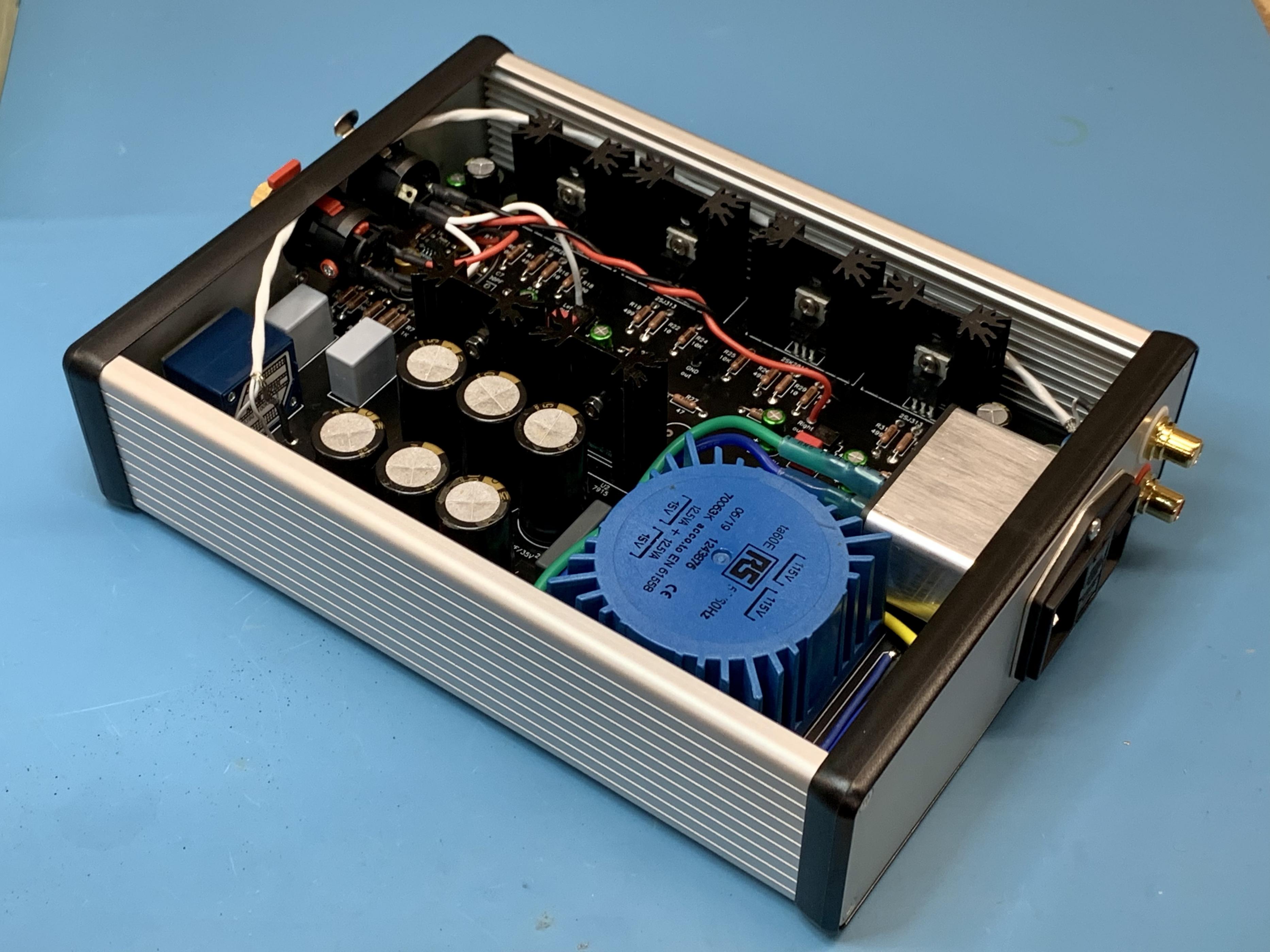

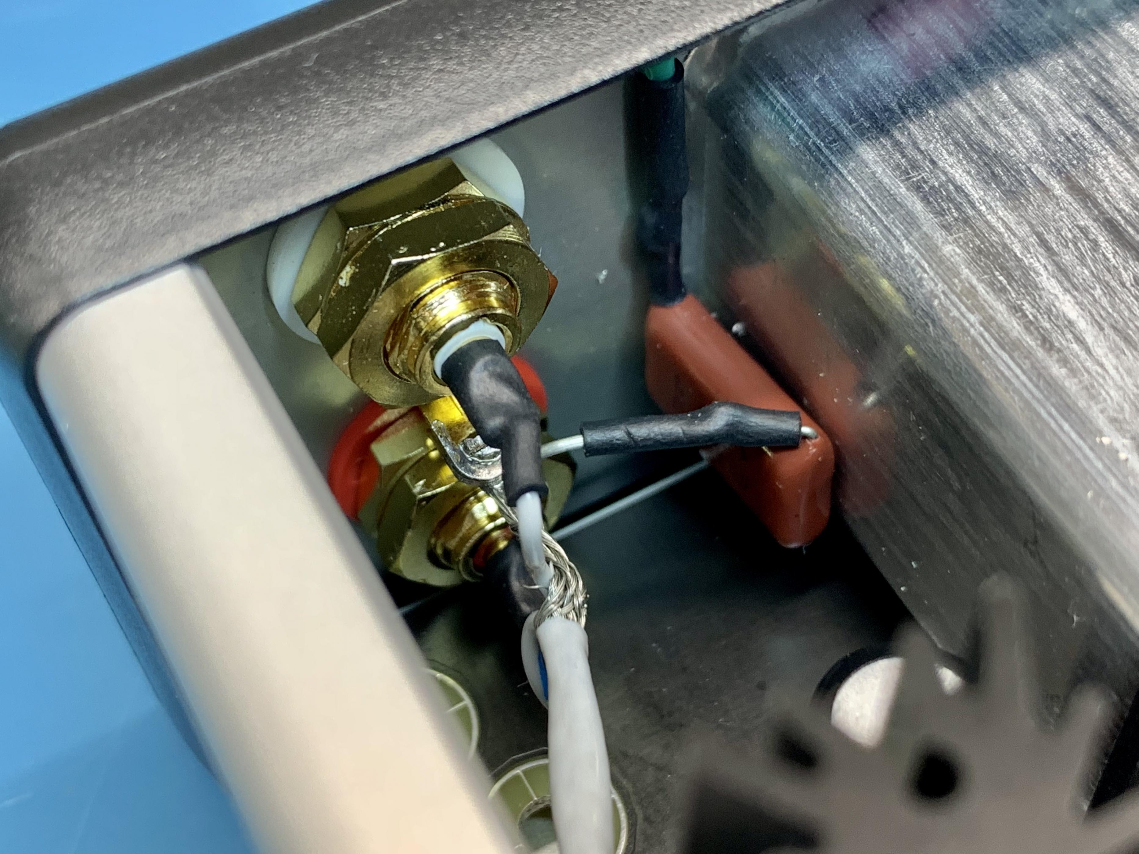

A bandsaw, belt sander, and a little high-temp black paint to seal up the ends and it’s good to go. Finished soldering connectors and performed final assembly (minus lid for now). I’ll test the unit and try a couple of opamps before I button it up. Turned out very nicely, I must say. Cool piece of kit, this one. Looking forward to listening to it. But had to leave for the holiday weekend before I could test it. Power checked it with variac with no smoke and good rail voltages. Good start.

Nice. Clean. Tight. Safe.
That's what I like about your builds. It pays respect to Wayne & Jim who designed the board.
