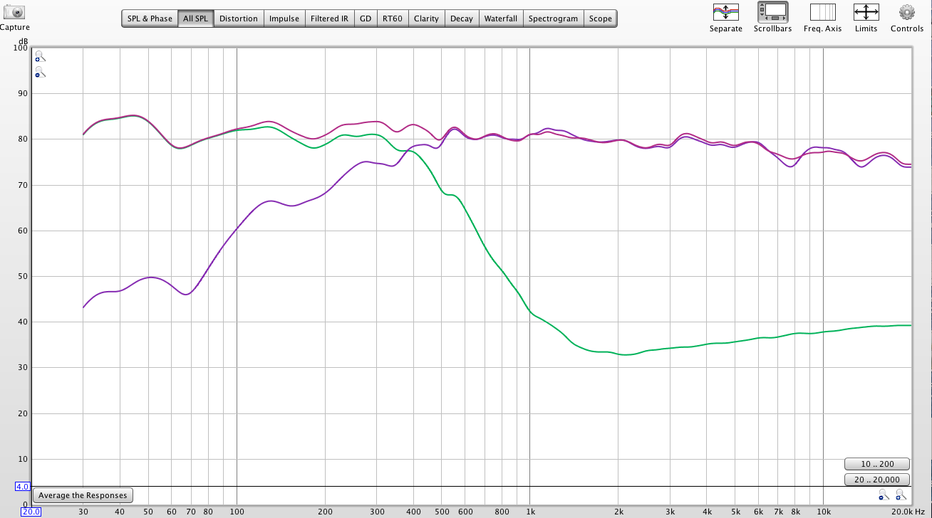

That's a bit bigger than what I had simmed.
Nice reach way down to 35Hz before dropping... but you'll need a well behaved room otherwise it will bloom.

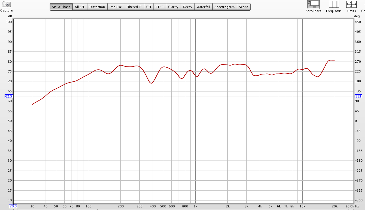

So, I took the woofers and SB65 to play with the Harsch XO at 350Hz. It's a bit low end limit for the SB65, but it sounds good so far. I might try a little higher, say 400Hz crossing next time.

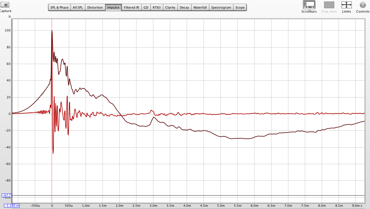

Here's what it looks like... it was a bit noisy when I took the measurements... really hard to have it dead quiet in here.

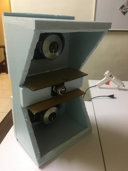

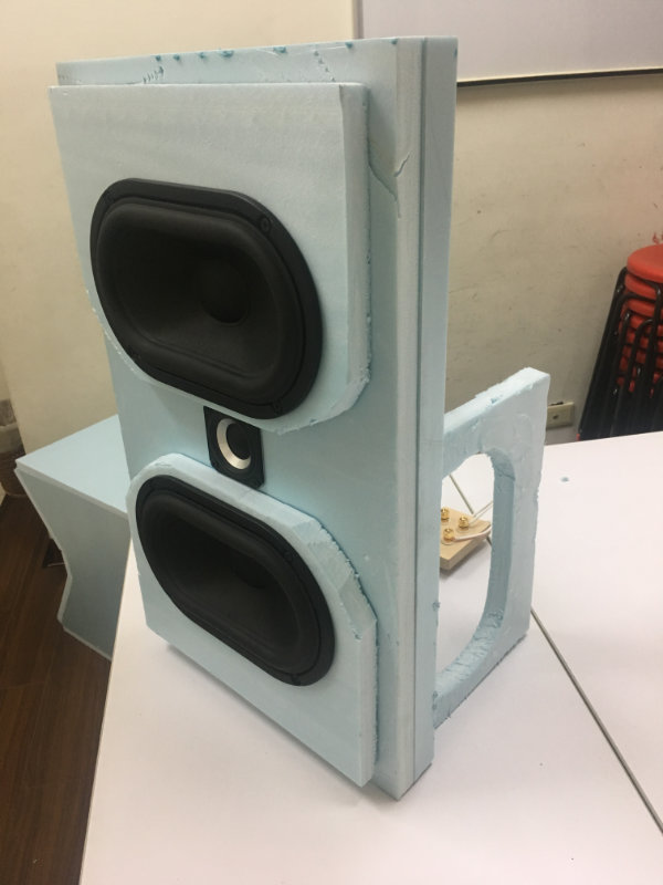

Next up, I want to redesign the boxes, so I will be gutting them a bit.
In the middle of it, I'll have fun and try the setup on an open baffle. Could be interesting. Not expecting low end reach of course, but I'm curious.

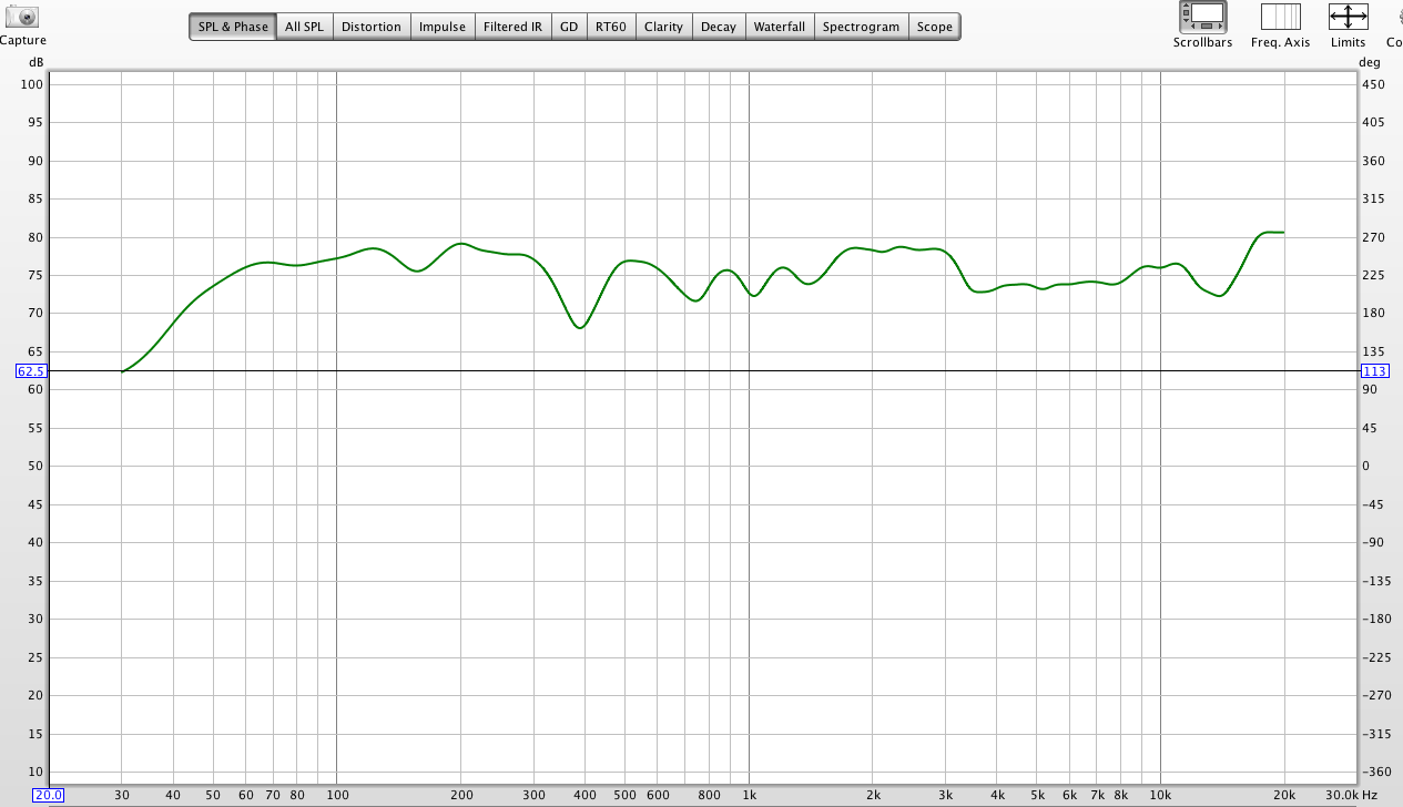

As said... OB style.
Eh! Not that bad... pretty nice in fact.
Even on the minimalist baffle, the dual 5x8 woofers have presence. And adding a +8db at 60Hz they can be very realistic (green line). Impulse still looks ok with the same Harsch XO at 350Hz.

I need to find a way to move the OB away from the wall behind them, to take care of the 380Hz dip.

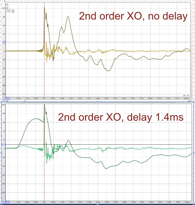

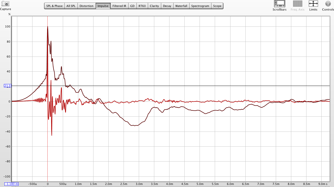

Alright... preliminary tests... and I am puzzled.
Used a simple 2nd order XO on both, at 400Hz.
First, it looks like placing the SB65 way back there with the waveguide had zero effect, as we can still see the tweeter and the woofers arriving about 1.4ms later.
Also that very weird curve before 0 when the delay is applied... never seen that before. Wondering what it is. I'll switch back to Harsch XO in the next test to see if it's still there.

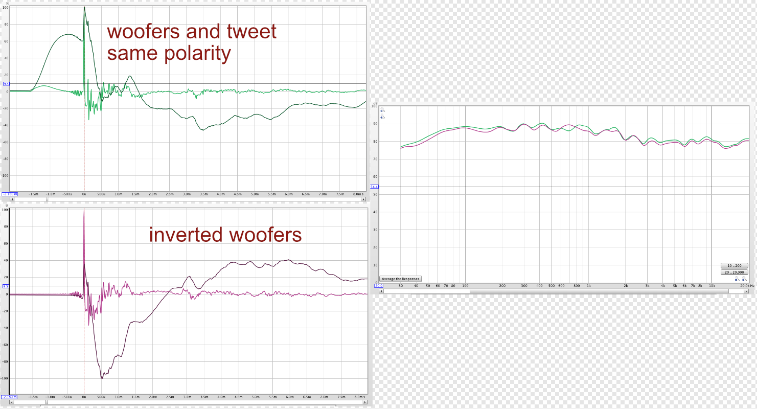

Another puzzling test.
I tried inverting the woofers, and it had almost no effect on the FR. Both FR curves match pretty well, no dip at the XO point, but as we can see in the impulse, the woofers are indeed inverted. Weird!
Also the ballistic curve before 0 is not present when the woofers are inverted.... ??
Would the waveguide prevent any phase issues between the woofers and tweeter? In combination with OB?
I'm not sure what to think of these measurements.... Doesn't help that I caught a big cold and my brain feels like jelly right now...
Try sealing the rear chamber of the tweeter or the woofer or both. I think the open baffle nature of this speaker is letting the rear wave interact and this washes out the normally sharp dip when not inverted.

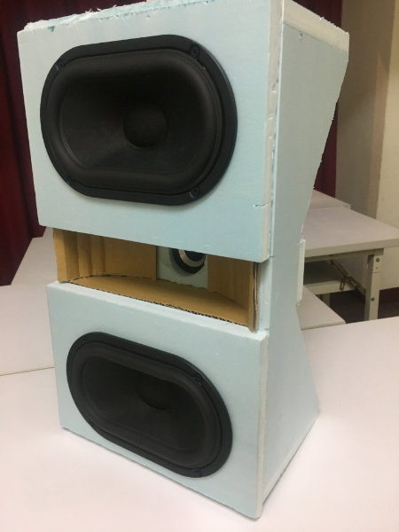

Well, I must apologize...
being sick had affected my brain. When I did the first try, I set the WG convex! I guess it gave all sorts of phase issues, and created the duller sound.
Now, having re-done the WG convex, I have pin point imaging and crystal clear sound. Funny, the sweet spot narrowed a little, so having a tweet on a concave WG creates a huge sweet spot, but messes things up.
The SB65s are finally starting to loosen up, and while the string instruments are still amazing, the voices are becoming cleaner and warmer. Very lifelike.

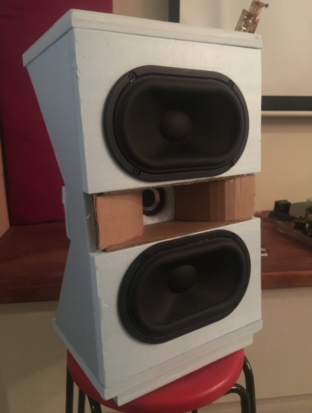

Possible concern.... The point of the MTM is to get better vertical lobes? With the waveguide and the woofers crowding it so close, it might be worth measuring 30 degrees above and below the SB65 (or any other convenient angle if it comes to it.....
I think "better" has to do with the lobe pattern being horizontal rather than tilted up or down.

I'm thinking of making an oval shape piece of wood, cut it into 4 parts to make the horns, mounting them on a back plate where the SB65 is screwed in.
