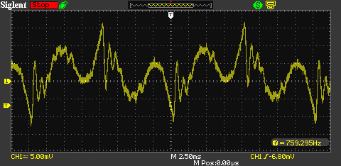

I fixed the wiring errors, re-did the heather cabling better, re-soldered all dry points, and the amp is now working... almost. All tests measurements are within specs. However, I do have a solid hum in the output, without anything at the input. The hum rises with the volume. I verified the grounding, looks ok to me. Below find attached two scope dumps. One at half-volume, the other at full volume.
With a guitar it sounds decent (I'm not a player), but the hum is very disturbing, and in some forum the builders say it's dead-silent. So I think I must have something wrong.
First, output at half-volume, no signal at input:
First, output at full-volume, no signal at input:
the peak-peak hum is about 150mV, which is clearly audible. What annoys me more are the spikes. I verified the rectifier diodes (powered off, in-circuit), they look fine.
Would you have any idea what could cause these spikes ?
The distortion on the full-volume shot is as well strange. I could do more measurements, let me know what you think, and thanks for the advices !

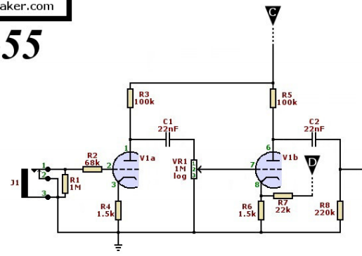

Edit 8.12.2024 : the schematics is public on this URL. Sorry I should have added it.

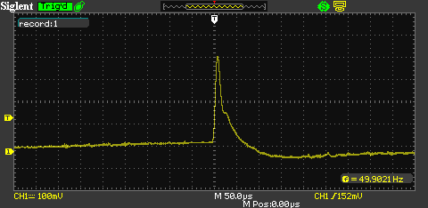

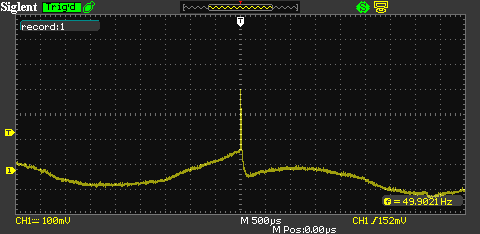

Zoom in on one of the spikes, and see if it’s actually a burst of RF oscillation. A solid state rectifier with a transformer that has a high leakage reactance is a recipe for doing this. If it is, the transformer/rectifier requires a snubber.
The diodes were tested ok, in-circuit, but I might as well swap all 4 of them. I edited the initial post with the link to the schematics. Attached are the zoomed spikes. Is it time to use my Quasimodo to add a snubbing to the PT ?

A snubber can’t hurt, even if ringing is not the issue. Ringing usually has more cycles to it, at higher frequency (narrower). This has a discontinuity in the “fundamental”, which suggests a mechanism with hysteresis. Because of level dependent behaviors with snap-back that I have seen, I’d suggest looking for h-k issues in the tubes. At least try to rule it out.

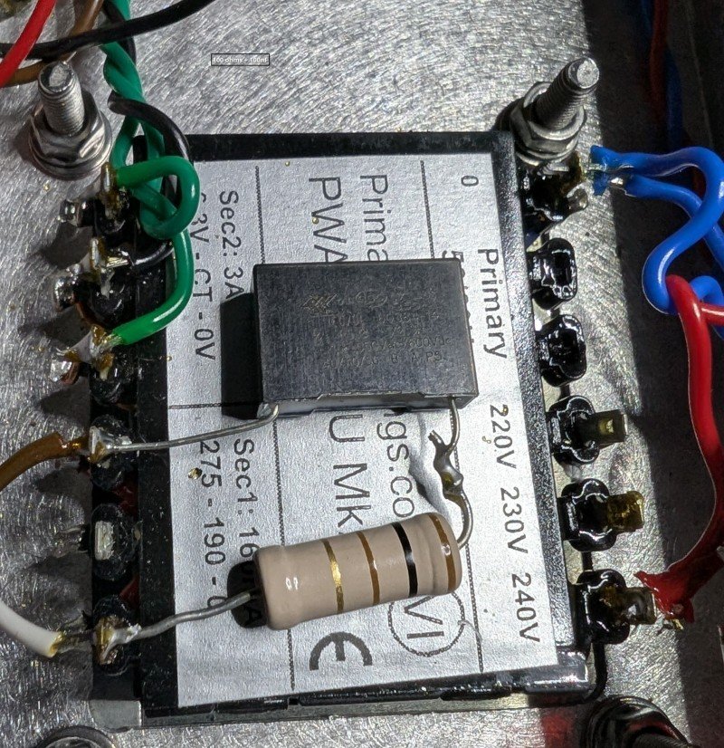

I digged my stock and made a 100Ω / 100nF snubber, applied to the transformer HV output, the spikes are gone. so the main issue is solved, thanks for your suggestions! I still have about 180mV hum, which when playing is not disturbing, but still a bit annoying. What are common /acceptable values for this kind of amp ?

While it does not seem significant, 400 mV noise at C could easily result in 180 mV at the output. Would need to run a sym to verify. I would look to reduce it via adding capacitance to the supply especially at C. This could be temporary as a diagnostic. The noise at C would not be dependant on the volume setting as you observed.
I tested adding 33 uF in parallel with the last PSU capacitor, C5. No change, but I was mislead by my differential probe, I think the ripple is much lower, barely measurable. I then shortened diverse wires, brought the grid resistor R2 closed to the pin 2 of the input tube, no change. I then measured the signal at the top of the volume pot VR1, and there I already have this weird signal, about 30mV peak-to-peak.
considering the two following stages, no wonder my output at full volume is very noisy. Now the question is why does this tube (12AX7) creates such a noise. Of course my lab is noisy with all sorts of switching PSUs, LEDs, etc, but that seems quite a mess. I tried another tube, same business.
Any hints ?

Not sure if it's still relevant , but the scope pics from post #1 look like typical heater buzz.
As the amp uses heater elevation, that's a bit surprizing.
Nevertheless you could try a cathode bypass cap of 25µ or larger at the input triode.
Some tubes are more prone to heater buzz than others.
But also check the heater supply wiring.
