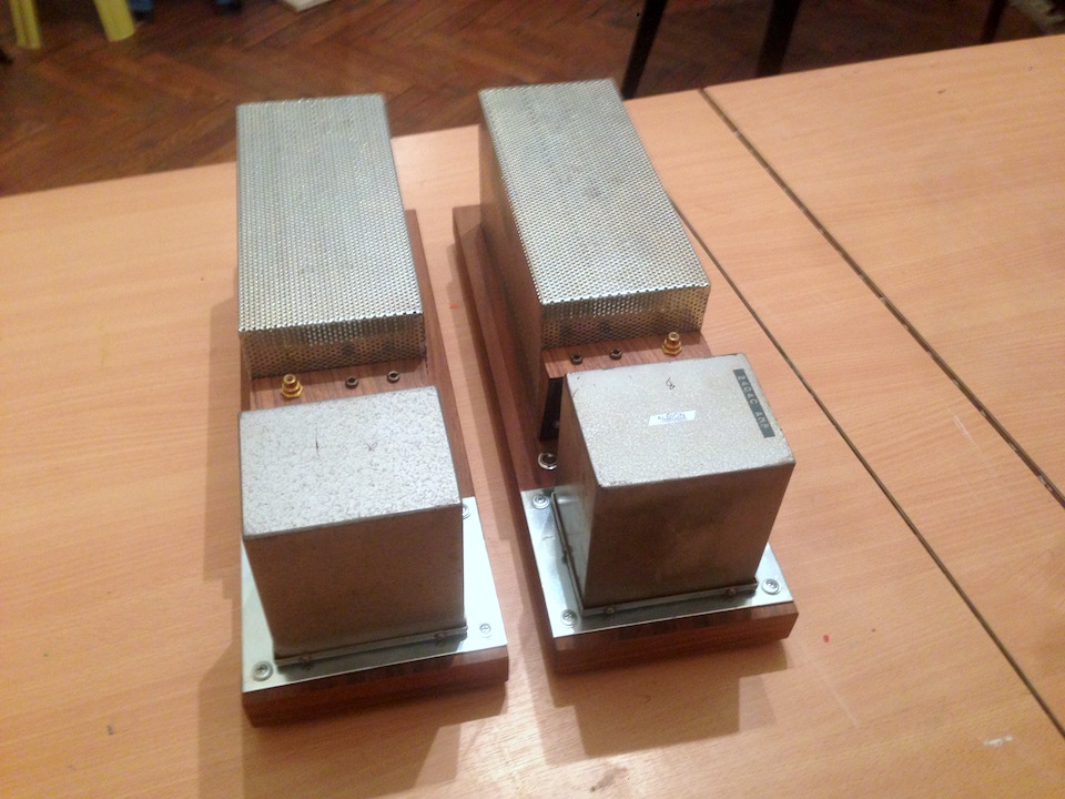

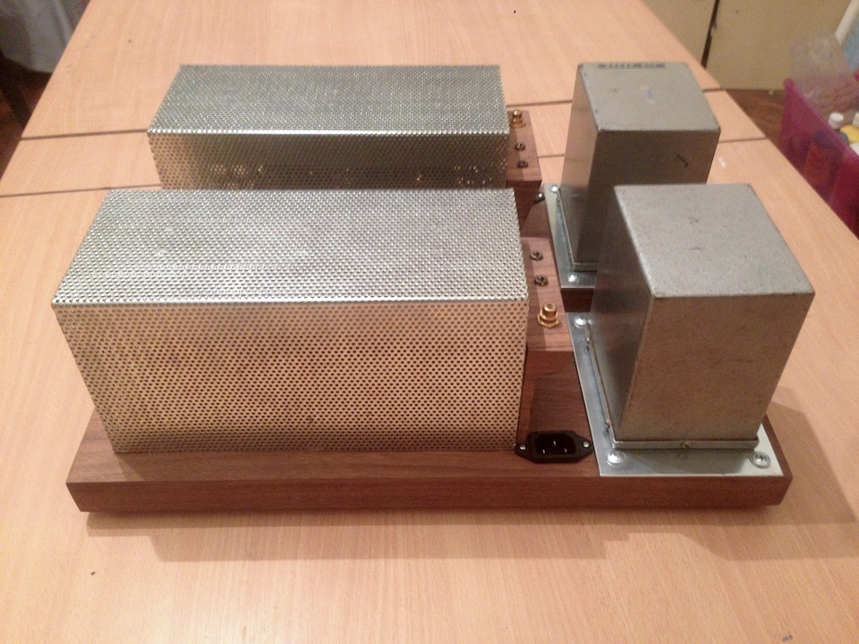

Intersting. I don't remember ever seeing Westrex in the USA, just Europe and of UK origin. I have seen some Vitaphone labeled horns that must have been W.E.Westrex was the talking-pictures division of W.E., and mostly worked in the US, Hollywood, though sold and serviced any place movies could talk. As the UK made and showed good talkies they would have an organization there, but a bud on the US head.
Is Zoran's amp a cinema amp? And from what decade - the 1960s? My Magnavox and Clairtone germanium amps are both early to mid 60s.
I think that it was mono block amps for rack console. For the cinema audio branch. They come with preamplifier units same brand, and 2way Westrex big box loudspeaker system with LF 15in unit 2080E and big HF unit 2390A. All alnico. I have these units and they are in perfect condition, 2390A running in current system...
(Strange, additional monitor speakers was labeled as Westrex, but inside was fullrange University 8in alnico (beautiful), driven by Leak TL12+, P-P ultralinear, british amplifier unit. I restored this Lak amp too and it is very very good sounding amp.)
I thought the last Westrex audio products were record cutting lathes and their power amplifiers. That is what I assumed Zoran's amp was.

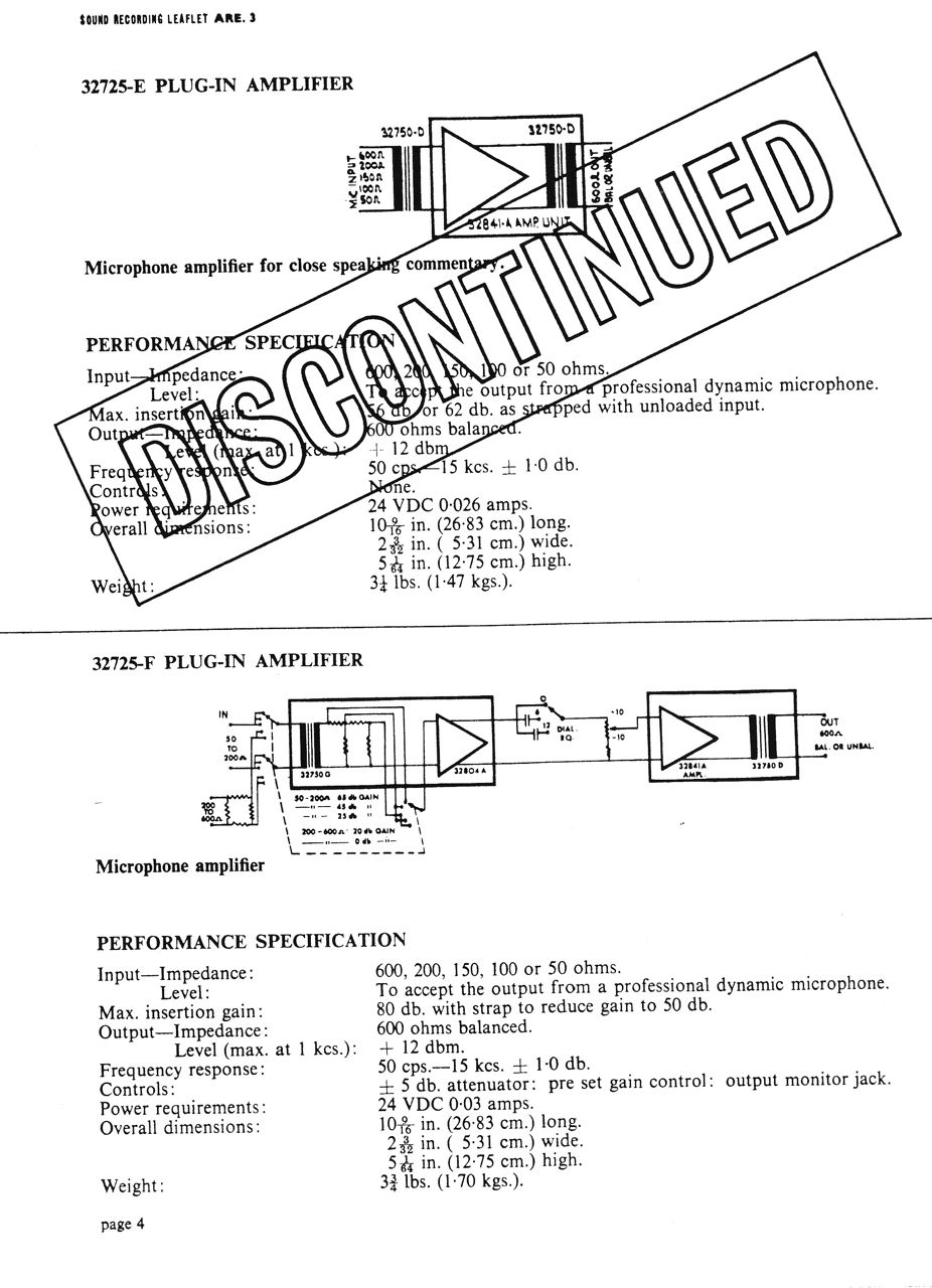

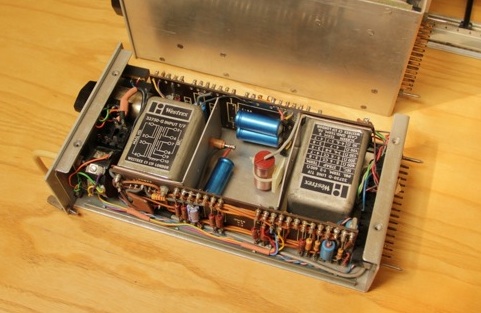

Some of the preamp modules was
Westrex 32725 plug-in amplifiers
with wery good input and output signal balanced/SE transformers, and Bridged 600ohm, 11step/1db, T attenautor.

One more info about this amp, only output stage with transformer, has +17.5db cca gain (mesured with load).

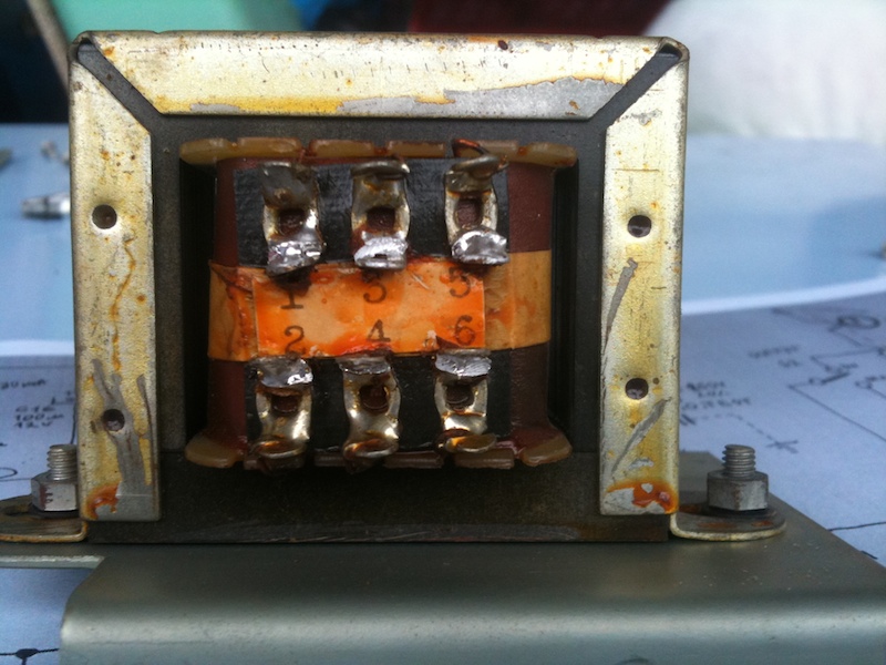

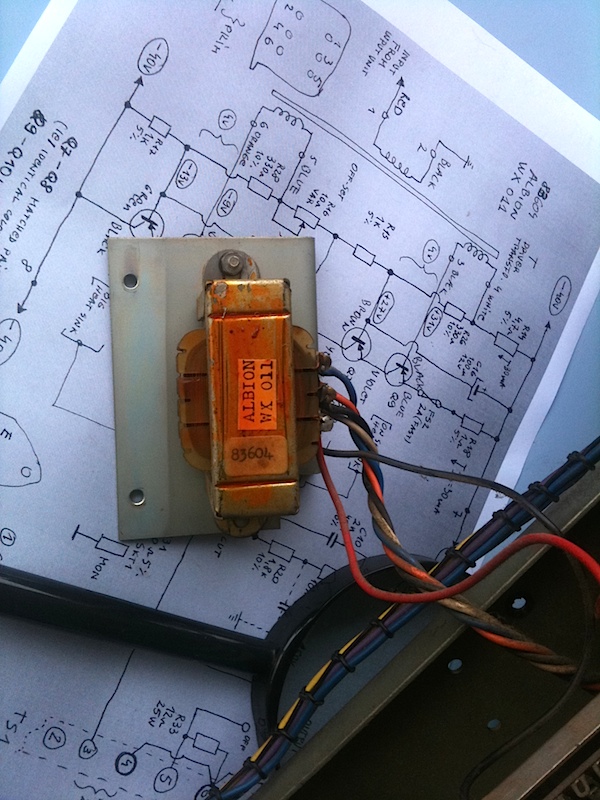

I found some photos of Interstage/phase splitter transformer. Also from Albion Transformers.
I measured (with simple RLC meter):
ALL COILS 1-2, 3-4, 5-6
2.1 ohm cca.
23-27 mHy cca.
Very low resistance of coil wires, slightly bigger wire, unfortunatly leads to also very low inductance of primary winding, but probably good coupling factor (I didnt measure) and lower capacitance?
Maybe is some air gap, I cant see.

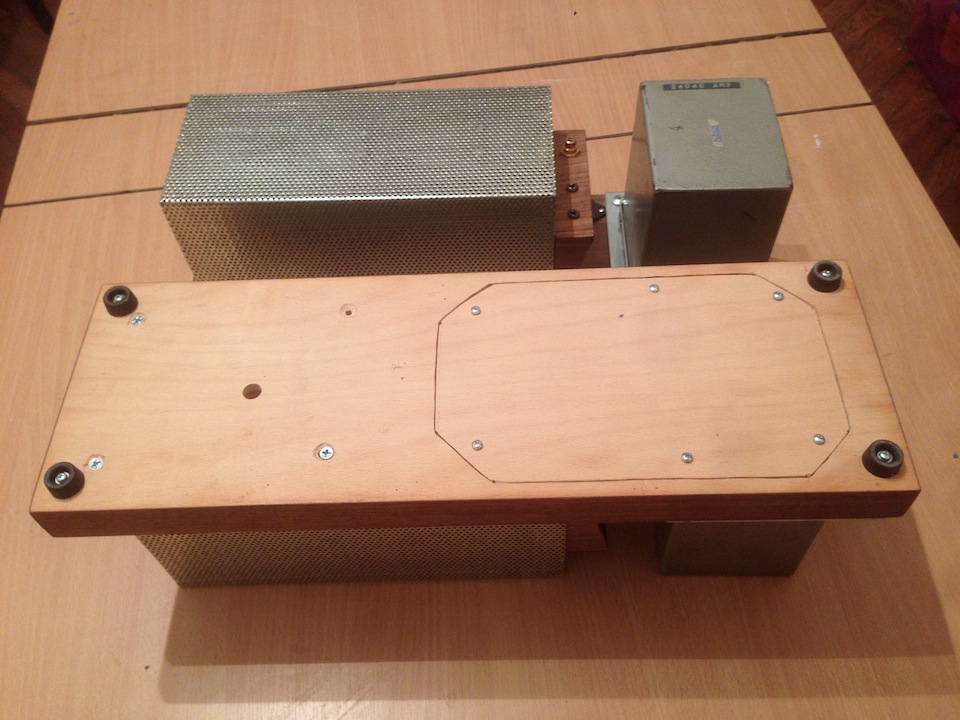

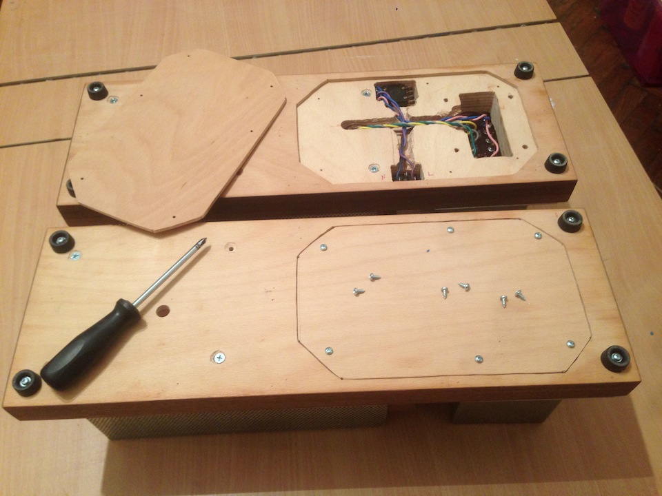

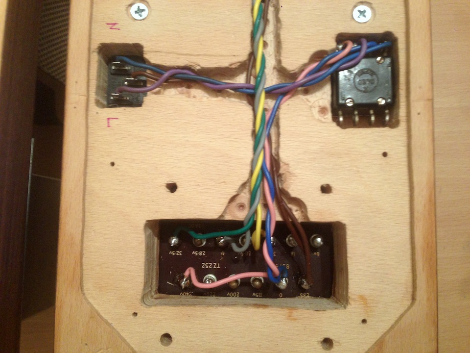

Veery kewl idea with the wiring beneath that sheet of plywood 😀!
Best regards!
If You point to safety it is safer than usual line power wiring. By the standards wires have to be min. 6mm from metal chasses. It is not the case in contemporary equipment. These wires are original Westrex with excellent insulations. And they are away from ch. ground metal parts 2-3cm. 🙂
And offcourse that is absence of any heat in any of those wires. I checked with few days power on constantly...
