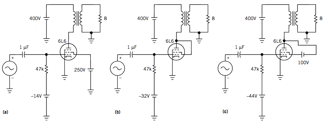

What do you think about this Schematic ?

No, it suggests running G2 a hundred volts HIGHER (more positive) than plate. (Note G1 voltage for each condition.) That will increase peak "available" cathode current (which is limited by load impedance). For any reasonable *audio* use, it will abuse the screen grid. On original 6L6 we would expect quick failure. (6L6GC is tougher.)
I do not understand the doubts. 350 is a 27 Watt Pdiss tube. A good pentode in SE can make "undistorted" output about 0.4 times Pdiss. Or 10 Watts. At high THD and high impedance (poor damping). You can reduce THD and impedance with NFB. Ultralinear is one way. But that's not much NFB. The classic design is a high gain stage before the power stage and NFB overall.
