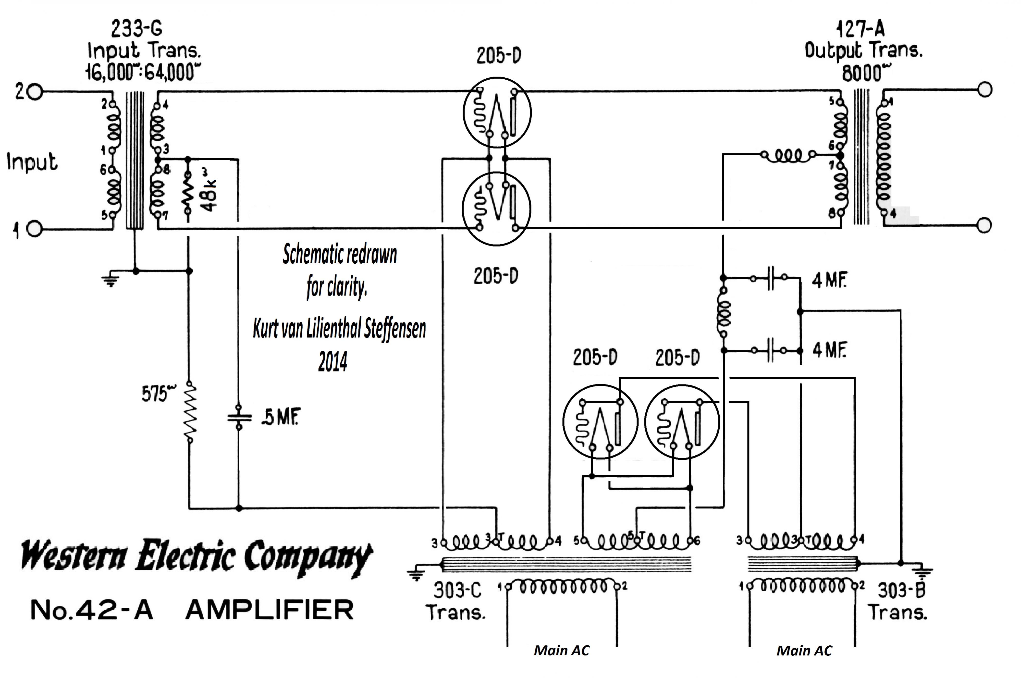

Anyhow, can anyone give me any background on how these are used in the audio world?
Looking at the datasheet on page 8 here:
http://www.6v6.co.uk/vcomp/manuals/pdfs/Western Electric Tube Manual 1933.pdf
It appears to be useful as either a driver, or as an output tube for low power output (1.2W).
It was used in WE Amplifiers (WE 25b, 32A and others) and anyone possessing such an amp would be interested in the tubes.
In addition, there are people who wish to build their own amplifiers with them.
These are used in "Pre" WWII Cinema Amplifier system (Amp+Speaker). Here is a schematic for the Western Electric 42A. You get more than 1W since it is used as Push-Pull and for power supply. However these 205's are so expensive and hard to replace, I wouldn't push or pull more than 2W out from them.
This won't be a normal projects. I wouldn't try unless there are special reasons and the attention plus know-how needed.

If you are going to build an amp with a tube from the times when tubes were invented and not having a stash of it already, it needs faith and deep pockets. I would never choose such a rare tube and even when I had them available, I would sell them to fund the project and use other tubes.
There are no real bad tubes and NOS is plentyfull available.
Do you know the guy who build a first class amp with a PL82? People with their 300B amps have changed to that design, when possible.
This one is so cheap, probably can buy hundreds for one 205D.
There are so many other things that make an amp sound good or bad, most often the tubes aren't to blame.
