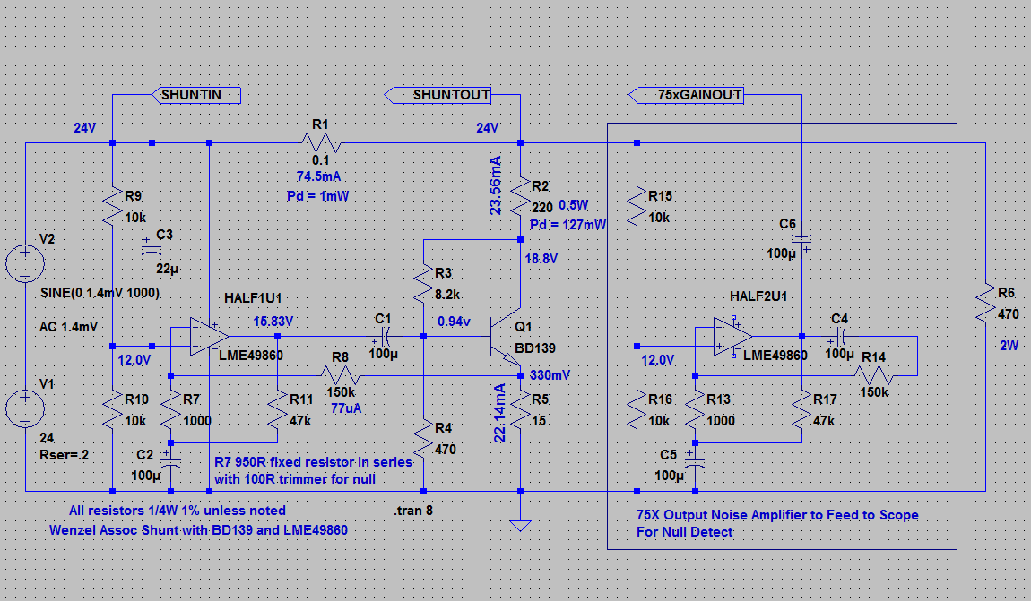

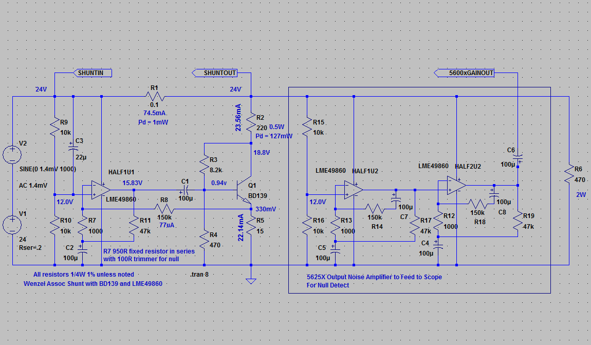

For that one it is the AC noise cancellation voltage dropped across the 15R series resistor that is balanced vs. the incoming ac-coupled noise signal across the emitter resistor of the single transistor inverter, which in turn becomes the shunt current, then creates that equal-but-opposite cancellation voltage in the shunt resistor. So it is that 8.2R emitter resistor you would need to trim, as he notes, not the base voltage.
Same thing applies that I wrote above. You can whip up an ac amplifier to increase the remaining noise signal after the shunt, then feed that to a dmm or software scope to adjust the null. Since your meter's resolution is 1mV you could cascade two of those stages (use both halves of the LM833) for a total gain of 75x75= 5600. A 50uV noise signal would show up as 280mV. Just in this case it would be the emitter resistor you are adjusting. Maybe replace the 8.2R resistor with a 10R fixed that is in parallel with the combo of a 27R fixed in series with your 50R trimmer or a 100R trimmer. That would give you an emitter resistor range of about 7.3R to 9.3R.

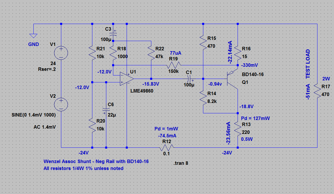

negative version of the shunt
Hi Agdr and other diyers ,
I hope you have some time to post a schematic for the neg PS version of the wenzel shunt with op amp or the single transistor version .This is for a pre amp
I have built 2 of the shunt wiht the schematic provided by you.
I noted that replacing the 100 UF with a 220 Uf at the output of the op amp is positive.

Here you go. 🙂
Sounds like you are getting some good results! The negative rail circuit is just the mirror of the positive rail Wenzel around ground, with the NPN replaced with a BD140-16 PNP, the electrolytic cap polarities switch, and the op amp supplies connected as shown. A LM833 would be fine for the op amp, of course, I just had the 49860 diagram handy. I've used both on the breadboard. If you want to try the TO-92+heatsink route the PNP transistor would be a 2N4403.
I also noticed a typo in the null test amp schematic I posted before if using a resistor+pot for R7 and trying to maximize the null. The output should be taken directly from the op amp output, not on the other side of C4. Here is a corrected schematic, and a schematic of a two stage test amp. Again the amps will add a lot of their own noise to the test measurement output, but all you are looking for here is a null so it shouldn't matter.
