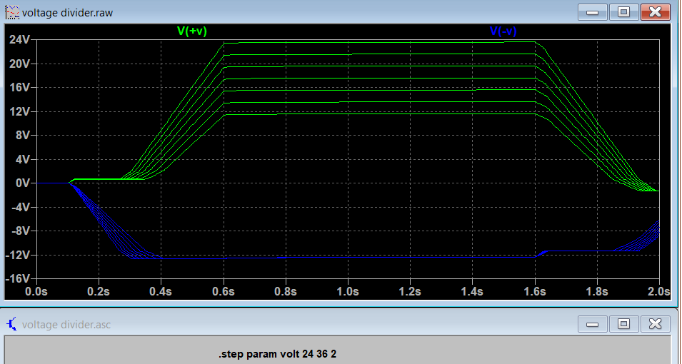

The lower centre rail volts is set via a zener through a transistor so cant go above 12 volts.
Out of curiosity, what regulates the upper (RAW+12v) with respect to the GND?
I ran a quick sim impulse from 24v to 36v in, and the RAW-12v is clamped WRT GND by the zener, but the upper rail seems to follow the input voltage.

The input voltage is a regulated 24 volts from a wall wart.
The zener and transistors ensure the middle voltage is always around 12 volts.
The circuit works as I have sold numerous pcb's with that power supply circuit.
The circuit is similar to an amplifier class B output stage.
I get its unusual but it works.
It doesnt matter if one rail comes up first the -ve volts is just a op amp supply.
Its the top voltage which is important as it has a microcontroller on it as well as op amps.
Looking at your eye soring schematics you should be more careful calling your customers idiots. There is a good chance of overvoltage spikes due to possible imbalance of the 47uF caps - and this is NOT clamped by the zener at the common base.
Of course its clamped. The zener and bottom transistor have a diode and zener like circuit.

Nigel, perhaps you are being a bit defensive as there may be a problem with your circuit because the top part is not regulated. You unwisely depend on a wall-wart SMPS never offering an unregulated voltage spike upon power up. When such a spike occurs it will only appear on your top supply and the overvoltage would kill the 3v3 reg as your Customer observed.
