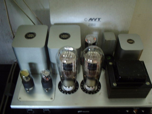

hi,
one of my private use we300b also use this JE lab circuit.
only one resisters I change is the 3.3K 5W. I change to 27K 5W.
because if use 3.3K the voltage for 6sn7 is too high.
only the GTY grade 6sn7 can use. But i like the VT231.
So low down the voiltage.
pls see my amp.
thanks
Thomas
