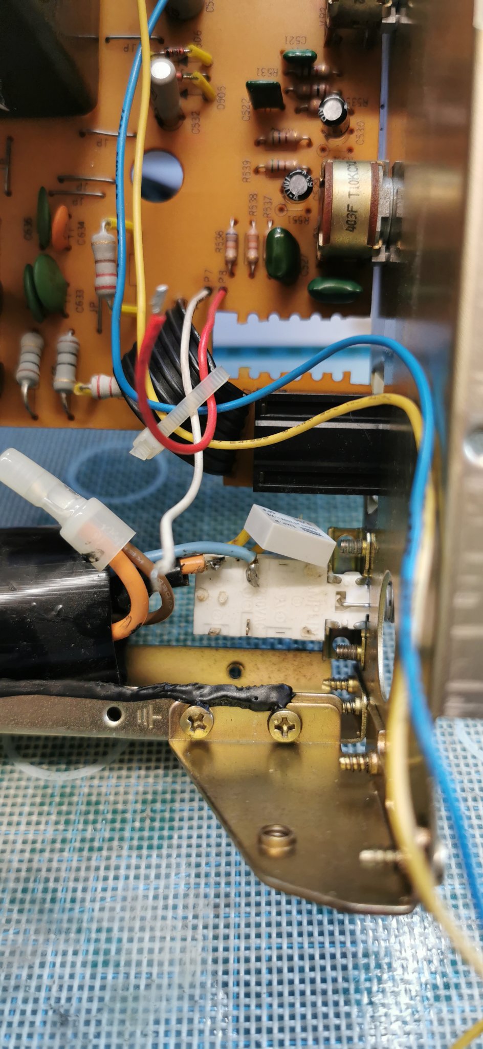

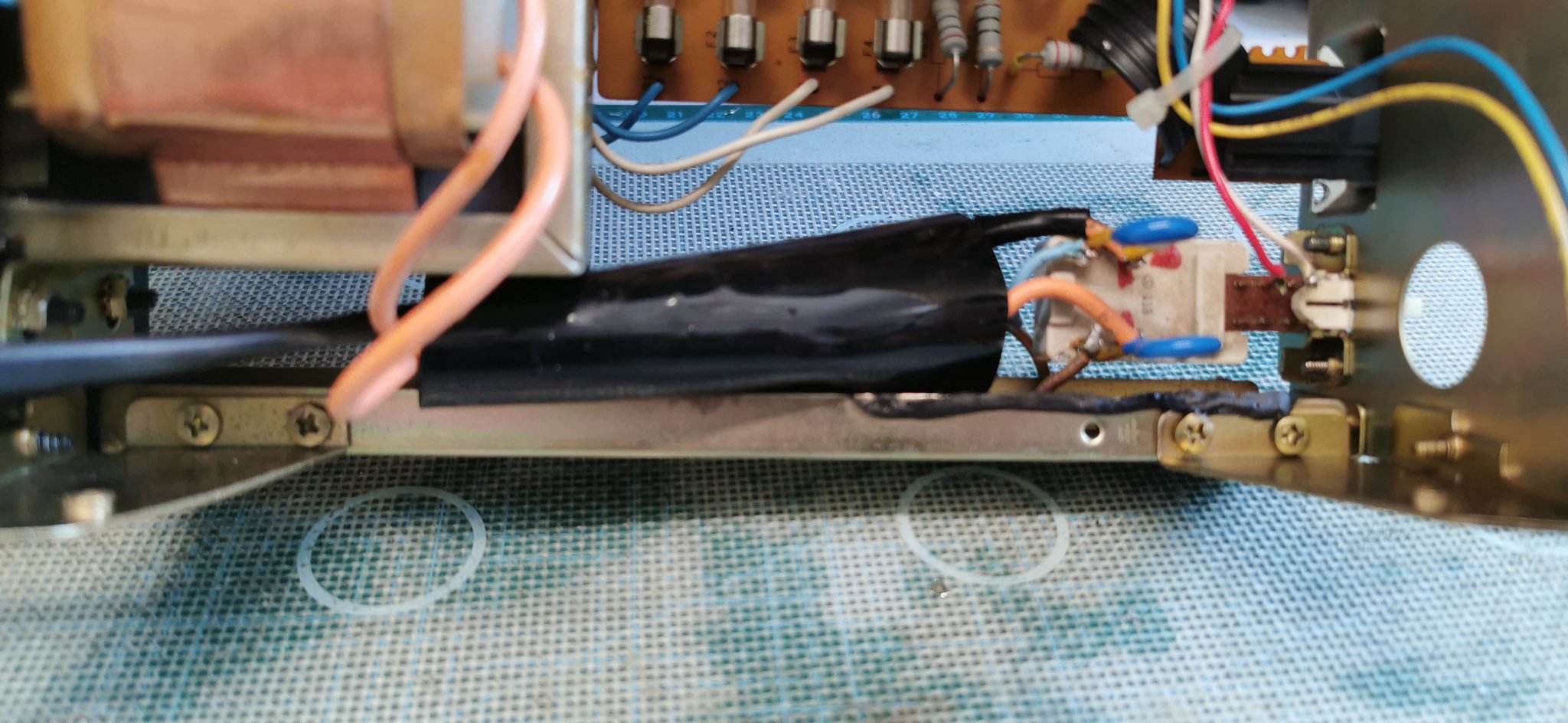

poundy Member Joined 2021 Paid Member 2024-05-19 2:29 pm #1 2024-05-19 2:29 pm #1 So I'm repairing nad 3020B (yes unusual I know 😉) but when I took the lid off someone has replaced the switch. But in doing so, permanently shorted out out the live feed, disconnected the FET muting and switched the neutral Attachments IMG_20240519_142523.jpg 293.1 KB · Views: 104 JonSnell Electronic Member Joined 2012 jonsnell.co.uk 2024-05-19 2:48 pm #2 2024-05-19 2:48 pm #2 Nice old school amplifiers. Have fun with the biasing 👍 poundy Member Joined 2021 Paid Member 2024-05-19 3:14 pm #3 2024-05-19 3:14 pm #3 Don't find these to bad for the most part. Get the odd difficult old bird. Replaced the switch with new caps Attachments IMG_20240519_151318.jpg 273.9 KB · Views: 50 You must log in or register to reply here. Share: Facebook X (Twitter) LinkedIn Reddit Pinterest Tumblr WhatsApp Email Link
