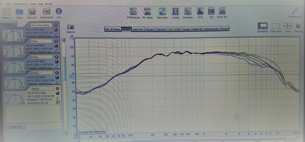

To me 'well damped' mean free of breakups. I worked with few drivers which came pretty close to be called well damped.
Here is example of two mids, but woofers and tweeters apply as well.
Vifa 13wh-00-08 is one, peerless tpy05w08 is other.
  • 264-1636--tymphany-tpy05w08o0088-spec-sheet.pdf
