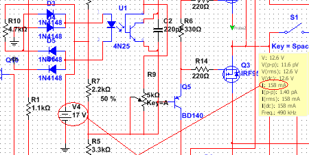

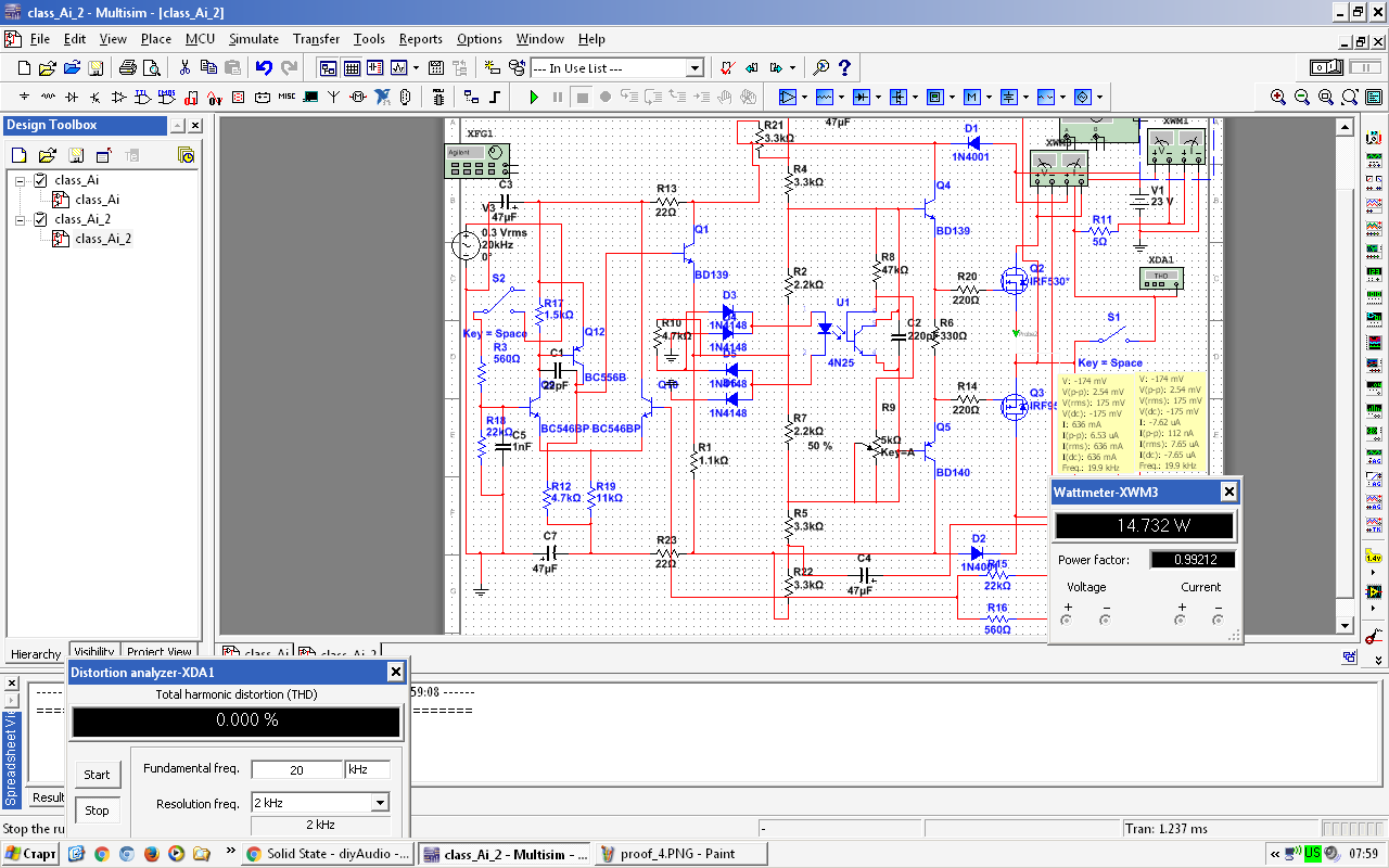

I am proud to present you the new class ABimproved. 😀
It works this way -> 0 volts class A standby current, some voltage -> less standby current.
This is a very good hybrid between class A and AB, actually this is real class AB. Normal class AB is just class B with more standby current.
Conclusion => hybrid between A and B (new classes: class A, class AB, class Bi, class B)

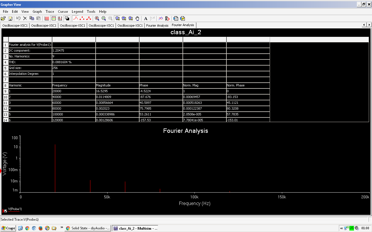

FFT is @ 20khz.

propogation delay ....
Consider a slow opto (like the 4n35).
100's of uS propagation delay will be there.
I know the model shows good performance , but it lies.
This method has been tried , OEM's and forum god's 😀 .... have gone the
non-optical way for class AB2 (what is is typically referred to as).

Do opto couplers have to have that much propagation delay? In optical telecom world they are very fast. An LED ( actually laser diode ) and a phototransistor or photodiode can be made to handle 50GB/s trunk lines. Light propagation is 11ns per foot and couplers are separated by mm.
That one does..... (4n25/35)
I'm sure there are better ones
OS.
Shame about the class ABi dream. There are plenty more biasing schemes to experiment with and prove to yourself that there is nothing new to find - just better or cheaper ways to apply the existing bias control systems - and there are many and various ones to play with.

when i think now i realize that there is no need of autobias.
the bias current is high only at crossover region.
its good only if you boost it for high frequencies. 😛 😉
