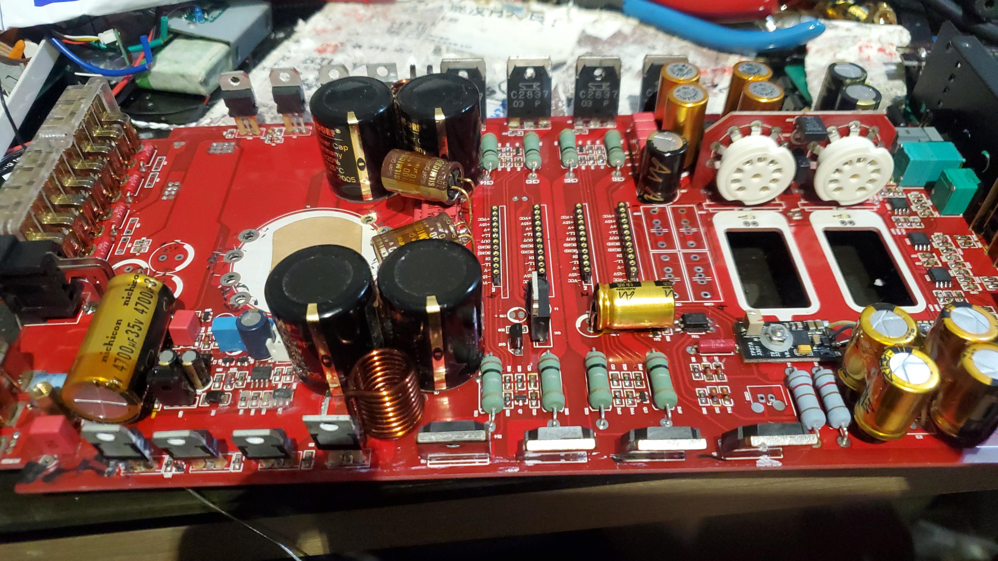

i had mod 3 totally same car amplifier for friends. All of them are working normal with those inverter circuit provide +-25v rail voltages. Now my final mod item for myself which generates +-40v. Those capacitors max voltage are 35v. I really fightened coz my main caps are using mundorf 40v those are too expensive for gambling.
Should I replace the inverter coil to decrease voltage?

I see YihCon capacitors there, can´t read voltage and capacitance.
Picture mentions 40V Mundorf caps, you mention 40V supplies, but your OP talks about 35V caps??????

I looked all over the place on the first picture for the SMPS controller IC, couldn´t find (or recognize) it but of course it had to be *somewhere*.
Guess I found it in the second picture, in the small parts cluster, bottom left between the 4700x35 Nichicon and the bottom left Mundorf.

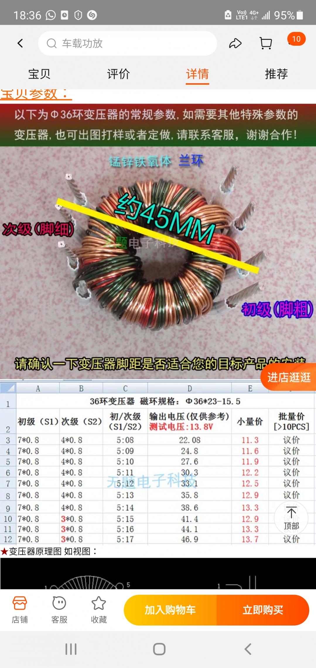

I see you removed the inverter transformer and looked at the (all Chinese 😱 ) spec sheet.
At least we share numbers and some labels 🙂 so I can guess they offer different turns ratios, based on nominal (and that´s the key word: NOMINAL, meaning it can actually vary A LOT in normal use) 13.8V
And different turns ratios give different "raw" voltages.
Problem is, NO amplifier uses such raw unregulated voltage for power.
It woud be crazy to do so, available car voltage may (and does) vary from about 11.5 V (a deeply discharged battery) up to 14.4V , with engine revving up (say on a highway) and battery already charged to the brim, because raw secondary voltage would vary by the same proportion, we are talking 25%.
So nominal 25V rails could actually vary between 26V and 20.8V
So SMPS designers use a controller IC (here TL494 which is a classic) which first boosts battery voltage *beyond* what you need, so even with the weakest battery you still get more than needed, and then regulate it down.
From your datasheet, transformer #4 (5:9 ratio) would give you raw 25V ; BUT those 25V rails will be subject to all the wild variations I mention above, so designer will choose one which gives at least 25V rails with 11.5V car voltage, it would be transformer #6 (5:11 ratio) which on "normal" 13.8V would give you 30V rails and under certain conditions up to 31.3V
But designers typically aim higher, to guarantee output voltage is always regulated, personally I would choose the next higher transformer: #7 (5:12) , nominal 33.1V rails, which*might* sometimes reach 35V rails.
If you measured 40V rails, then he probably chose #9 (5:12 , nominal 38.6V rails).

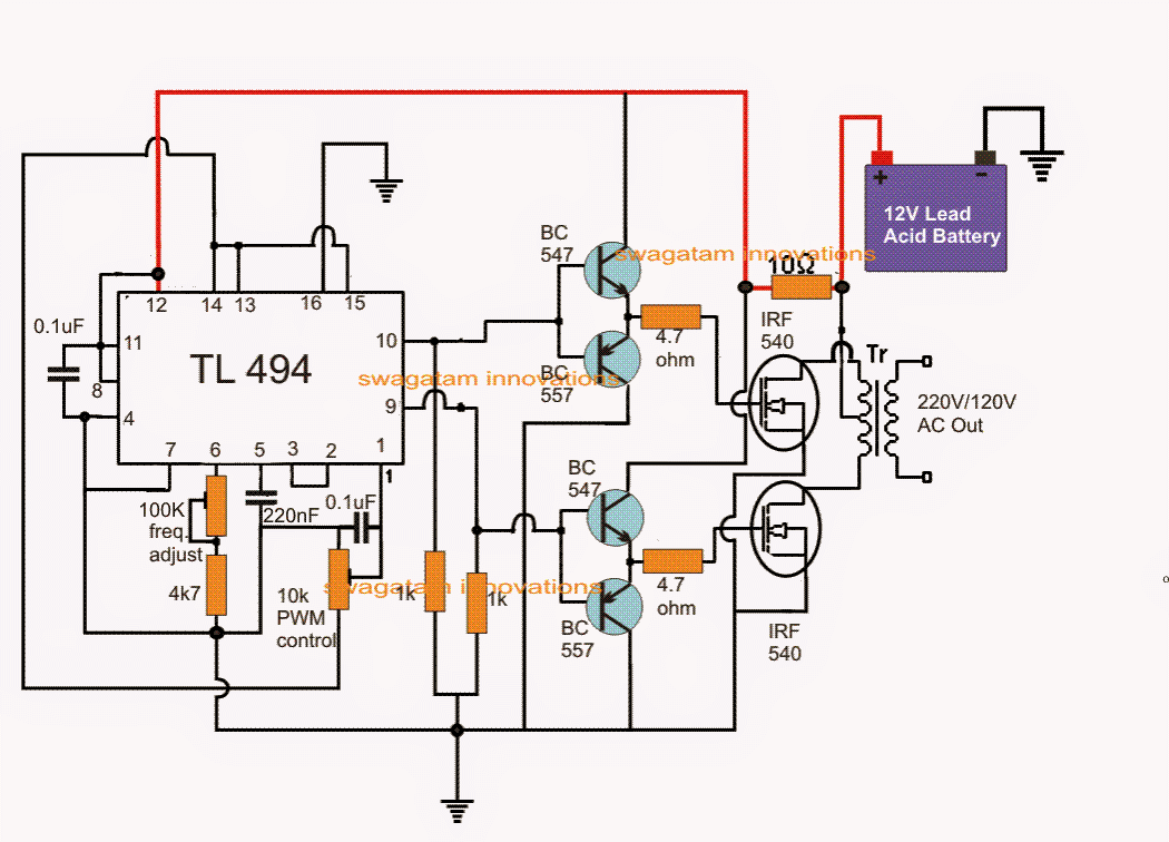

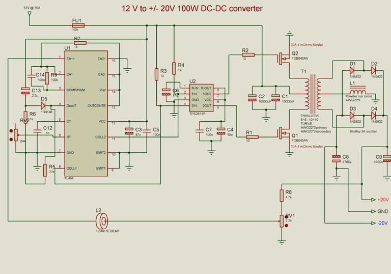

EDIT: the circuit you show is a crude unregulated "12V battery to 220VAC inverter" to power, say, an electric shaver while camping, a proper "amplifier use" supply is like this:
If image does not open: http://www.high-voltage-lab.com/projects/49/bigs/smps.gif
Notice:
1) transformer ratio is "higher than needed", 5:10 so nominal voltage will be 13.8V * 2= 27.6V (real world around 26 or 26.5V because of losses) and yet desired rail voltage is +/-20V !!!!!
2) BUT TL494 has a voltage sensing (and regulating) pin, notice they sample +20V rail through R8 and RV1 and feed it back to TL494 pin 1 son it down regulates "excessive" raw voltage to actually needed one.
Your amp certainly must have same or very similar circuit, which is now malfunctioning.
Replacing transformer is NOT the solution.
I see you want to tame that too high voltage by using a lower turns ratio transformer, but that´s not the correct path.
Notice:

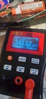

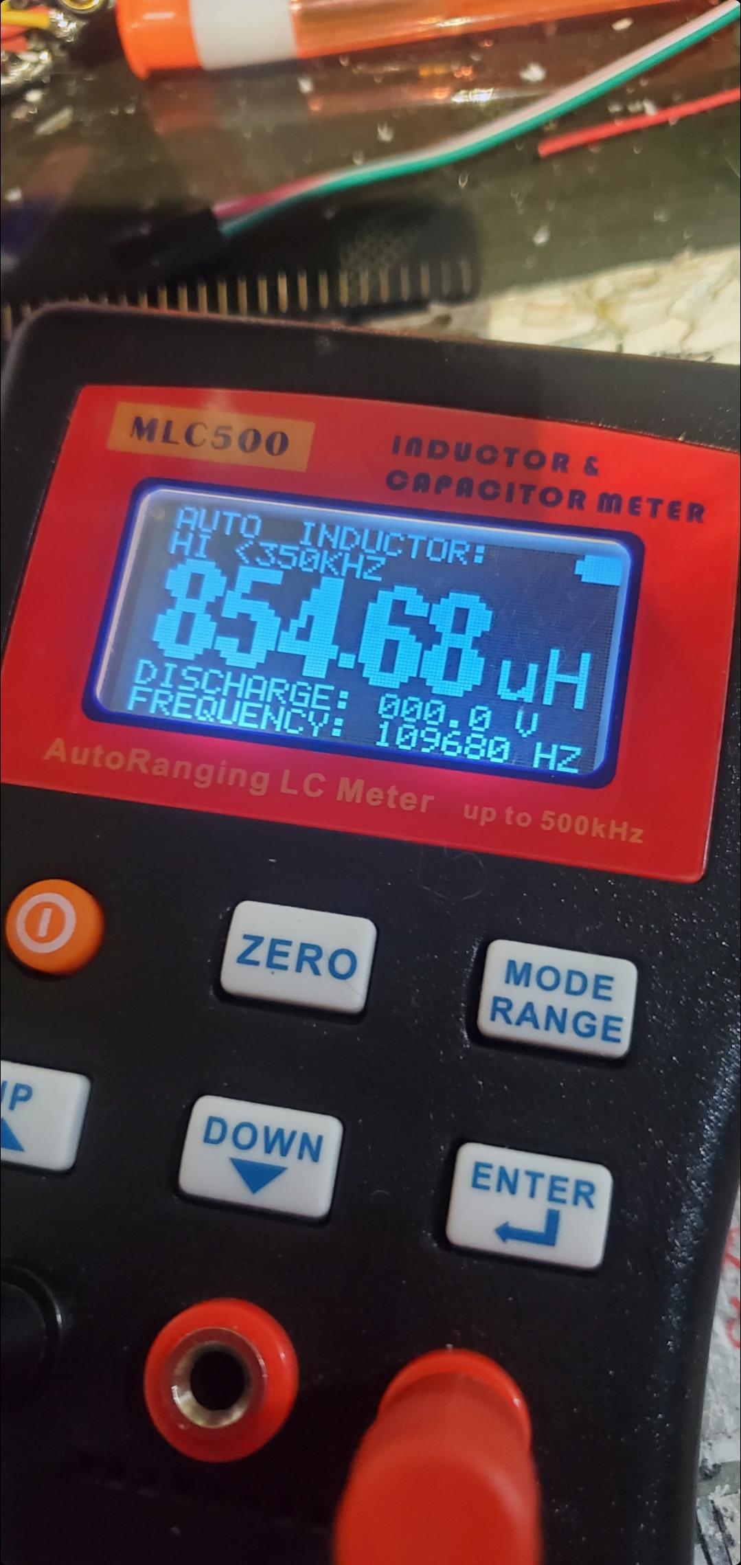

on the other hand, i have a coil/cap meter. when the new coil on hand i can measure the different.
And or i can also remove coil from one of the normal amplifier to test.
