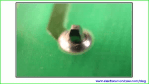

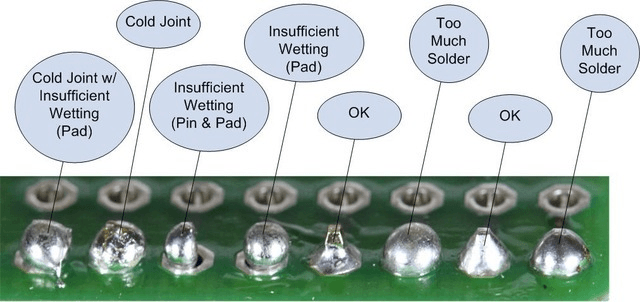

Over it sounds like one leg of the balanced input is dead.
As mentioned it could be a simple issue of the normally contacts in the mini mic input jack.
Do the mentioned phantom power check at the input jack, check between pin 1 and 2 and between pin 1 and 3.
That said you mentioned that a dynamic mic show the level issue as well, phantom power is not an issue there.
Try a another audio source to use as a test source and with a break out adapter cable or just a couple bare ends
of wire, ground/ shield plugged into pin 1 and the + audio plugged into pin 2 see if you get and audio and then try pin 3, if you get audio on only one pin or the other that is the issue, maybe the mini mic input jack contacts, possibly
a bad solder connection where the XLR connects to board or a micro mini surface mount component.
You could make up a break out cable for like a phone headphone jack and use just the shield and either the left or right audio.
MAKE SURE THE PHANTOM POWER IS TURNED OFF FOR THAT TEST.
