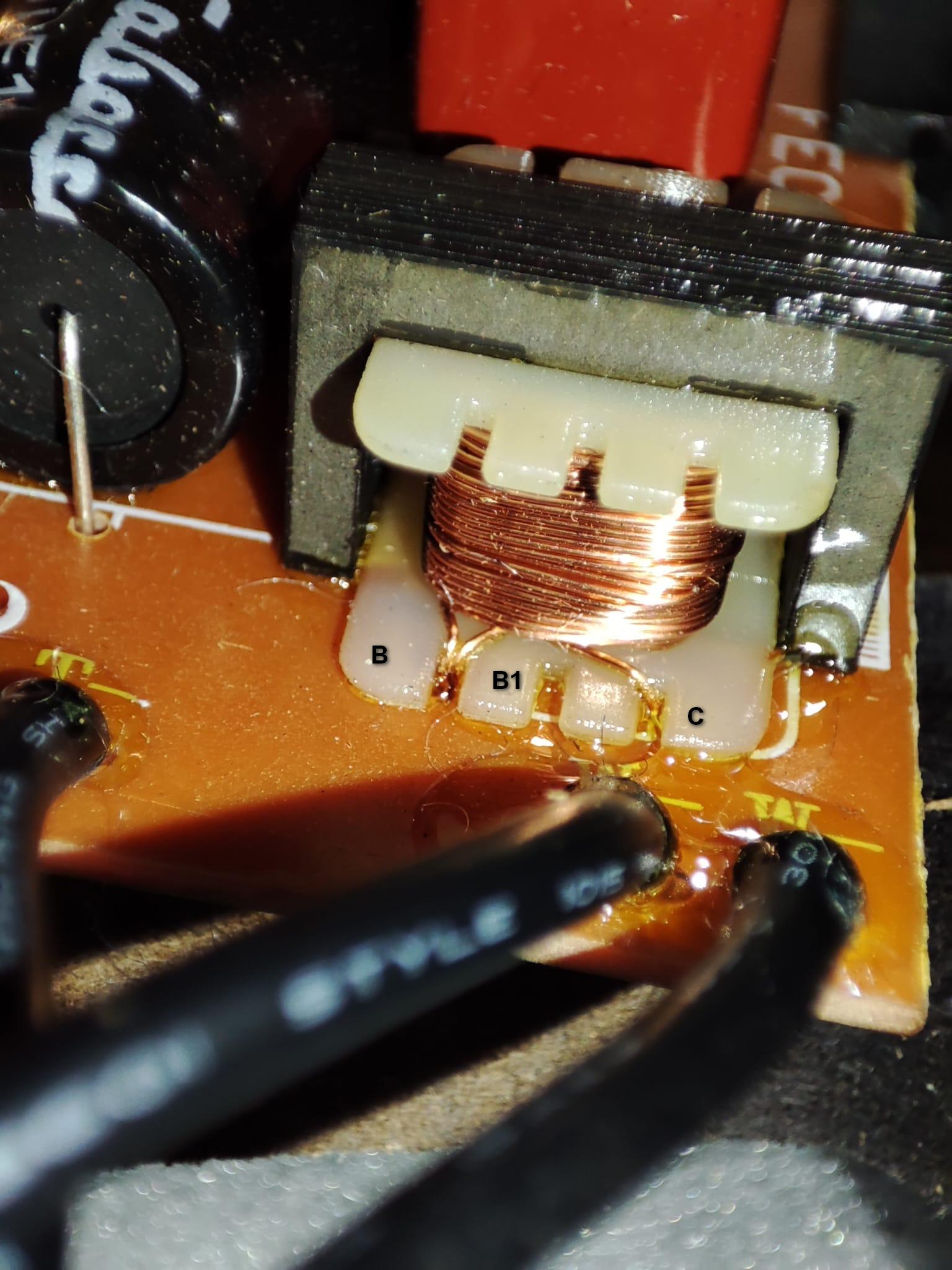

I'm in the process of replacing the crossover parts of my Cabasse MT 3 Jersey speakers with better ones (hopefully).
The cap replacement way easy, so I bought a LCR meter to measure the coils and now I'm stucked and need your help.
The coil for the tweeter circuit has 2 sets of wire strands and are marked in the pictures bellow as A, B, B1 and C. On the PCB, B and B1 are soldered together and marked as B.
On the continuity test, A-B is the first strand and B1-C is the second one. When measured, A-B shows 0,000 (not null), B1-C is 0,211mH and A-C is 0,580mH (B and B1 connected).
The DCRs are:
A-B - 0.6 ohm
B1-C - 0.7 ohm
B-C - 0.9 ohm (B and B1 connected)
A-C - 1.2 ohm (B and B1 connected)
The wire(s) used for this coil are 0.25mm in diametre.
What values (mH, ohm) shoud I take into considerations when searching for the replacement coil(aircore)?
What's the purpose of a 2 wire strands(3 ends) coil in this crossover?
Thank you very much!

I might have assumed the A-B inductance to be maybe 140uH. However the resistance measuerements don't add up. B ought to equal B1.
Have you nulled your leads? (Short them and subtract this)
Are the two windings the same gauge?
A-B inductance is zero (0.000) on my LCR meter not Ø, as it tries to measure it but it settles on 0.000. A-B resistance is 0.6 (sometimes 0.5) ohm.
B-B1is null/Ø - cannot be measured because they are 2 diferent wires.
B1-C is 211mH and 0.7(sometimes 0.8) ohm.
B-C (B and B1connected/shorted) is also 211mH but 0.9(sometimes 0.8) ohm.
A-C (without B and B1 connected/shorted) is null (Ø), cannot be measured because they are 2 diferent wires.
A-C (B and B1 connected/shorted) is 0.580mH and 1.2 ohm (sometimes 1.1)
The two windings are the same gauge.

The inductor is part of a third order crossover network. The tappings B and B1 adjust the sensitivity to suit the tweeter . The crossover network for the bass/midrange speakers is a second order network.
Ok, so how do I treat this coil with 3 ends (B and B1 are soldered together on B point on the back of the PCB, so it ends up being A-B-C) if I inted to replace it a "standard" 2 ends coil? Between A and B I get no reading (actualy is 0.000 not null), regardles of B and B1 wire ends soldered together or not, B1(or B soldered to B1) to C is 0.211 mH and A to C is 0.580mH.
Do I measure on point A and C to find out its inductance, or B to C and then A to C and sum their values?
Managed to measure the coil on the woofer circuit, it's 0.770mH and 0.3 ohm, and it only has 2 ends. 🙂
The inductance reading measured from A and C, with B and B1 joined together, is the reading that matters (0.580mH). If you convert your crossover to use an air cored inductor you will need to consider adding an "L" pad to the tweeter circuit.
It is better to ask questions to avoid mistakes. The iron core inductor is in reality an auto-transformer. If the tapping point (B and B1) was set at 50% of the coil winding turns, then only approx. half of the signal voltage would be sent to the tweeter. This is a neat method of matching the sensitivity of the speakers.
If you replace the inductor with an air wound type, you will need to link B to A on the PCB.
Things are starting to make sense now. The weird thing is that I get 0.000 mH reading on A to B, but the resistance is 0.6 ohm, and 0.211 mH on B(or B1) to C.
Would it be ok to replace the original coil with 2 coils, one connected to A and B(580mH - 211mH) and the second one connected to B-C(211mH) or would I run into other problems?
If VaNarn is correct when saying it is an autotransformer, it would be a different situation. Autotransformers usually require a larger base inductance and not likely air core candidates. It's interesting that we had one similar to this only a week or two ago, I wish I could find it.
