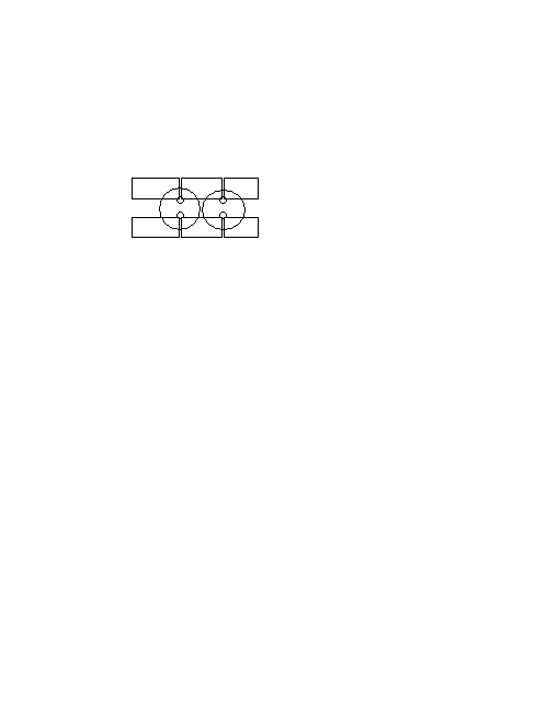

I think what Roger means is a cut through the thick tracks on the center line of the Capacitors. This is so that the capacitor charging current from the bridge have to go to the pin of the capacitor and cannot be drawn past it to the regulator. This seperates the track into the capacitor from the rectifier and an output from the capacitor to the regulator.
Please see very bad paint drawing JPG.
Roger my appolagies if this is not what you meant.

Andrew,
This is more what I had in mind, Forgive the poor drawing program. The Idea is to separate the I/O as completely as possible. Doing it this way gives 2 levels of isolation. Actually if the traces were a bit smaller you would get some R/C filtering due to the trace resistance. This can be effective because the peak charging currents will be many times higher than average. In fact, if you have extra voltage to work with, small value resistors (1-10 ohms) can really help reduce ripple noise. These would be placed between the 2 caps on both sides.
Even the best circuits can be contaminated. This is easy to forget when working with quality parts. You still have to do your homework if you want the best performance.

I think there is a trade off here because in your design as you say you get a two level filter, however the charging currents share the central peice of copper with the signal currents drawn from the cap further away from the regulator.
Where as my design does not have the two level filter but the charging and signal currents do not share any copper.
I don't know which one would work better. Roger have you tried a design like this ? Do you know that it works well? If so its probably best to use Rogers solution.
They will both work its just a case of which one is best.

Andrew,
Exactly right, depends on which parameter is most important in this application. All engineering is determining which compromises to use. In this application low impedance may be more important. I overlooked that this was to supply power amps. Your way would be better, thanks for keeping me honest.
The output cap and resistor question still bother me. I have never seen a chip regulator as solid (low impedance) or as quiet as a good cap. After this unit is built a simple bench test with a load and test signal would settle the issue.
I am glad to see this interest in power supplies. I do more work on power supplies than the actual audio circuits in striving for good sound. Changing things in the circuits may or may not help but a more solid and quieter supply always helps. A simple active load with a power transistor, resistor and input signal can be a real eye opener as to supply quality. The problem with most audio circuits is noise and dynamic compression of the signal. This can be due to nonlinearities or voltage sag due to the wide ratio of peak to average in music. Not that much of a problem for low level circuits as they mostly run in class A but a big problem for power amps.
For power amps to have the best sound the supply must be able to supply these peaks without significant voltage drop. What is significant? I haven’t reached the point where it isn’t significant. No matter how good the amp is at power supply rejection or how good the supply already is, improvements can be easily heard.

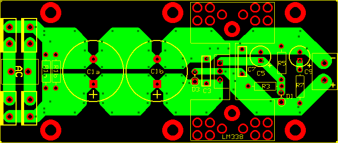

Noise strangler - Roger's version
Andrew and Roger,
thanks very much for your precious advice. I really happy and proud about this thread!
Between one back pain attack and the other
, I sketched a new pcb version trying to implement Roger's approach.
Another version following Andrew's approach (better suited for my switching power amp?) will follow soon. How soon depends on the hands of my therapist...

Roger,
thanks for your answer. In the past I read many papers about grounding, but I didn't found found very much (searched not enough?) about linear regulators. Please note that I just spent two hours searching the Net, Analog Dialogue and the National site, but I couldn't find anything new. If you have some more precise reference, please let me know.
From my known sources, I know that (I'll use the component names of my pcb):
R3 must be very close to regulator
R5 ground point must be very close to load
R5 ground point must be more "noise free" as possible.
Possible changes in PCB are:
1. Connect C7, R5, C5, C9 (maybe C3?) thru separate (tiny) traces to a common ground point near the load (like in Welborne labs PS1);
2. "Strangle the ground trace" on C9 to make it the common ground point, even if the various currents to C9 share the same trace; leave the rest unchanged
3. Like in 2., but connect R7 and C5 to ground AFTER C9 (on the load side).
I suppose (hope) it doesn't matter if a large low-ESR cap (like you suggested) or a small cap with resistor (Carlos way) is used. Maybe with a large cap the star grounding issue is more critical.
