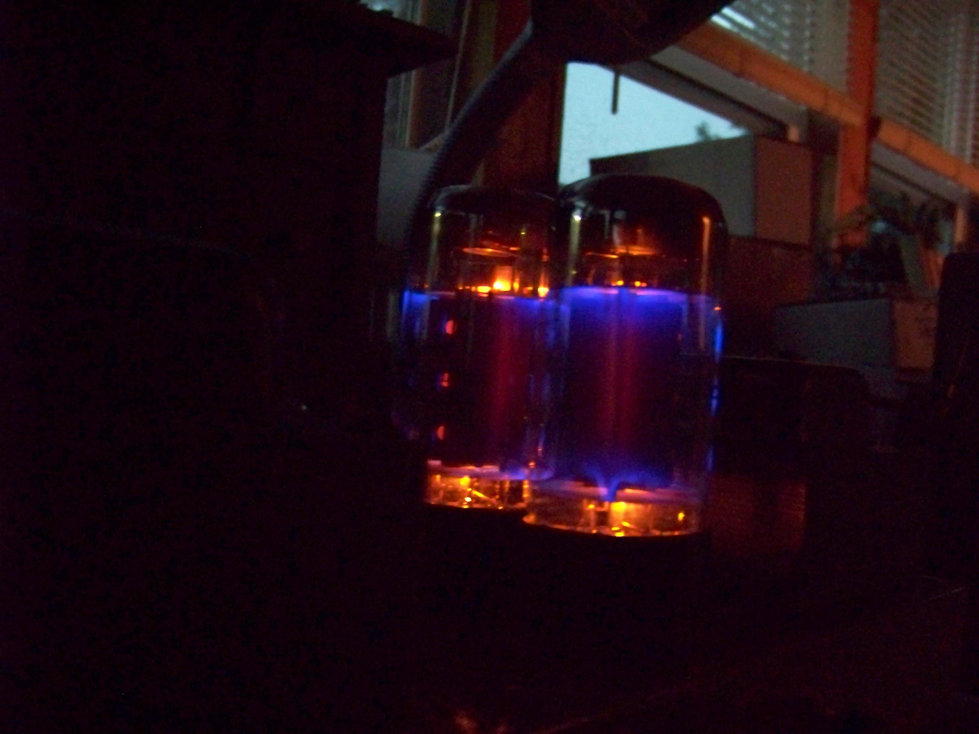

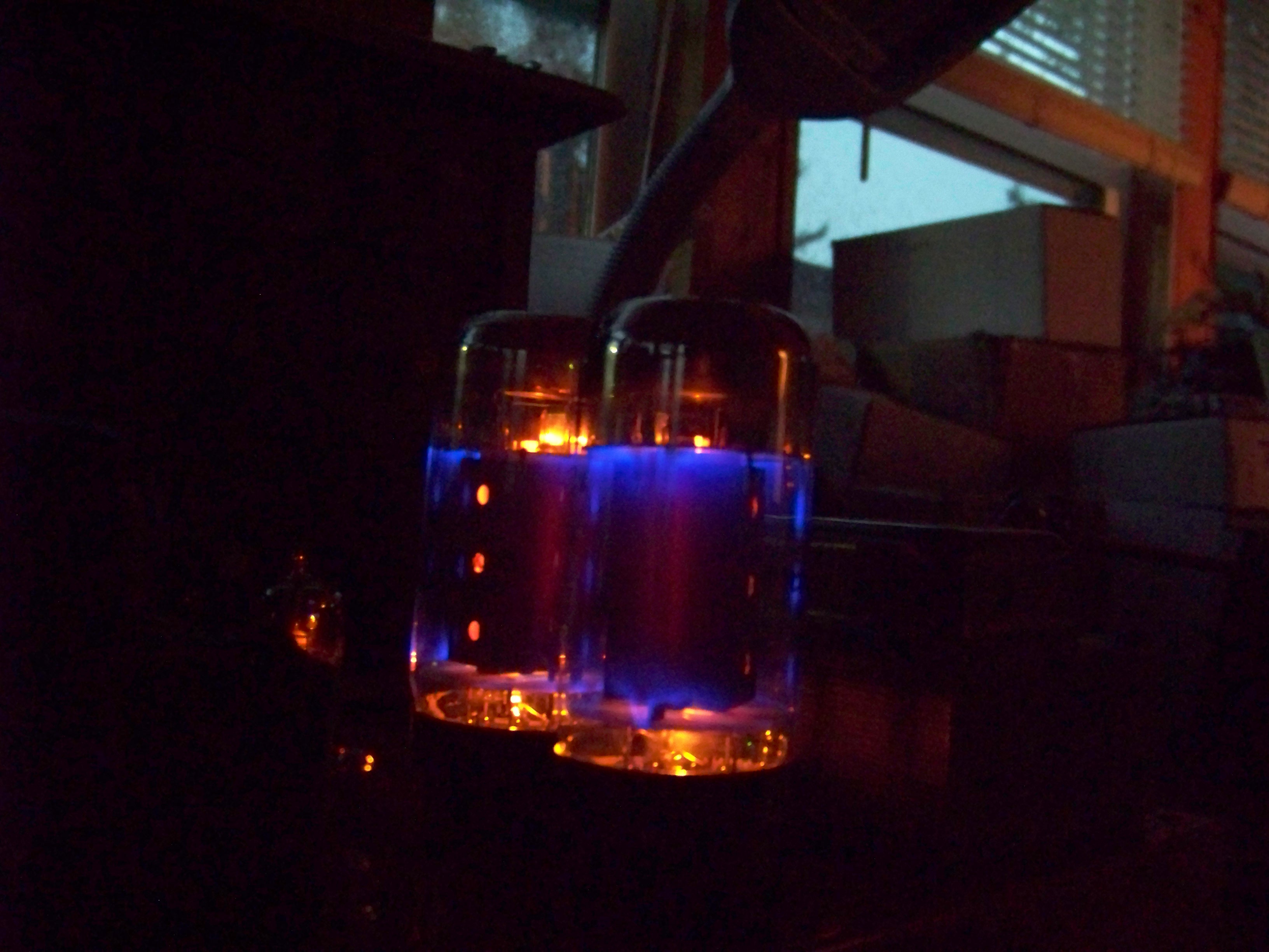

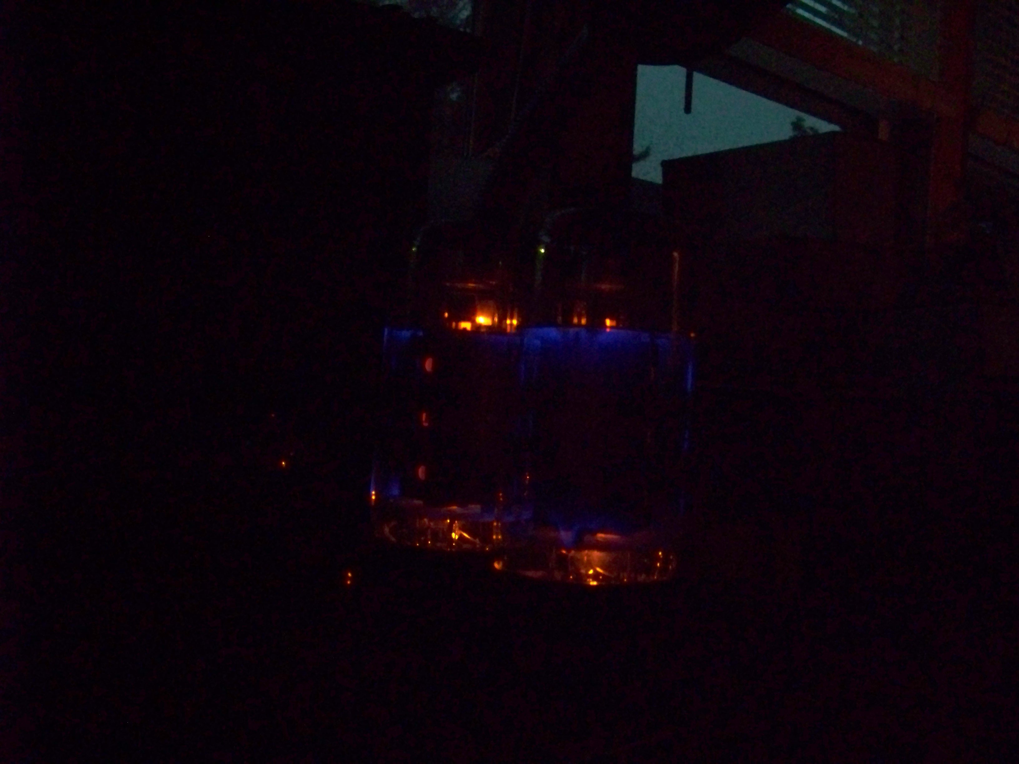

Here are some pictures,
First one is in cathode bias mode as I spoke about above.
The others are in fixed bias mode with 45mA and 430v on the plates. Do these colors seem off? The plates are a little red but I'm not sure that's okay or not.
They are Electro Harmonix 6L6EH and seem okay given the tube data sheet for these: http://www.dougstubes.com/6l6-electro-harmonix.pdf
You have a 250 ohm cathode resistor with 35v across it. Ohm's Law tells me you then have 140ma flowing through it. That is 70ma per tube.
SO I do not find it surprising your plates are getting red.

Thanks, but the plates are not red in cathode bias mode. The way I measured it was the red probe on B+ and the black probe on pin #3. The tubes were in when I measured.
The redness is in fixed bias mode. According to the calculator 45mA is fine, but they are glowing a little red. There is about -30volts on the grid and the redness goes away at -36v, but I did not check the current at that point.
How did you come up with that figure of 140mA? V=IR
BTW: the pictures show more red on the plates than I see. The red is on the 'fins' of the plates and a little bit in the 'corners' where the are bent. The tubes are brand new from ebay. I'll post a schematic in a bit, I need to make some changes.
Also, the plates are not red during the day. (like now) The room was dark last night and that's when I noticed it. I have increased the current to 50mA with 417v on the plates which is at about the maximum dissipation (70%) that I am aware of.
