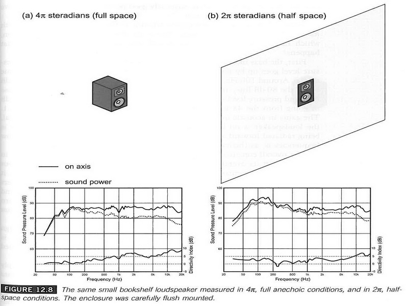

Starting with that 8" woofer at 87 db sens, depending on how narrow your cabinet face is it is likely you will want to have the response cut down somewhere between 3 and 5 db by the time you get to about 400hz. This can be done with your woofer crossover by increasing the size of the inductor.
So if you do this then your system sensativity is now going to be only about 84db. This will mean that your HiVi mid and the planer tweeter will need to be padded down to match the rather low 84db sensitivity dictated by the woofer.
This means the mid will need to cut by about 2 db and the tweeter will need to be cut by about 10db!
And this is assuming only 3 db of baffle step! it may be you will need 4 or 5 db wich means you start with an even lower system sensativity and you will need to pad the mid and tweet even more.

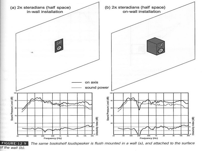

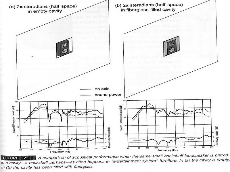

What are the chances too that your 2-way is sitting in a bookshelf or up against a wall or on a desk or some such so that the 6dB of baffle step loss is avoided?
Here are some resources that might help you out:
True Audio Speaker Topics: Spatial Loading
True Audio TechTopics: Diffraction Loss
(also on this topic, see the pics below)

Man I wish these things were stickied somewhere..... :confused:
