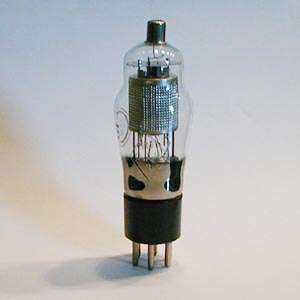

I still wonder if CCS is necessarily a bad thing. The reason i ask is that I am looking at another 300B circuit and it uses tons of CCS and I think CCS can provide additional linearity on triode, but then why not pentode too?
I wanted to cover this in more detail. When I first read it, irresistible force vs. immovable object came to mind.
A triode with a constant current source has the gain increased to about Mu, and the output Z increased from about Rp/2 to Rp.
In other words, gain is increased, and the CCS has an infinite AC resistance.
A pentode has relatively high gain and Zout about equal to its plate resistor. In other words, the AC impedance of the tube in infinite.
If you CCS load a pentode, from this rough analysis, you would expect extremely high gain and "infinite" Zout. This follows from the fact that we determined that the Zout of both the CCS and Pentode were "infinite". In other words, the circuit would be stuck at on supply rail or the other at all times and couldn't drive any real load.
agent.5, none of this sounds particularly useful to linear analog circuits.

I am not trying to continue any argument, just trying to figure out what some people are doing with their WE310A. Any comment on what this nutcase is doing with his triode strapped WE310A driver stage? I just am interested in why he is doing it so I can either eliminate it from consideration, or maybe copy it. Yes it is technically not a WE91, but I don't particularly care about that either.
http://www10.big.or.jp/~dh/work/7906.html
agent.5 said:Any comment on what this nutcase is doing with his triode strapped WE310A driver stage?
It's triode strapped, choke loaded and cap coupled. Nothing weird about that. I've seen lots of amps use triodes in this way. A triode strapped 310A is going to be fairly similar in characteristics to a 6SN7.
