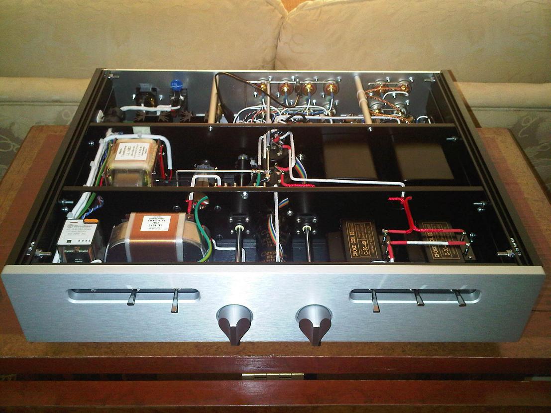

Just like to share my latest construction.
It’s a preamplifier (line level), based on the small WE417A valve (one each channel), using output transformers. The final result is shown on the attached picture (hope you enjoy it).
List of inside goodies:
- One input resistor from Shinkoh.
- Volume Pot from TKD.
- Balance Pot from Alps on its Black Beauty version (my new old stock).
- Input control from front panel through C&K switches, to relay input board.
- Input relays from Nais (TDS).
- All aluminum chassis (based on Hifi2000 parts), 20mm sides, 10mm CNC machined front.
- Stainless steel shafts for front panel knobs connection to the pots.
- 4 special polymer bearings to guide the shafts (feel is incredible).
- 2 machined connectors from shafts to pots.
- Lundahl mains transformer.
- 1 double Lundahl choque.
- 2 more choques from Hashimoto.
- 3 double Elna Cerafine 100uF/500V power supply caps.
- All power cabling Nordost single strand copper.
- 5AR4 valve rectifier.
- 2 TDO 25W resistors to lower plate voltage from 200V to 180V.
- New old stock Western Electric Valves.
- 2 Tentlabs Heater supplies.
- Hashimoto output transformers.
- Direct connection from input to 1 resistor, next to volume and balance pot, into the valve grid, and direct to Output transformers. Nothing more, just a direct connection to output connectors through the 600 ohm transformer connection.
- All signal wiring is cryo treated pure silver from Audio Consulting.
- Neutrik RCA panel connectors.
- Furutech IEC connector.
It sounds simply astonishing with these impressive Hashimotos.

You have clearly put much work into your preamp. The external presentation is very good indeed - better than many expensive commercial units. Well done, and I hope you enjoy the fruits of your work.

How about share the schematic with us? And more Pics ?

Beautiful! Galaxy Maggiorato with custom side panels? Did you do the milling yourself? Very very nice.
gorgeous! Makes me feel like I've got ten thumbs...
Thanks, its just pacience and hard work.

Muito obrigado! Many thanks, about schematics its easy, I will Draw something and post.
Many thanks also.
The milling was done locally by a specialized company. You are correct about the chassis. The back panel is made in Germany by schafner.
Kind regards
I, too, would love to see more pictures of your build. It reminds me of the insides of a Hovland preamp. Again, congrats!
Very nice. I too am a big fan of the 417A/5842. Have recommended them in transformer coupled line stages and use them in my phono stage.
