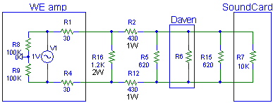

> That's something in the neighborhood of 300 volts fed into the sound blaster.
Output iron is 3:1 or 4:1 stepdown. Even if you are outputing 250V square-waves, lightly loaded, you only get 60 or 80 volts out. It is less harmful than plugging your sound-baster input to a wall-socket.
Still: You NEED a fixed output pad of -12dB. Else that 3-WATT output is going to smoke chips. AND those irreplaceable Daven faders.
I forget the rating, but the 6V6 can put 3 clean watts which in 600Ω is 43 volts. Chips running on +/-15V rails may smoke at 11V input. If the amp were low gain, maybe you would never get near 43V output; but if you are "looking for flavor" or using hotter sources and mikes than intended, you will be pushing the amp hard. You could push the amp to 43V without smoking chips if you had a 11V/43V= -12dB pad. Even when you run the tube "clean", at say +10dBm peaks, your sound card can pull-up the -2dB peaks to near nominal digital levels.
And it was quite routine to throw a -6dB pad on the output of almost everything, to force the impedances to 600Ω no matter what. The output of this amp is lower than 600Ω, which will confound gain calculations (and those Davens if not loaded); but after a -6dB 600Ω pad it will BE 600Ω near enuff. And your "600Ω" load could be 500Ω, or 300Ω if someone patches two loads at once, or who-knows-what; with the 6dB pad the amp will always see ~600Ω load.
Since you are sure you want the 500Ω vari-pad, but don't want to waste the top 6 steps (or risk turning-up too far and smoking chips), and exact 600Ω "matching" is moot, this will work:
Wow PRR! Thank you for the design work. I will certainly implement this for I seldomly intend to fry stuff. That's just a by-product of my "bull in a china shop" bench work.

Make the 1K2 resistor switched. With it, the amp sees essentially 600Ω as intended. Without it, the amp sees a higher load, which may reduce distortion and extend or even bump-up the top octave. You could go so far as to try a 250Ω 5 Watt resistor there, to make the amp "grunt", go 2nd-harmonic, and droop the treble a bit.
