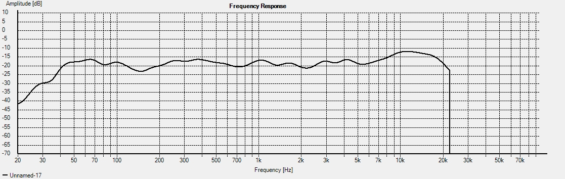

Ok... here's a curve trying to explain what I'm trying to say. Here's my version of the OB speaker inspired by NP, standard Audio Nirvana 8" crossed to a Eminence 15A at about 150 Hz.
(It's an old curve, I have since been able to remove the dip at 150 Hz by adding rear wings)
The AN driver has two resonances at 3 kHz, 4 kHz, and a large response peak at 12 kHz. All these are very audible and I've tried to address them in different ways. They can be cured to some extent, but they never go away fully.
Now, I've also measured a B&W 603 and it measures ruler flat from 100 Hz to 15 kHz. When I listen to the B&W, I can easily hear how colored the Audio Nirvanas are. But hey, I would still take them over the B&Ws. But that's just me. I don't know how my preference fits into Olive, Toole, and Co.,but I'm sure there are many out there who prefer something similar.
One thing I like about the ANs is their high sensitivity. It somehow makes them sound more lifelike. This makes me think dynamic range has got to be one of the important characteristics of a loudspeaker that aspires to sound 'real'.
Also, they are coherent, for the lack of a better word, when compared to not just the 603s, but also some other high-end systems I've heard.
The B&Ws on the other hand have superior directivity, compared to the ANs. This manifests itself in the center image forming way behind the speakers as compared to the AN where the image moves forward. I believe this is because the ANs have less information going into the room at high frequencies which makes my brain work harder and in the end it cannot locate exactly where the center image is.
So, what are my conclusions? I think a speaker to sound 'real' must:
1. be point source or atleast single source over a large portion of the midrange
2. be capable of a large dynamic range
3. have high sensitivity
4. have flat FR
5. Good polar response
Hope this makes more sense.

Neat speakers ra7... i agree with your statements. funnily enough, i have a pair of old B&W too i take out from time to time (very rarely) to hear how my diy projects compare to something considered good.

Yeah... I have a pair of B&Ws on hand too.. and I use them too, to get a reality check from time to time. They serve this purpose quite well, don't they?

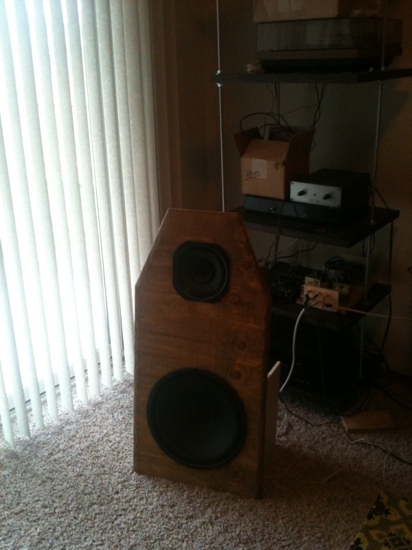

Anyway, here's the latest iteration of the OB... rounded edges and all...
sorry for the OT. I'll stop now.
