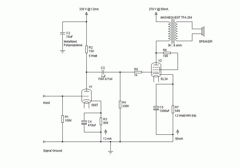

I apologize. THe sound and the alcohol prevented any further transmissions. It is a SE EL34 amp using a 5687 as the driver. It is triode strapped using no feedback. The output transformers are Magnequest TFA-204s. The rectifier is a GZ34. I will draw up an "as built" schematic with the part numbers listed. I'll even try for a pic or two but I may have to have someone host the images as I don't think I can get it to upload to the site due to the resolution. As far as being Holy goes I'm afraid you have the wrong guy. I have been accused of much worse though. So thanks. I think.
:devilr:
Here is the schematic of the amp "as built". The biasing of the 5687 isn't optimal as I'm dropping more voltage across the plate resistor than I am the tube itself. I ended up with the grid at -6 volts. I was aiming for -7. Go figure.

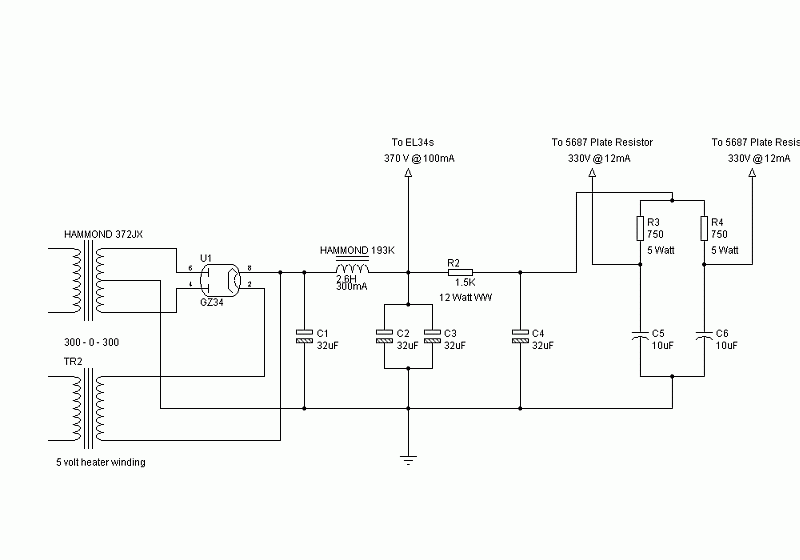

Here is the power supply. Simple. It works very nicely though. I will try to post some tube porn. I went to a lot of trouble to make the aesthetics of the amp presentable. I may have to have someone host the images though.
