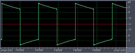

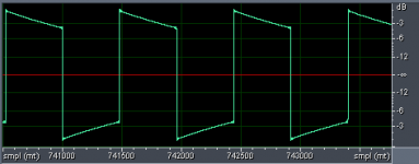

Droop in squarewave response is entirely phase/GD issue.
This theme is rampant in audio electronics with coupling capacitors forming low frequency high pass filters.
Here is loopback response of E-MU 0404 USB soundcard with square 50Hz square waves:
This is just two amplifiers. Oscilloscope placed between output and input shows intermediate droop. I use DSP to effectively address this.
Pano's first all pass filter adds group delay shelving function that does little more phase damage to that already existent in recording/playback path. In case of "Josie", it's got electric guitars and bass, playing through musical instrument amplifiers, so is already plagued with this type of GD.
I expect that this is why audibility of phase/GD changes are very hard to hear, supporting observations that audible impact occurs with certain music/test signals using a particular playback system.
Pano's second phase 'kink' puts an inflection point in GD with significant second derivative that is highly unnatural.
Nice efforts, How it was ensured that the mic used in measurements
had least distortions for square wave and there was no error. I might be wrong but just my doubt.
