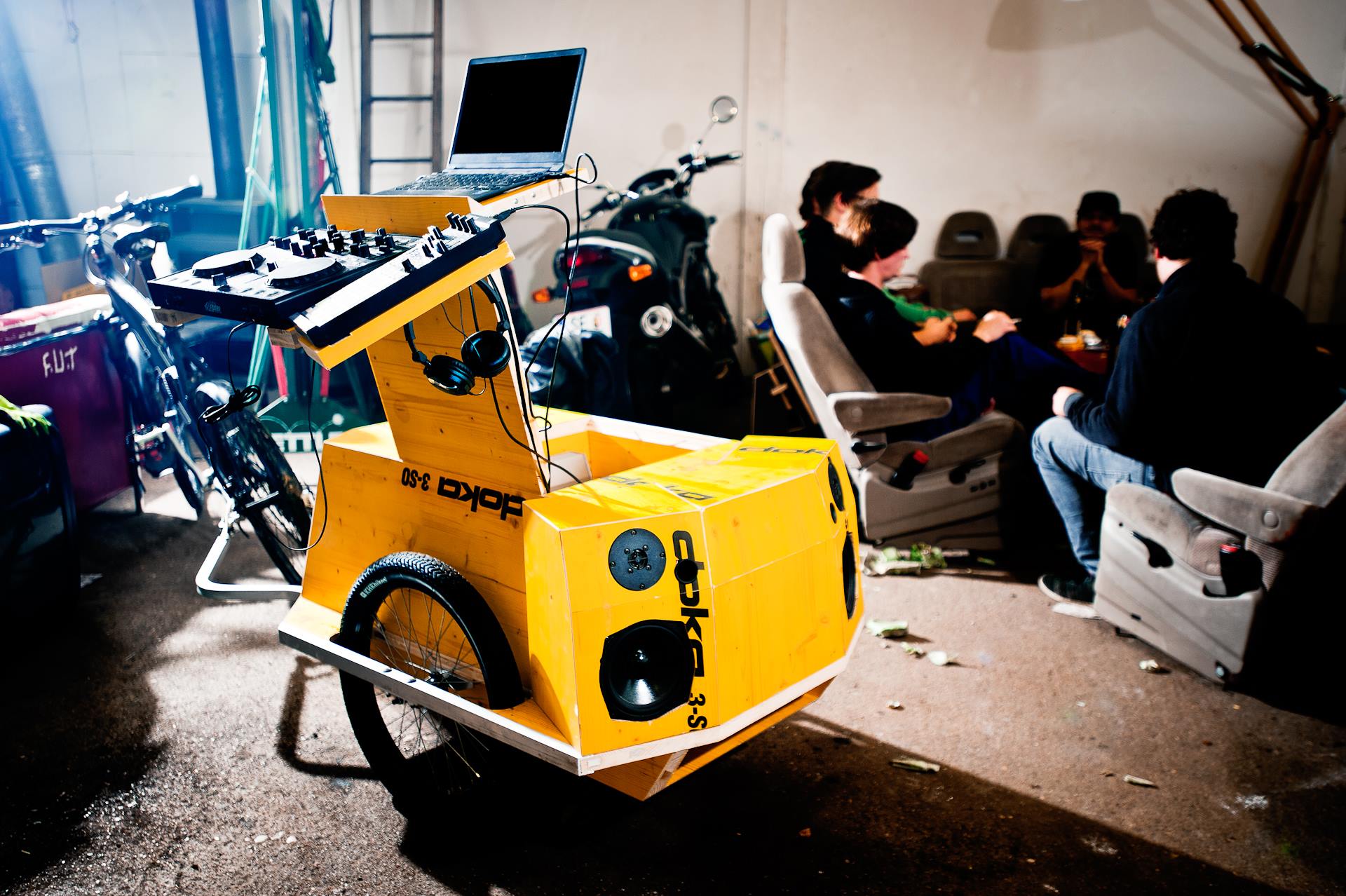

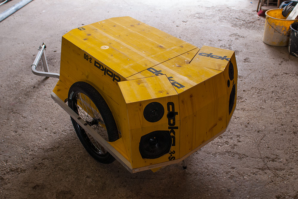

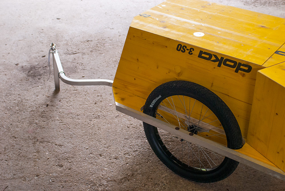

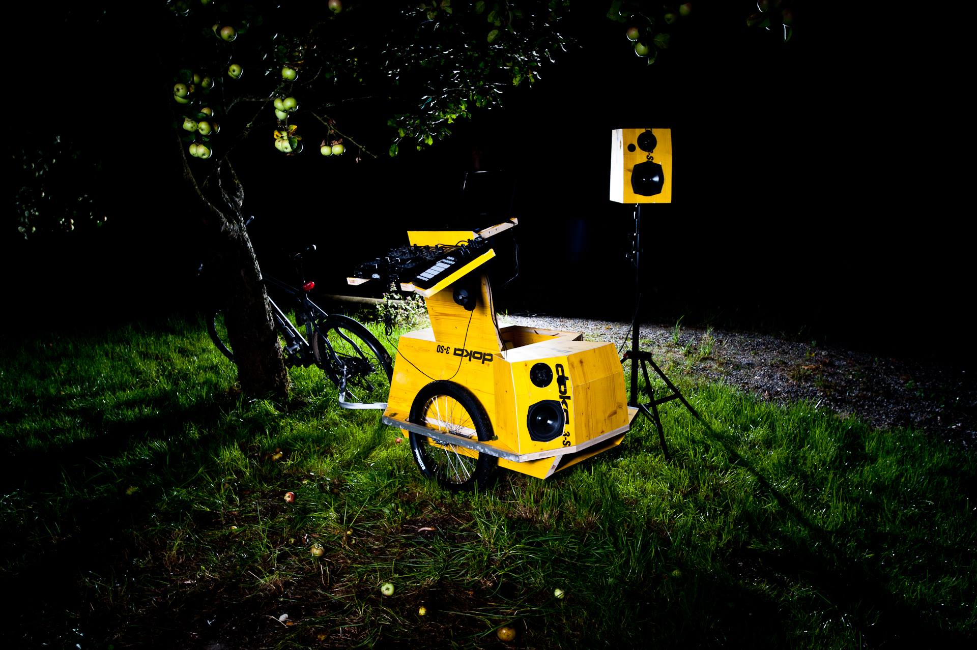

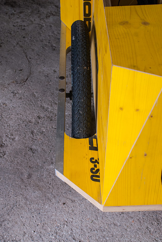

My brother and me built a bike-trailer for taking our music nearly everywhere. We took apart a pair of old yamaha speakers and a car subwoofer and constructed a chassis made of formwork panels which are normally used for making concrete molds. It's quite heavy but this also means it doesn't move a millimeter when played at high volumes.

Nice! Love the design - angular panels like a military stealth tank only in yellow. I like the pop up DJ workstation too. More details please.
Drivers amps etc. what exactly are the panels made of?

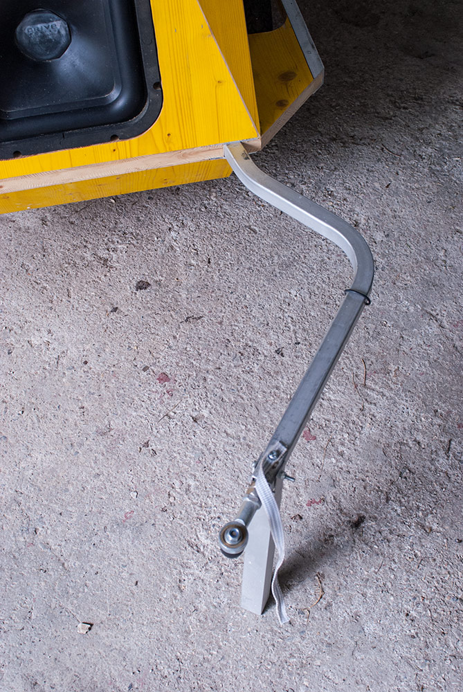

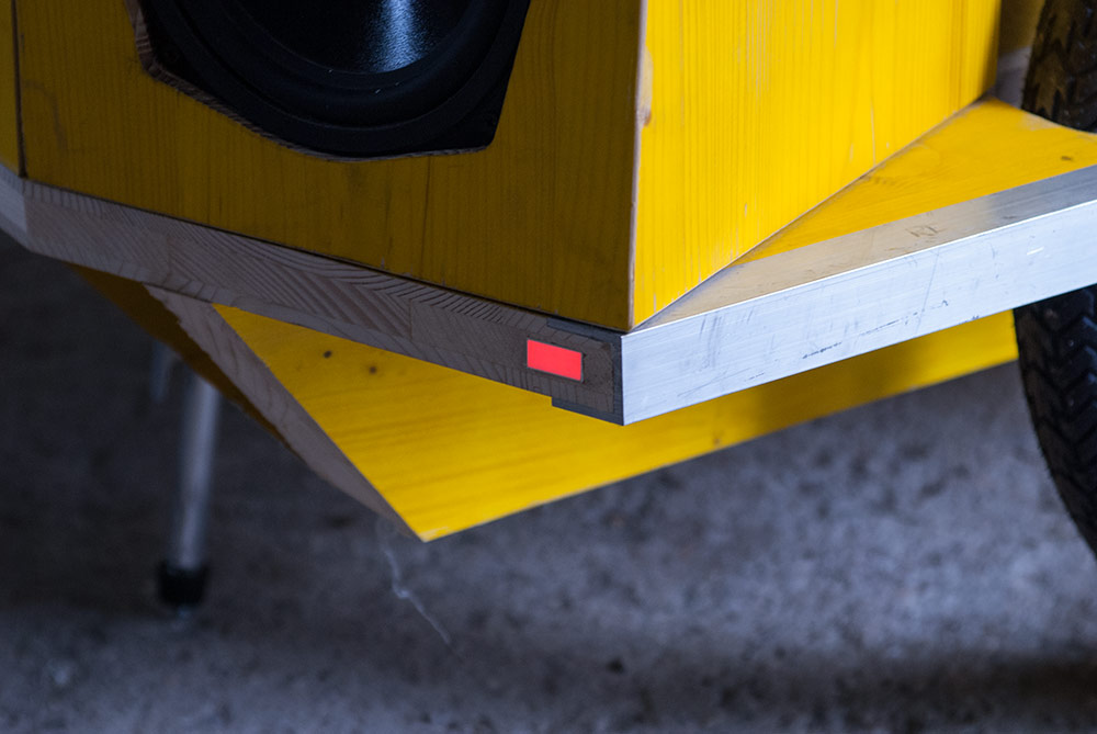

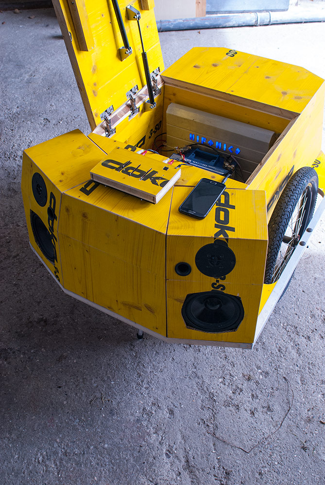

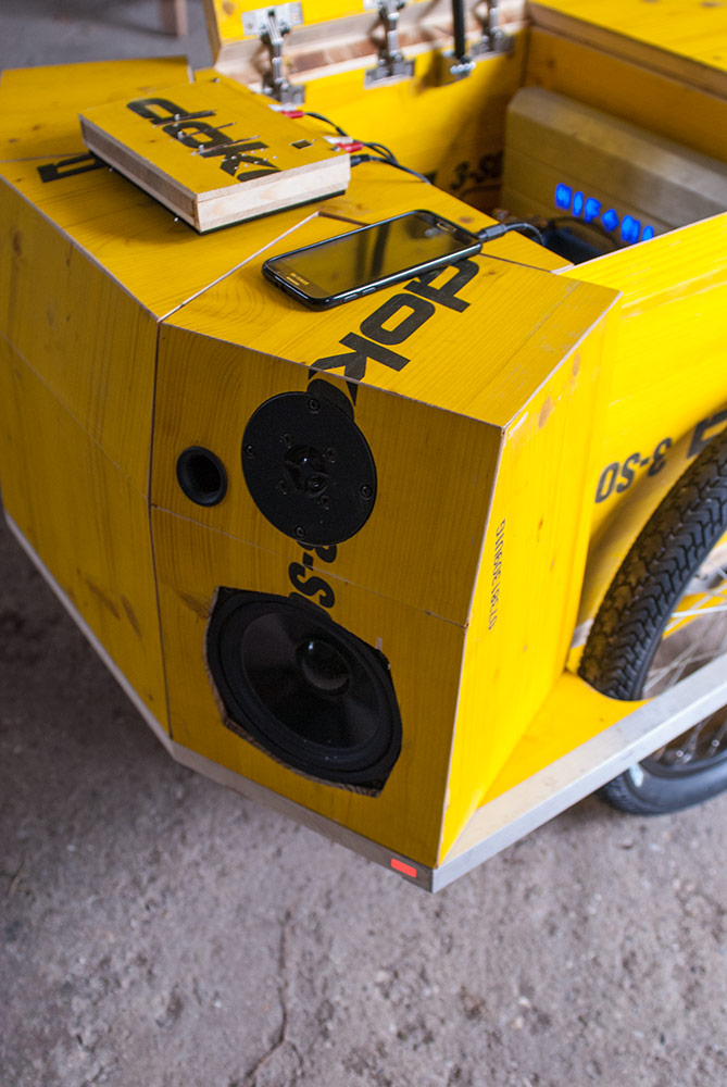

hi xrk971, glad you like it! I attached some pics with details.
We are using a Hifonics Zeus amp Type Zxi 4404, rated 4x75 watts. It powers the two high-/midrange speakers and the sub (two bridged channels).
The panels we used are called doka 3-so, they are very widespread here in europe. i'm sure you have similar panels in us. its plywood made of three layers, glued and clamped together and coated with a robust layer of paint.

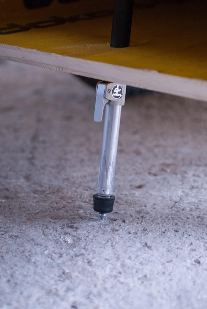

Thank you all! The space is just a storage for the cables and some other stuff. Under the base panel we built another box which is open on the back side. The sub enclosure is built as a bass reflex system and has its port in the base panel which leads the soundwaves to the back, where the high/midrange speakers are mounted.
When driving, we can store the tripods in that bass box.
BTW: The battery has 52Ah and powers the system for about 3 hours at 2/3 volume. And the power is really awesome.
