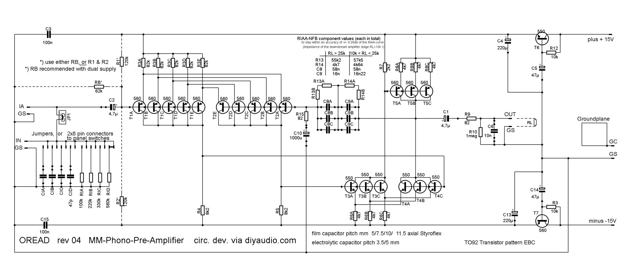

Dear reader,
I think it's time for you to put your own OREAD-EQ into practice.
Perhaps the original discussion and finding thread has become a bit too long and confusing, so I'm starting a brand new container for all our own builds of this interesting and certainly much underrated MM phono equalizer.
To get you in the mood, here is a PDF document containing all the image files backwards, i.e. up to just before the beginning.
I wish all DIY enthusiasts a lot of fun with OREAD, a daring concept. You will find all the necessary information in the thread itself, the components used are available worldwide and with @catd's circuit boards you can easily and absolutely safely rebuild OREAD.
Other board versions are also very welcome.
All the best to you,
hbt.audio

The initial concern of the protagonists (@Chestnutspread and myself) was to show how easy it can be to go your own way - to set up a functional mm-equalizer without being dependent on a dictate or a doctrine. Everything should reflect the joy of one's own idea and realization and at the same time inspire reflection.
I hope that a not immodest number of oreads will see the light of day in 2025.

Hello Ed,
I completely agree with you. The so-called +1 error was deliberately not corrected or particularly addressed because I didn't want to unsettle the thread creator chestnutspread at the time and wanted to make the concept structured, simple and absolutely safe to rebuild. However, I touched on it in the form of mention the fourth time constant and claimed that we can neglect it as long as the edge falls constantly to >200kHz - and it does.
EXakt Mk2 corrects everything completely. But that's another story.

It should also be noted that developers such as Mr. Nick S. believe that there is still significant audio information above 20kHz on the vinyl pressing of a long-playing record and therefore the dubious Neumann constant must be included ..!
None of this is the case in reality, but what's the point?
The point is :
with the term +1 error I wanted to stimulate thought, essentially it expresses that a non-inverting amplifier cannot attenuate the input signal, but only boost it. This means that the required theoretical transfer function is (as usual) not 100% achievable.
The potential self-builder should not be confused. With a gain of +40dB at f=1kHz, everything is fine in any case.

My casual observation is that my pre-amp with no systematic EQ error seems quieter than my pre-amp with the +1 error, but the two were several decades and phono cartridges apart.

Let's not digress here in the construction thread, but note that T3R = 75µsec is a wonderful (special) thing 😉. I'd love for this thread to be about crafting - and for us to see many new incarnations of the Oread theme.

on the current PCB circuit it is present.Correct me if I'm wrong, but the "+1 error" in the active RIAA EQ does not appear to have been removed by a subsequent low-pass filter.
https://www.diyaudio.com/community/attachments/oread_04_circ-jpg.1293012/
