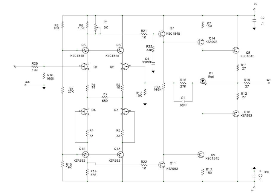

can you confirm voltages across R1 and R2?
no load, input shorted (if there is volume pot, pot on minimum)

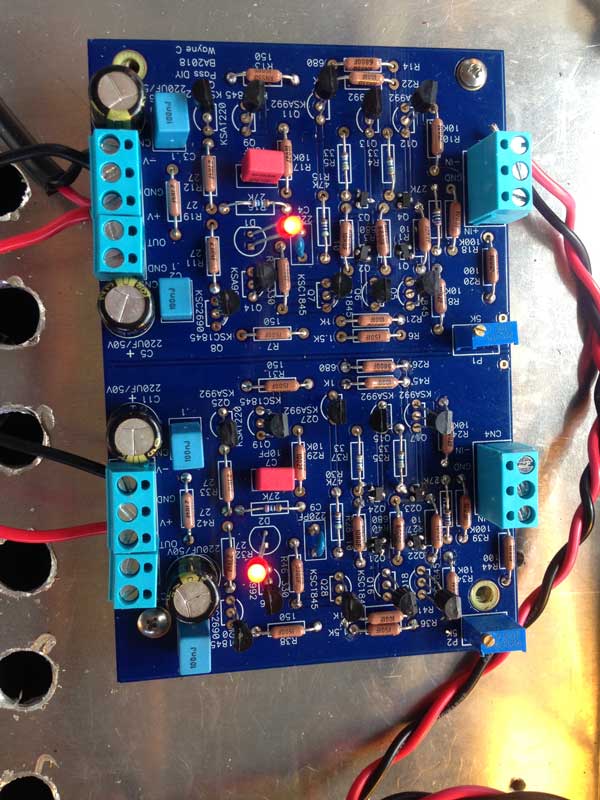

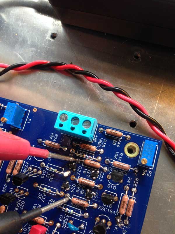

So I reckon I completely failed to fit those surface mounted Jfets properly .
The question now is really whether I attempt to repair it or just start again from the beginning with the new information that you gave me about how to solder those tiny things.

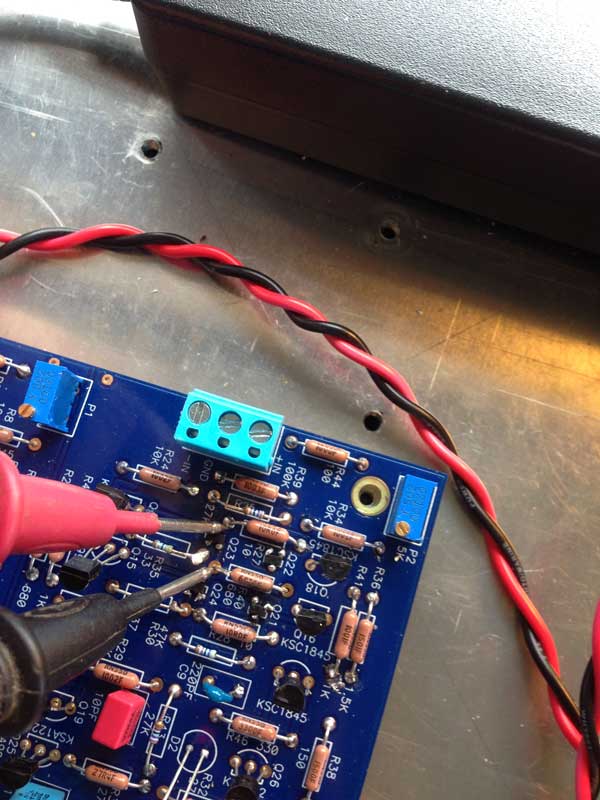

"across resistor" means - DMM set to voltage, one probe on one end of said resistor, second probe on second end of said resistor
do that for R1 and for R2
R1 = .01V
R2 = .02V

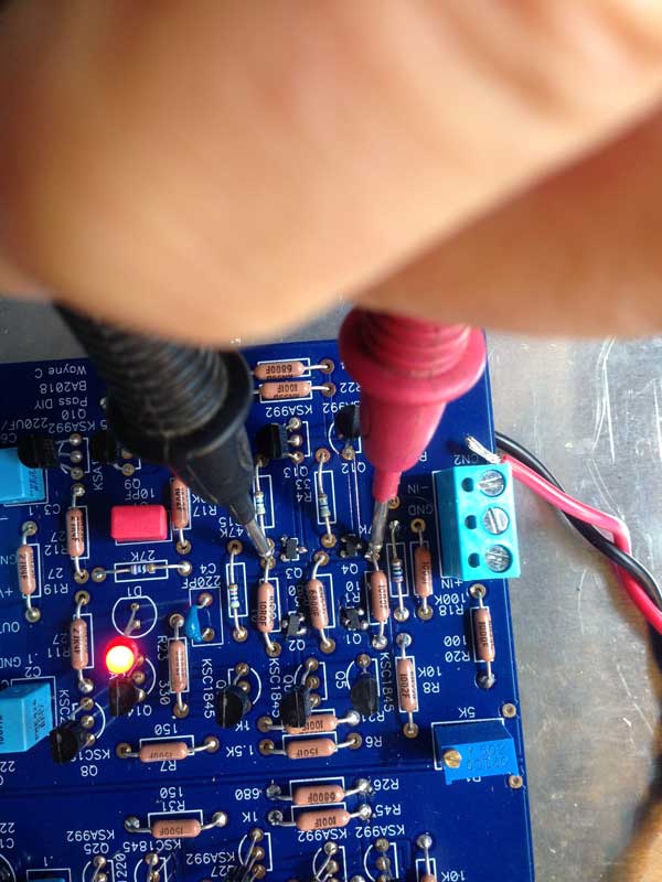

The output of this channel measures zero now between output and ground. Adjusting the trimpot brings it down quickly.
The other channel equivalent[sorry couldn't remember those R numbers.]
R1=0.2V
R2=0.3V
On this channel the output voltage is 8.3V and adjusting the trimpot makes no difference.
R2 = .02V
R1=0.2V
R2=0.3V

at lower reading channel , current seems so - so ......... 1 and 2 mA
while on other channel currents computes as 20mA and 30mA ........ which is noooooo goood
so - best to find new JFets, and this time follow soldering procedure I explained
nothing is criticall as it seems, but mistakes are easy to make , then you have scorched part

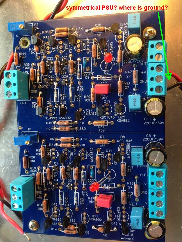

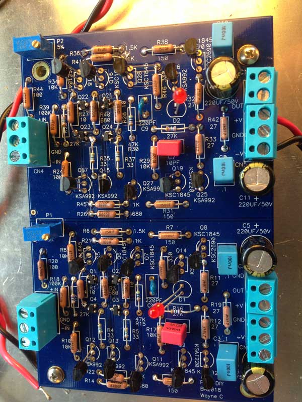

I'm a lot later on this topic than others but... Did I just notice you have the 220 picofarad and the 10picofarad caps in the board swapped with each other? Or is it actually.. me, that swapped them? Cause the wima's say 220, and the ceramics say 100, which is 10 +0 zeroes. So, 1 0 - picofarad.
Have you managed to fix it in mean time?

A couple of tips, check the connection from each leg to the next solder point on the trace for each JFET. You shouldn't have to struggle to get a reading. Also, get some isopropyl alcohol and clean all of the flux around the JFETs. You can try re flowing the solder points. Also, since these JFETs may be bad, you can use them to get some practice soldering and desoldering them.
The boards that DIYaudio supplies are of excellent quality. If you keep your soldering temperature low, you should have enough of opportunities to retry soldering the SMD. When you order them, get the 25 quantity. they are cheap. Also, if you decide to build another board etc in the future for balanced, dual mono, they should be matched close enough.
This is a great preamp and well worth the effort. I had 19v DC offset on one channel that I couldn't adjust. After inspecting, one leg had a bad connection. After reflowing the solder and cleaning, it sounds great with a very stable offset.

Good catch. That'd explain the partial functionHello Dan / Wot,
is that a symmetrical powersupply you are using? I don't see ground attached on the pics. Perhaps I missed it?
Cheers
Dirk
