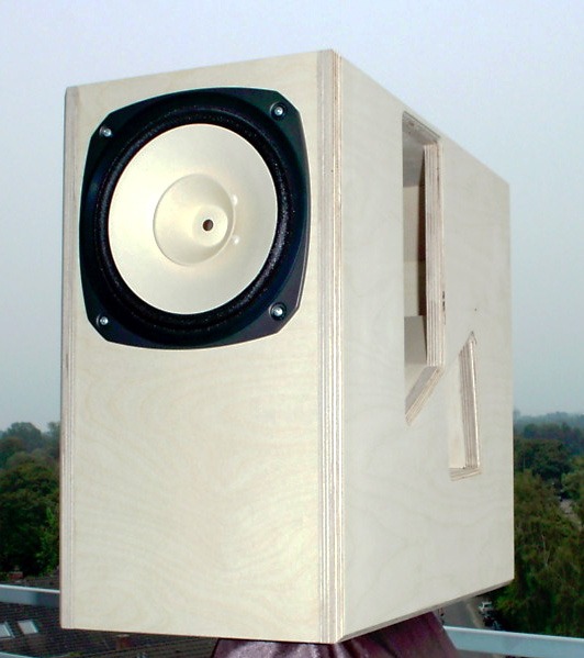

Okay, so I bought four SEAS FA22 because I got them for a very nice price.
What would happen if I simply used two FA22 in the same cabinet, just wired identically from the speaker binding posts? Higher output, more bass, higher sensitivity, or is it just a bad idea?
I saw a speaker design on the Markaudio CHR-120 where two drivers were used...
Here’s a couple of pics of the first two FA22 drivers in the cabinet that they came in. I’ve hooked them up to a little QUAD Vena and I very pleasantly surprised by how nice everything sounds.
The next two FA22 will arrive tomorrow. I’ll probably try to put two FA22s in each speaker and see what happens.
After that I’ll try finding a suitable bass driver to make a real WAW.

So I've put two FA22 in a 100L cabinet and the result are mixed:
Pros can be boiled down to: much bigger and louder sound. More live-sound, which I like.
Cons: Overblown and woolly bass and lower midrange. There's also some weird stuff going on in the top end as well but I ascribe that to lobing which (I hope) I will fix when I roll off the second driver.
I've put these drivers in a closed cabinet. It's thin-walled and still undamped and unbraced.
So a couple of questions:
- How much of the bloated, woolly bass can be ascribed to the unbraced and undamped cabinet?
- Is the 100L actually too small for two FA22?
- Would adding a port or passive radiator make it easier to control the bass? (That's just me thinking that having an outlet for the pressure would help).
Thank you all🙂
Yes, the big unbraced walls will act as poorly tuned passive radiators.
A bit. Perhaps make it aperiodic? Opposite of a Vent = PR (making it a BR is very likely to make thigns worse). Aperiodic is a whole subject on its own.
dave
Thank you. I've braced and damped now and that has helped quite a bit. For the money and my skill-level this is now a nice sounding speaker. And nice to experience what wiring in parallel does.
I do think I'll eventually try to switch one of the FA22 with a helper-woofer.
Thanks again🙂
