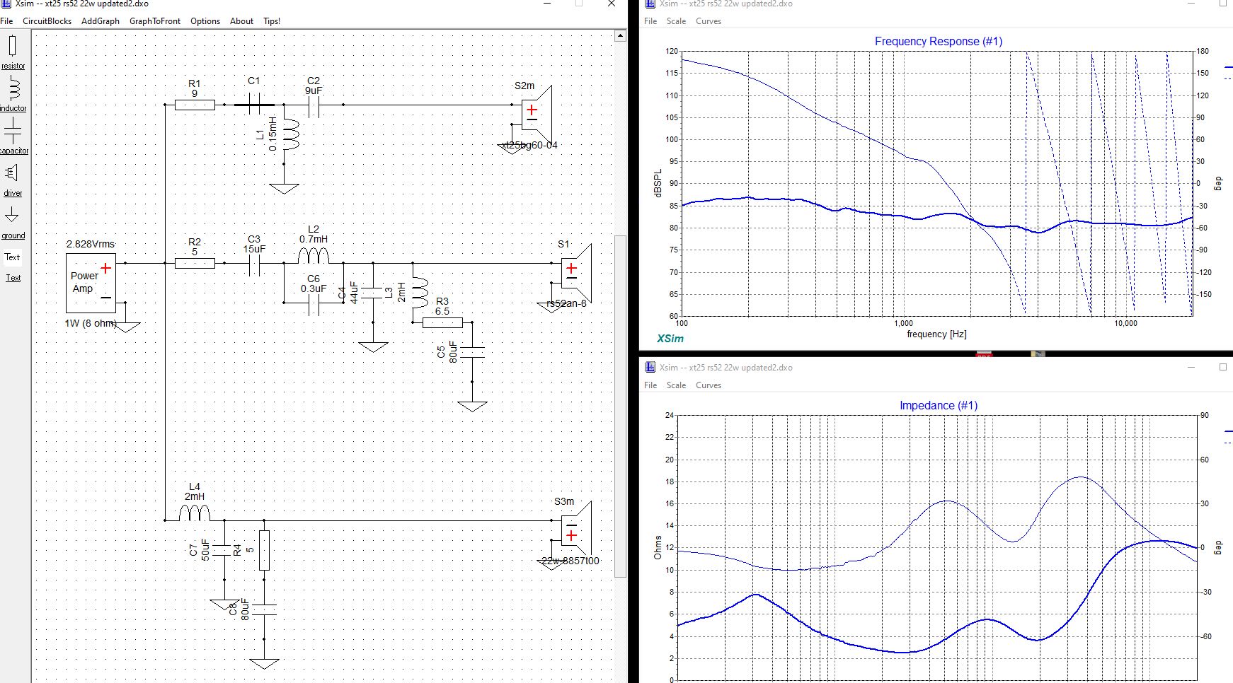

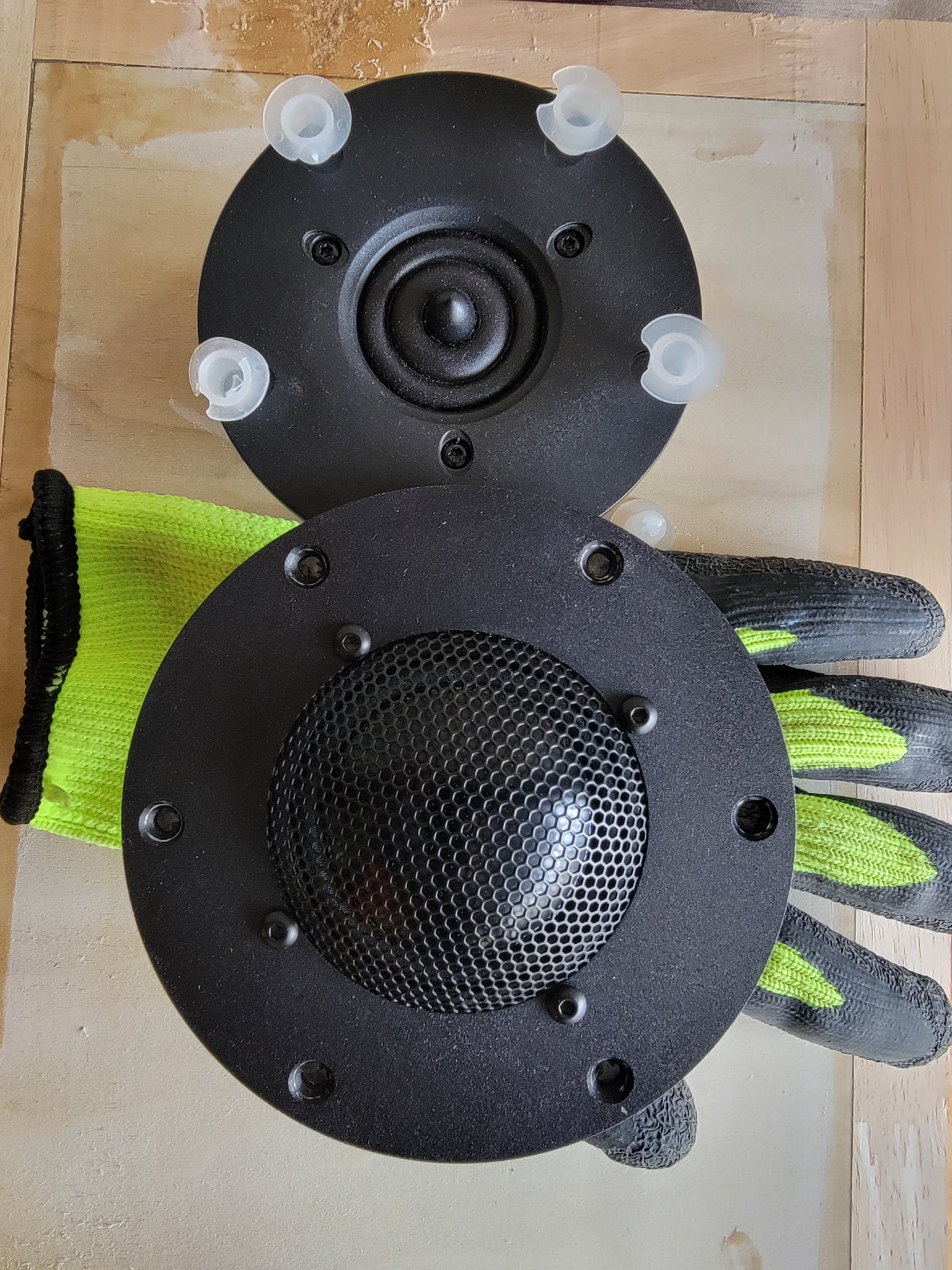

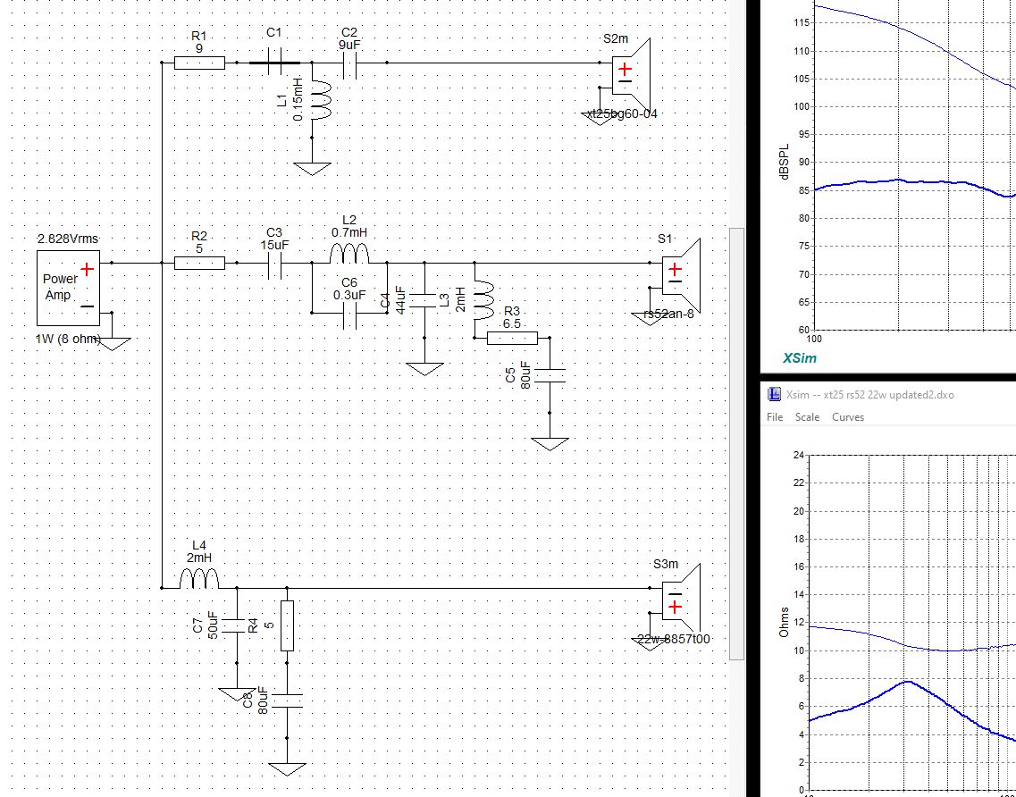

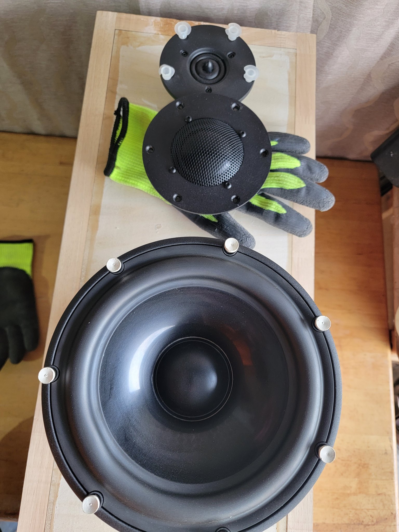

Okay, here's what I have for almost final design.
I think I'm going to overlap the VIFA XT25 with the RS52 on top just to get closer center to center distance
Three options are in the pics. I like the way RS52 on top of XT25 looks the best.
I didn't like the TC9 as much as I like the RS52
I generally like metal drivers the most and paper the least.
I wish I had the fiberglass TC9 to try, now that I think about it.
Thanks to Zaph, I took the cross-over from him and tried to tweak it.
Probably goofed it up a little.
I don't seem to have super smooth response and reverse nulls don't look that great.
I have little idea what the impedance or phase is suppose to look like.
http://zaphaudio.com/ZDT3.5.html
Thanks to Michael Chua also, I might use his cross-over instead.
https://ampslab.com/falcon.htm
I'm trying to make Zaph's x-over because:
1) Tweeter cross-over point is 3.5 KHz vs 4 KHz
2) I modified it first to use in my previous speakers
3) Less parts
4) Is designed for a baffle
5) Both had test results, but Zaph had doper tests 🤣🤓

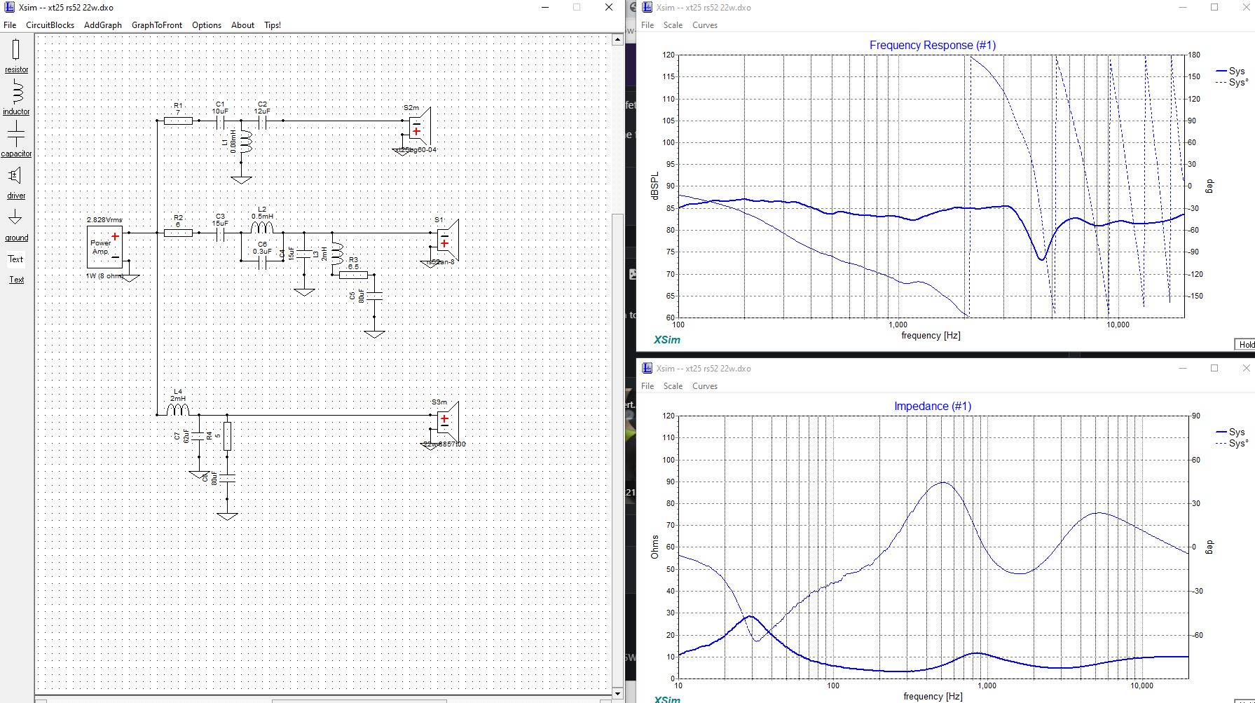

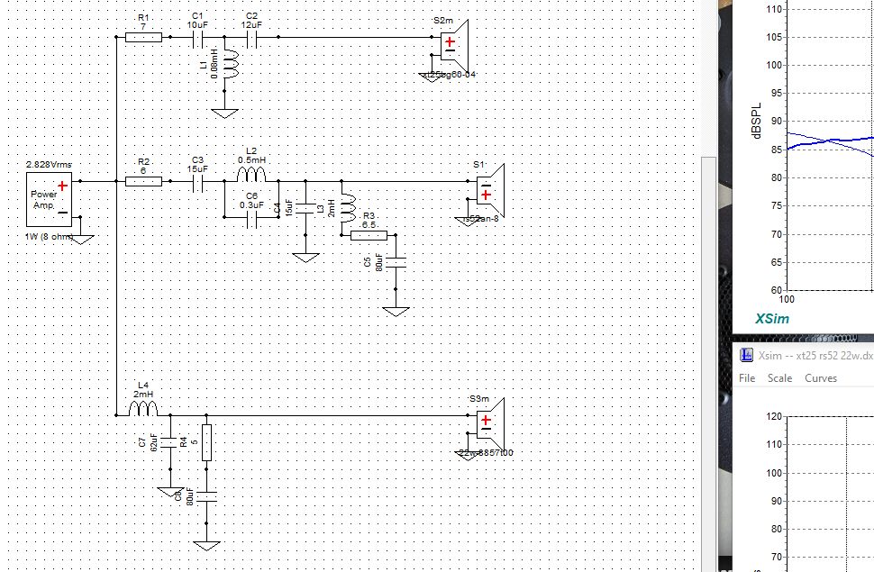

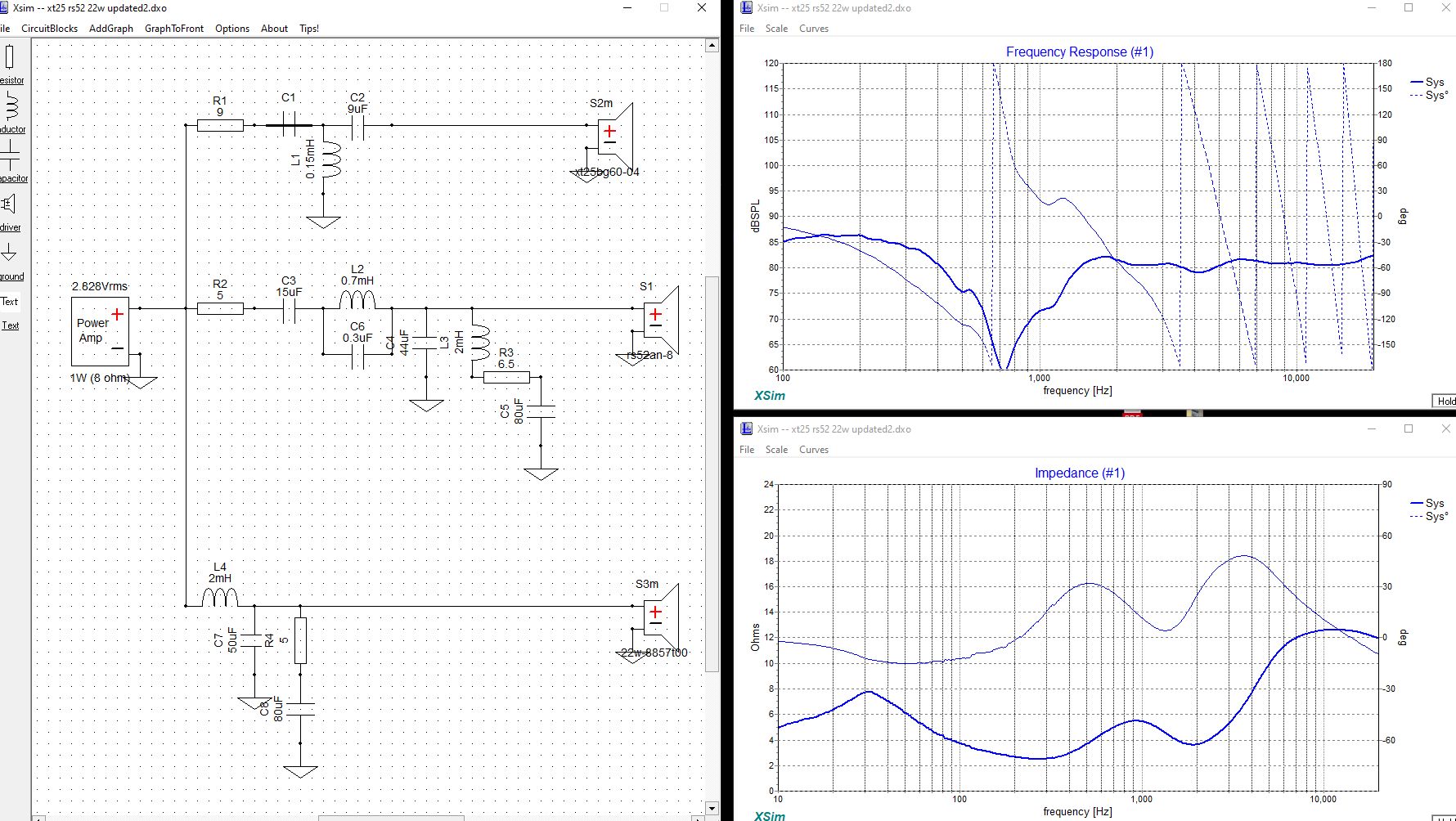

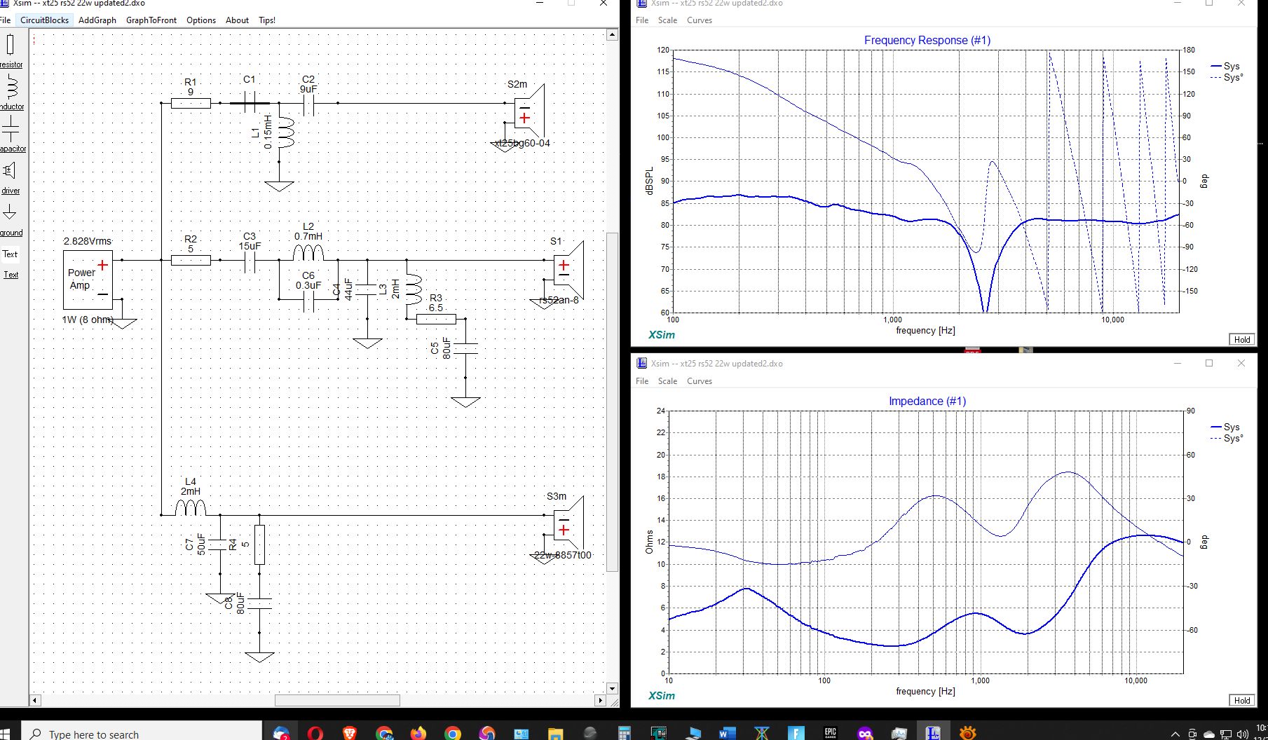

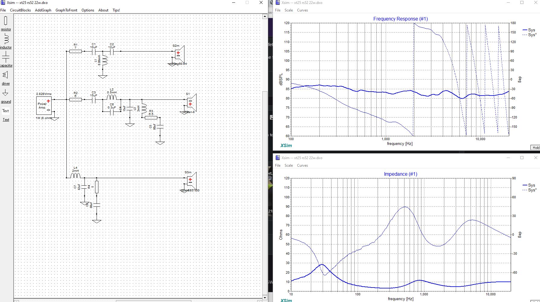

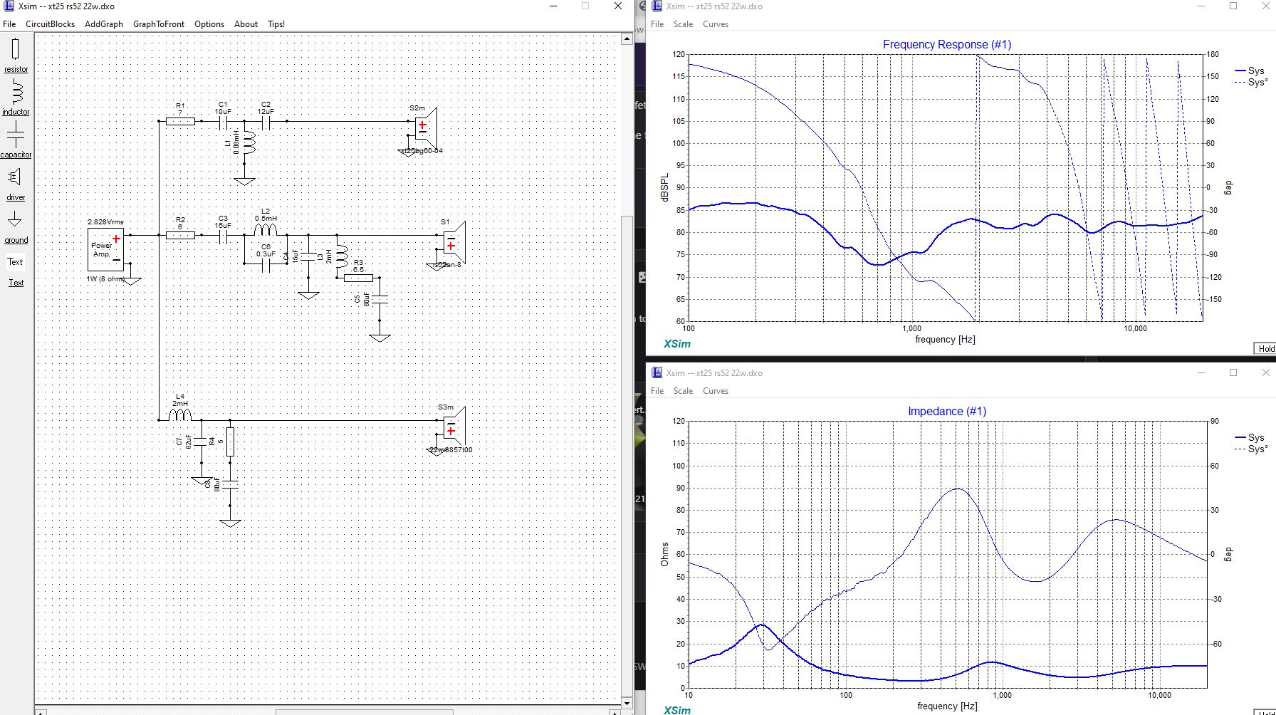

When doing the cross-over should I focus on having a reverse null with the tweeter to mid crossover or flattest / best frequency response?
Hardest thing is to get rid of the dip at 4 KHz.
I can get it a little better (by changing 44 uF cap on the mid), but then I lose the reverse null at the tweeter/mid cross-over point.
And the 4 KHz dip get larger.
But the ZRT FR doesn't seem to be much flatter than the cross-over I just uploaded.
Well below 500 Hz it's flatter, but it takes into account the BSC (I think) and I don't like a lot of highs.
Or what could use improvement?
I left the woofer SPL higher below 400 Hz to compensate for baffle step compression.
But I think BSC is around 200 Hz on 11 inch (27.5 cm) wide baffle.
Also I don't like a lot of highs.
I changed the tweeter cross-over to 1 cap and 1 inductor , instead of 2 caps
Baffle step is around 450Hz. Where are you planning to cross the woofer to the an52? An52 has fs of around 400Hz so you'd want to go twice as high with your crossover. Don't know how your woofer is gonna like that. I know you could pull it off with rs225 at around 800Hz. Also keep in mind moving your mid dome in front of your tweeter dome is gonna offset the acoustic centers so your domes won't be time aligned like they would be if flush mounted.
I was just about to ask about time aligning, but not the 3 mm (thickness of the flange) that I'm moving the RS52 forward.

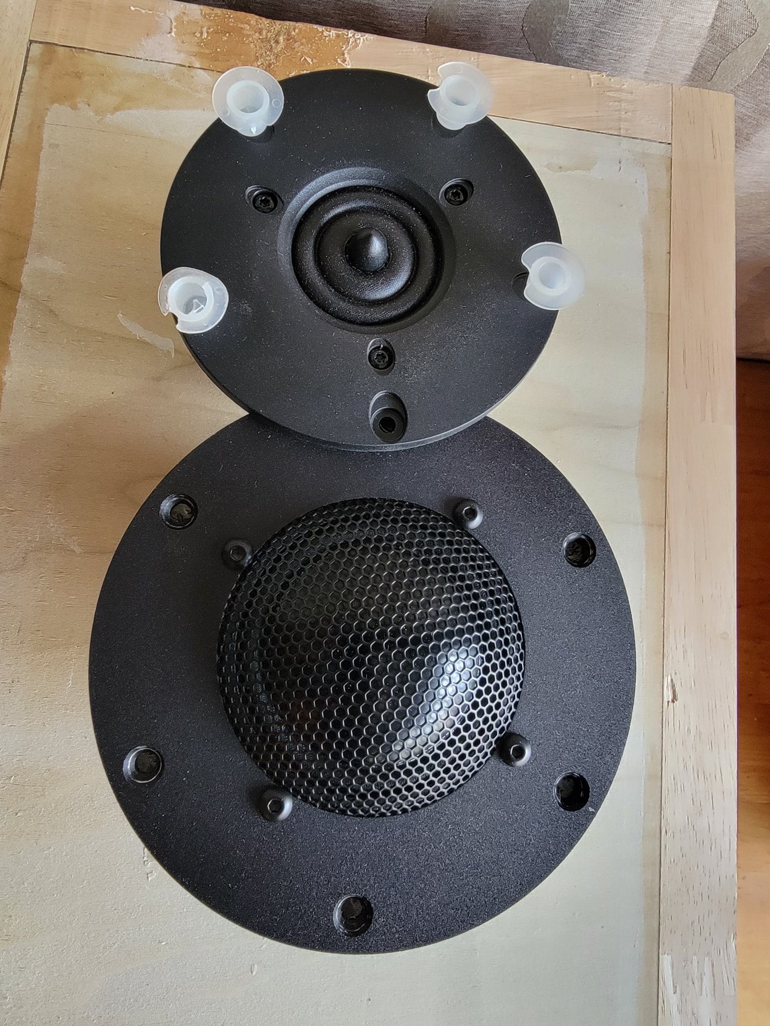

I can also put the RS52 under the Vifa tweeter.
But tweeter will not be flush mounted about 20% of the way around if I put the RS52 under:
http://zaphaudio.com/mtg-surface.html
I'm almost done with the enclosure and I was wondering if I should put the woofer flat on the baffle or do what Troels does in some of his designs:
http://www.troelsgravesen.dk/SBA-941.htm
How important is it to do this? It's 25 mm difference in my case.
I think it looks better with a flat baffle, but the RS52 isn't flush mounted and that might look weird anyway.
I'm not sure what to do about the RS52 mounting.
I was thinking of routing out the Vifa XT25 plastic face, but I feel like it needs the whole face for structure.
Crossover points are the reverse nulls in the above pics: 2600 Hz and 735 Hz.

I think I'm going to make a flat baffle, it's easier.
I was also going to make a removeable baffle, but at this point I just want it done.
I already made so many mistakes, I don't think one more matters anyway 😆
I doubt I will hear any difference with the woofer 25 mm further forward.
But maybe I'm wrong?
There is no need to look at a reverse null if you turn on phase in Xsim. You have system phase turned on, you can turn that off and turn it on for the drivers.should I focus on having a reverse null
- WAW / FAST -- TC9FD18 and Peerless-NE225W-08 or scanspeak-revelator-22w/8857t-00
