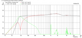

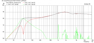

Here is a simulation of an Alpair A7.3 in a MLTL in 4pi space with and without 5R/1mH BSC - about 6dB compensation is provided. If you use near walls, use smaller R value (have several 1R, 0.5R, 0.33R's on hand to fine tune to taste).
No BSC:
With 1mH and 5R BSC:
The broad bump near 2k is the diffraction of a baffle edge.
Ok, then it was just a communication problem. I would call the filter a bell filter and not a shelf.
The 12db drop did only appear when I did put the inductor and the resistor one after another, in serial. If I insert them in a parallel way, then I get the same results as you.
