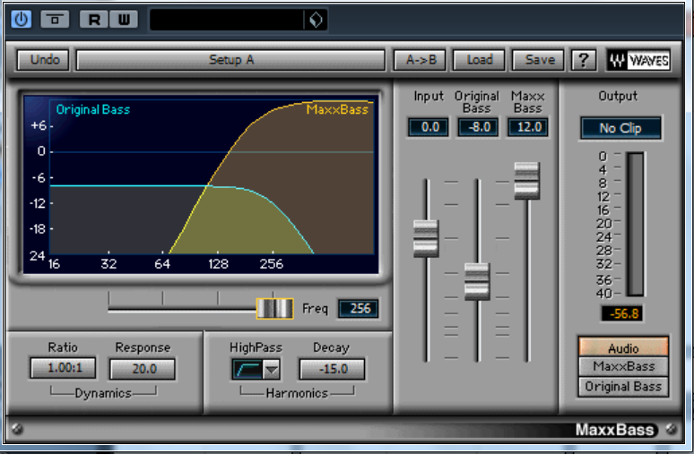

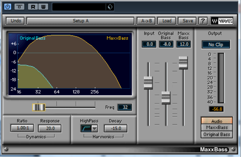

Yes, if you read the papers they show that these methods are not sufficiently "good"... they're discussed in some detail. Anyhow at ~$50USD for one of these commercial DSP based boxes, it's hardly worth the effort to try the diode clipping methods.
I see you have a computer plug in... the graphs are interesting 😀
Of course it looks boosted (the Maxxbass output), but presumably you did that to make it easier to see?? Looks like that from the sliders... thanks for this!

What is sufficiently good? No audible difference between original and processed sound, that's not going to happen, not in analogue, not in digital.
But you can certainly get a subjectively "better" low frequency performance for small speakers.
And in mixing you can get more bass without actual more bass frequencies, it does work but you can always hear a difference.
This is diyaudio so why not try it?
I indeed put the sliders so that its easy to see what is happening in the pluginn.
