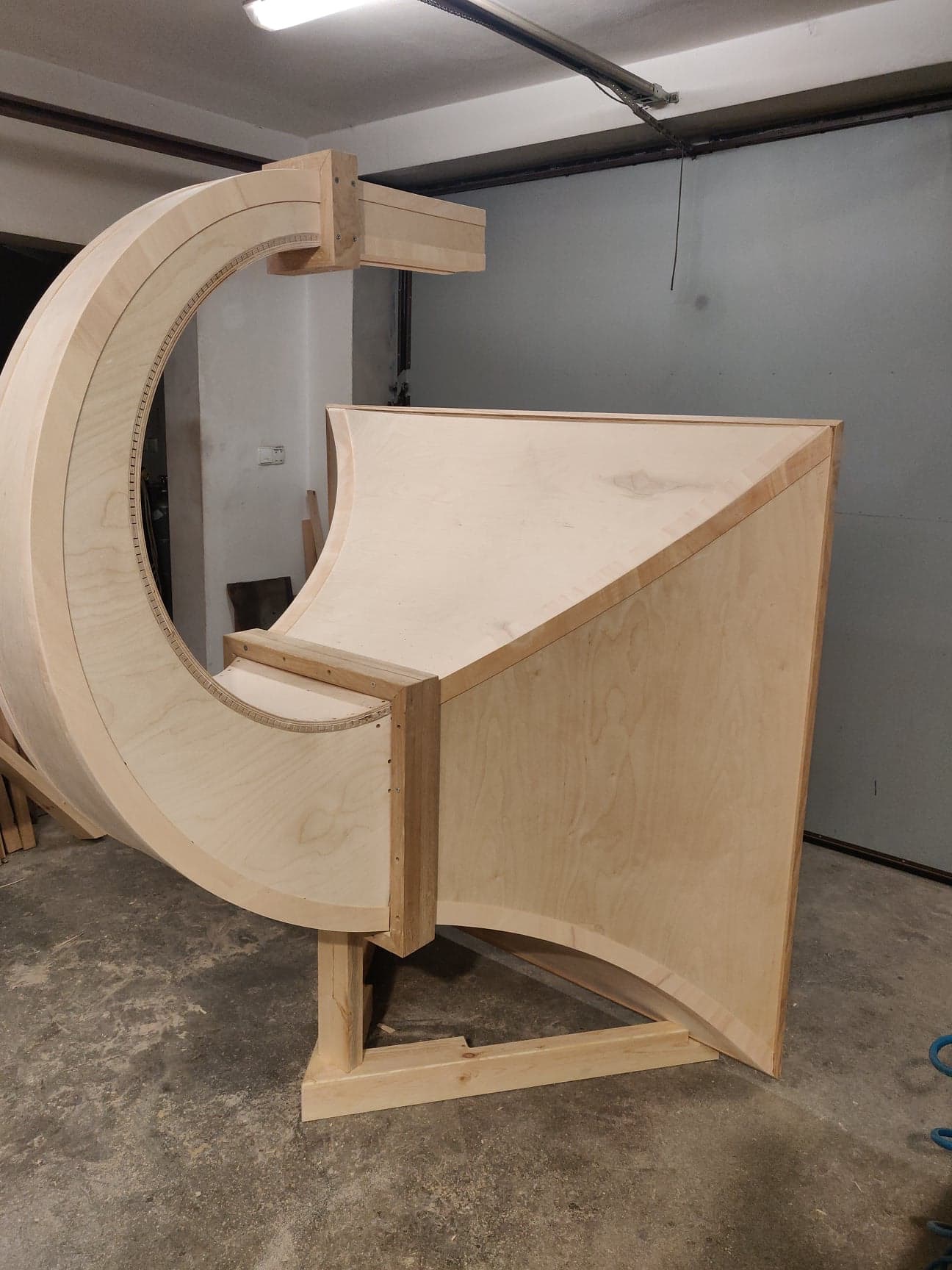

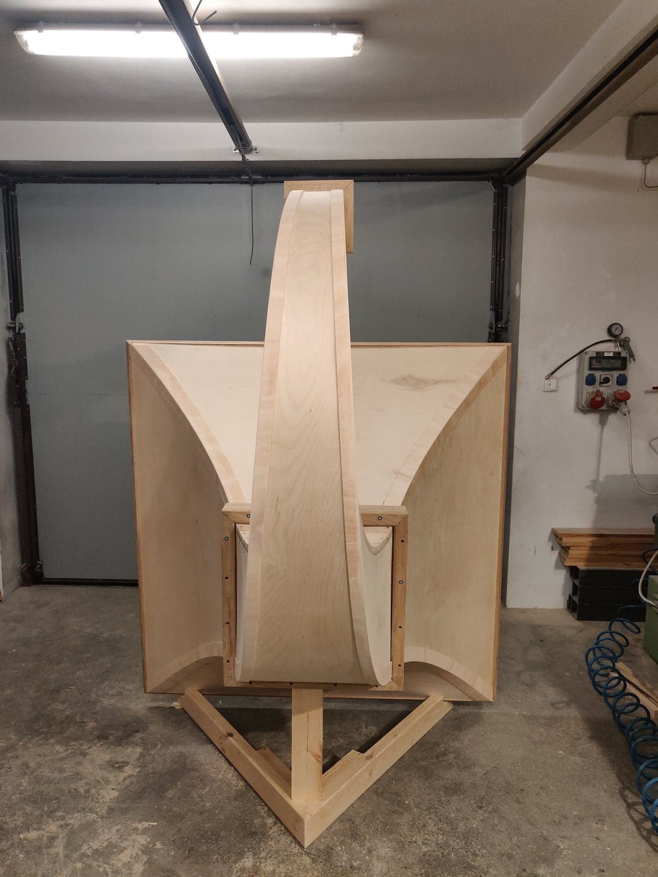

At last there is a +100 cm horn/waveguide who does six octaves and i look forward to the summer holiday at home with my JBL2451 truextent and their new huge friends 🙂

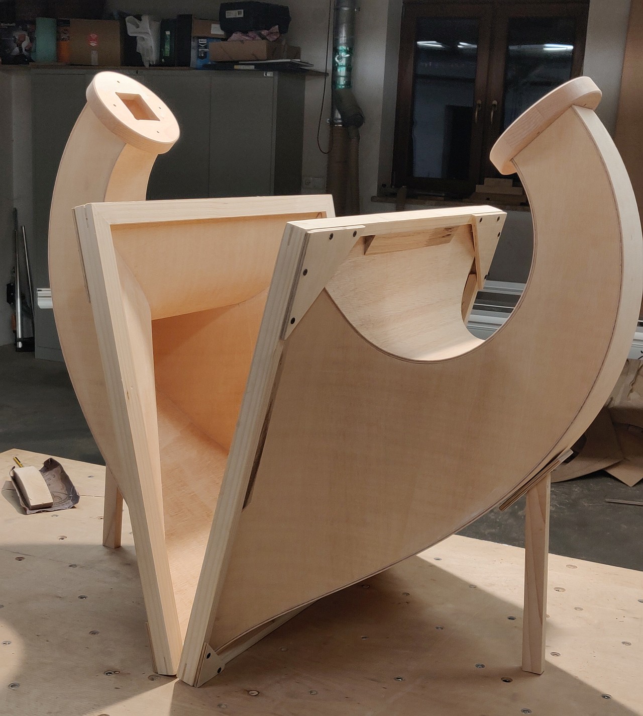

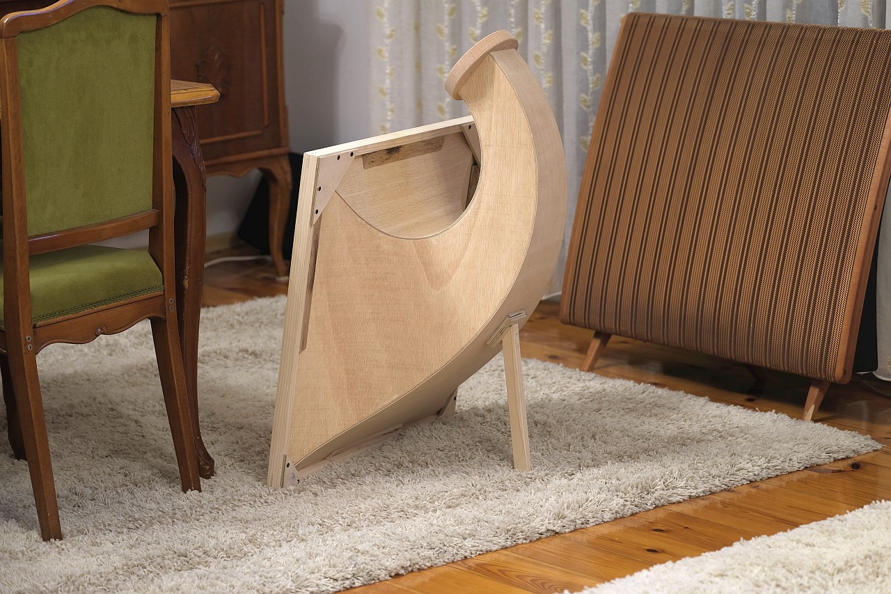

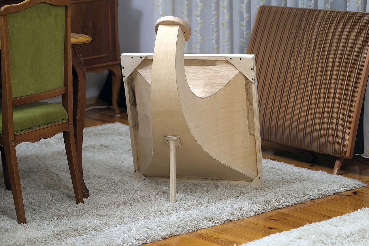

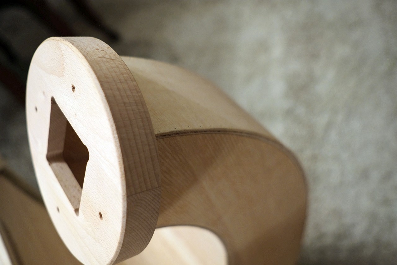

Few more pics.
Is there any plans for this guy and all the build info and parts needed? Sorry if I mist it in a early post

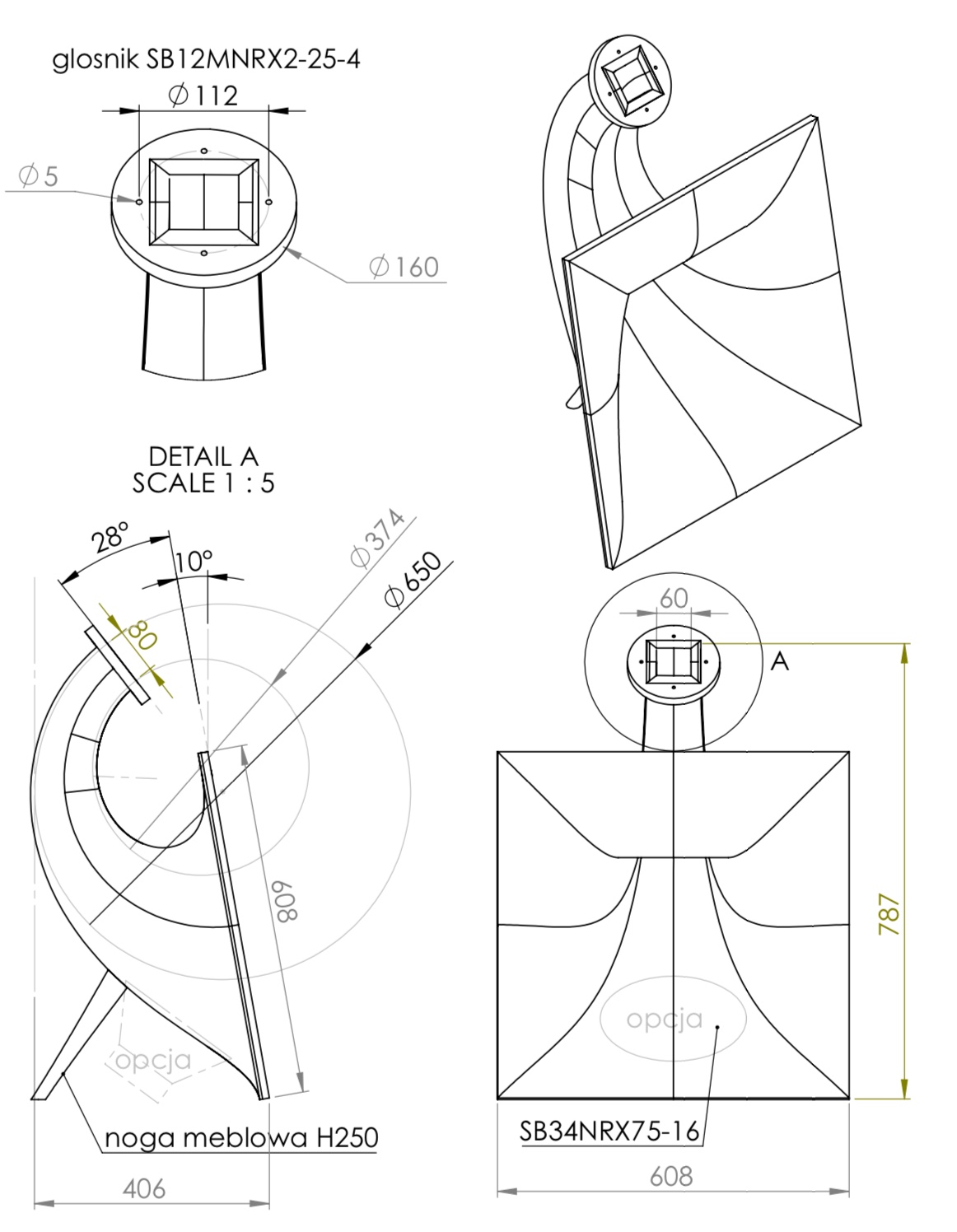

I haven't posted plans yet. Waiting for feedback from users. So far one pair was sent to Germany.
6x6cm throat but this pair has slightly larger. Idea is to use 4-6" midrange, optionally 12" OB woofer in pedestal. If customer wants I print comp driver adapter.
I wish I could understand your plans. Lol
These horns look great
