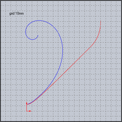

150Hz is larger than 1 meter so the mold have to be made from two parts. Can we agree on 1 meter Iwata 200Hz? Throat 3"54? Iwata could be calculated for 2" and conical adapter for smaller horns employed.
Elliptical OSWG and JMLC-OSWG hybrid is also possible and recommended for standalone applications when constant directivity is needed.

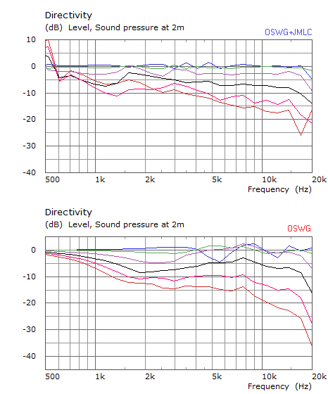

You are showing a 5dB hole in the on-axis response at ~5.7 kHz, and a 5 dB dip at 2 kHz at an unspecified off-axis angle. Is that the elliptical OS or the "Geddes" one?
It 12" axisymmetrical OS with a typical mouth diffraction on-axis that you can minimize with radius >5" or JMLC mouth. Curves 0/15/30/45/60/90deg. Elliptical OS cannot be modeled with AxiDriver just two axes alone.
Personally I think Iwata 250Hz/2" with 1" adapter is a best choice as you have headroom for group delay. If you need a midrange horn then T=0 axisymmetric JMLC is a better choice. We have such 200Hz for 15-18cm fullranges.
