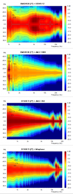

Could you tell me the directivity values for the OSWG-12? I couldnt find those numbers in my search.
I use the crossover/correction files made for the old 18Sound XR2064 horn. Tomorrow I'll make new measurements and generate new filters. Apart from the damage, the horns looks really nice.
