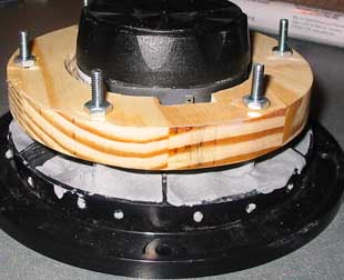

Drop in baffle hole waveguide tweeter mount. Oatly epoxy comes in a roll, mix and apply. Did a test with a nail mounted to the cut off portin of waveguide and bent the 16p nail with plyers and had to try VERY hard to get it to seperate.
Just thought this may work for people making non removable baffle cabinets.

Good recommendation. I made a wall around the back of my waveguide and poured epoxy until it reached the appropriate level. The epoxy I used was sufficiently rigid to mount the tweeter directly using course screws. Your method does not rely on obtaining large quantities of epoxy and is more approachable.
