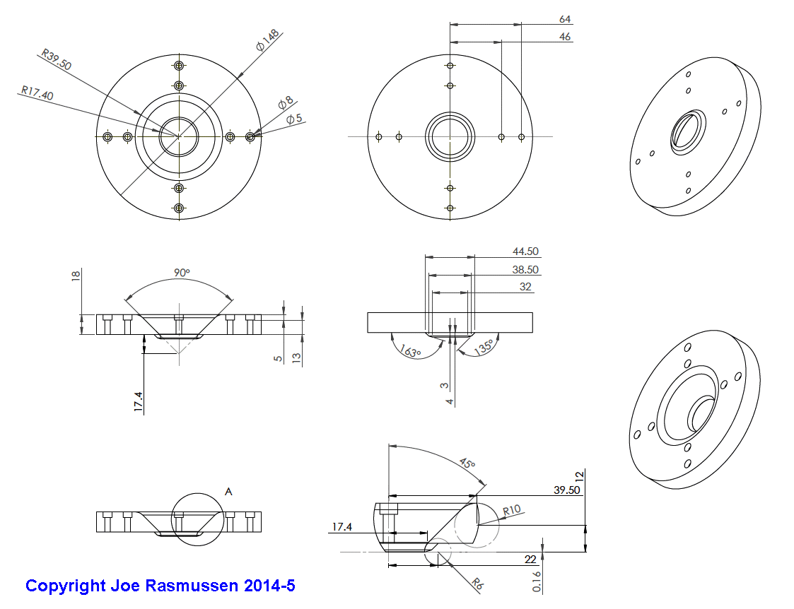

The material is known as ACETAL HOMOPOLYMER and with a slightly roughed up surface, which means it could be sprayed any colour with a $10 can of enamel.
Diameter: 148mm, to suit 150mm cut-out.
My Industrial Designer's comments: Acetal combines lubricity and wear resistance with the stiffness and strength needed in parts designed to replace metal. It is a highly-crystalline polymer that has high stiffness and strength without the need for glass reinforcement, allowing for thinner and lighter part design. It offers outstanding low and high temperature performance, good colorability, and good mating with metal and other polymers. About the best 'plastic' there is.
Edit: I was later informed that this material is also known as Delrin.

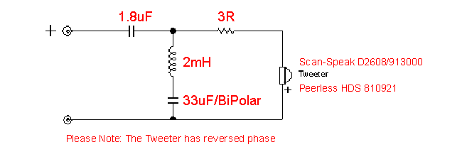

A suggested starting point of Crossover:
This gives a gradual 1st order electrical slope gradually going into 5-6th order slope. Excellent phase characterists.

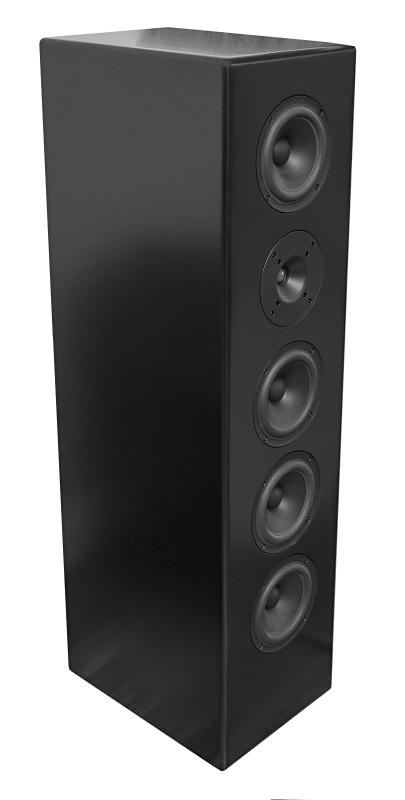

Below: Elsinore Mk6 Loudspeakers using this Waveguide. Click the image to open in full size.
Below as used in Elsinore Mk6.

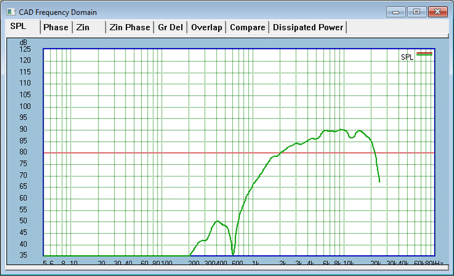

Been asked to post some responses:
Some notes: Red is online and the dip at 1900Hz can be largely ignored, same goes for the peak at 3KHz and it appears only when dead-on to the tweeter axis. The best response and the one that is recommended is the Green which is 15 degrees off axis and is also the best listening angle between 10-15 degrees. Blue is 30 degrees off axis.
The responses are typical with Waveguides and as 'gain' below 10KHz and peaks at 3KHz, the recommended crossover frequency. You can of course cross over lower than that, but you will be trading off distortion with bandwidth.
The crossover must EQ the response and looking at it, the flattest off axis response (15 degrees) is when 92dB/m-SPL (or lower) is chosen.
Cheers, Joe
PS: I often get asked, "why this tweeter?" While it was initially sold under the Peerless name, it was always a Scan-Speak tweeter and was always Made in Denmark like all Scan-Speak drivers. Because of a strange set of circumstances we have a tweeter that would be good value even if sold at 3-4 times the price. It is not perfect, but it has a set of attributes that translates into a sound quality that is rare, but only when attention to detail is made. It also has the near perfect attributes to be a Waveguide tweeter. This can be used to lower the crossover frequency (increased bandwidth) and that has certain attractions. But using a crossover of around 3KHz and the suggested high-pass filter above, the reduction in the kinds of distortions most disliked by the ear, but also measured, is remarkable. In the Elsinore Mk-6 loudspeaker, owned by Brian Gurr in Auckland New Zealand, who is somebody who builds electrostatic (and also does rebuilds), this Waveguided tweeter, according to Brian, competes with top class electrostatic speakers in the very upper midrange (the most critical part of the human perception) and treble. I can't think of higher praise than that.
Below is the response used as per above suggested high-pass as used in Elsinore Mk-6, a speaker where absolute low distortion and controlled phase is the object (there is a lot to learn in the EL-6, if I may say so):
This will "set back" the tweeter from it's previous location.
How far back does it go?
What is that in milli-seconds of delay?
Relative to the flush surface of the Tweeter, is offset by 18mm. Since 1 Meter is about 2.9mS, then about 0.5mS for 18mm. Keep in mind, the VC is further back still and likely to be the actual AC, or Acoustic Centre, which is a very fleeting thing to put a number to.
But this Waveguide does indeed help with the Crossover and I have used this Waveguide design in a number of projects now - it does makes things better.
May I also say that it significantly improves the performance of this Tweeter, improves power handling, lowers distortion that is so normal to dome Tweeters and it is very audible.

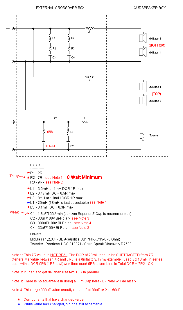

Note the Elsinore Mk6 design uses an LC trap with values of 2mH and 33uF - this trick and the Waveguide means that only a single cap of around 1.5uF to 2.2uF makes for even lower distortion. It is a terrific combination that deserves to be widely used.
Cheers, Joe
PS: The Elsinore Mk6 Crossover below - worth looking at as an example:
