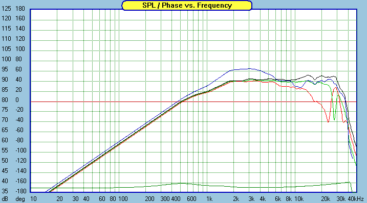

I'd say yes it's doable. But seeing as this is sort of new ground for DIY'ers, you're probably going to be on your own. I don't think I'll be building a larger waveguide myself, simply because I have too much else brewing at the moment. (like a 50" high, 6 driver 3.5 way)
Below we see the before and after of the dome with and without the waveguide. Black = flat baffle and blue = waveguide. We get a 6 dB boost in efficiency, centered on about 2.5 kHz. It's "only" a 6dB boost because the waveguide as I modified it is relatively short and shallow.
While the waveguide I used was 6.5", it's effectively a bit smaller than that because of the gradual radius of the lens. Now, if we use the Parts Express 8" lens, without the outside radius it's effectively a much larger lens. I would expect the boost to be much larger and centered much lower in frequency. I wouldn't be surprised if it's centered at 1kHz or lower, easily making a 1kHz crossover point possible. Remember, the increase in efficiency just means the tweeter will not have to work as hard to reach a certain level and that's why it can cross lower.
I also wouldn't be surprised if the boost was around 10-15dB rather than the 6dB I got with my shallow lens. With the bigger boost, don't expect a single cap to work like it did for me. The crossover will take a lot more work to get it flat.
Go for it and let us know how it turns out.

Just for grins, here's a 1/2" waveguide on a Vifa D26NC55. It doesn't really lower the potential crossover point at all, but it does give about 3dB of boost centered on 3.5kHz. Actually, this is usefull, because a waveguide this small will still exhibit diffraction ripple on a baffle, and there's usually a dip right in the 3-3.5kHz area. So, while it's small, it does serve a purpose. (and it makes the odd flange easier to mount from behind too)

Crawling thru the pile of horns at Partsexpress, I see the B+C ME10, at 90x60 degrees, and the Sammi Sound SH-150 at 90x90 degrees as the only ones close to that dispersion. Though I wonder how good/bad a different dispersion might work in different rooms/different situations.
John, looking again at your graph, I see how the boost does taper off to 3db or less by the time you get to 1Khz. So, a larger one would be desired for crossing down low with 8"ers or more...
I'm wondering what happens to the angular dispersion curve in milling down the PE 75 deg horns.. a symmetrical horn curve wouldn't change, an exponential would? And the PE horns are "nonconventional"... whatever that means. Would be nice if they did widen their pattern as they were shortened. Best way is to dive in and start experimenting...
And a question on the '1/2" waveguide', 1/2" piece of MDF and roundover bit? ;-) Have to figure out the OD of a 1 1/2" roundover surrounding a 1 1/2" hole... probably only about the same as the 6" we already have.. and we probably need a much flatter curve than the radius. How big do massive panel trim bits get?
