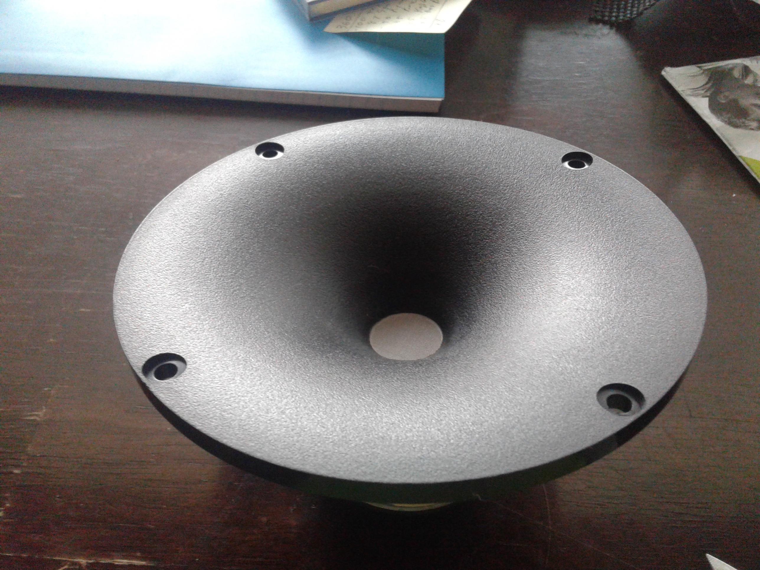

Mine were from mcm and are "h-65" 90 degrees by 90 degrees. Mine are threaded, i have a 2407h on mine, works well x-over 24db @2khz.
Worked well with silver flute 8", but i suspect it would have been even better with dual 6.5" silver flutes.
