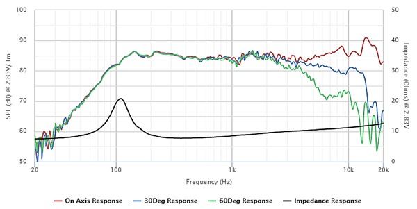

Looking at the factory SPL graph, the driver looks prety ordinary above 10kHz, and horrible off axis.
I'm hoping that maybe a small waveguide might give a better SPL than surface mounting.
However, unless I can improve the SPL (with enclosure, waveguide, Xover), I intend to add a LF filter with a F3 around 15kHz.

2, 3. Yes in that cut at > ~30 deg.. FWIW I always did a simple 45 deg as a 'catchall' and smoothing beyond removing any burrs/sharp edge is strictly cosmetic IME.

As I've said, I know nothing about waveguides, but I was also hoping that a waveguide (in the 18mm MDF baffle) might improve the response above 10kHz.
