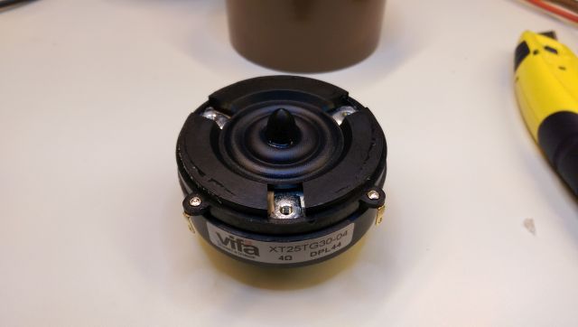

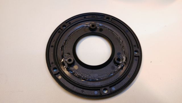

I received a question about getting the faceplate off the XT25 tweeter, because the faceplate of current versions of this tweeter is glued on. Luckily, the glue bond is not strong, and the two are easily separated. Here's how I did it, it is less than five minutes work for a pair.
First, I put the tweeter face-down taking care that the phase plug is not pressed in or pushed sideways. I used a roll of tape to put it on. I then took a Stanley knife and made a cut in the glue all the way around. This doesn't need to be all the way through, just a shallow passing with the knife is enough. This may help the glue to tear off easier, but it will probably also come off fine without cutting.
I then took a small flat bladed screwdriver to pry the glue joint open. Find a weak spot in the glue joint, and gently insert the screwdriver between the tweeter and the faceplate. Wiggle it a bit, and the glue joint should start to tear apart.
When you have opened the glue joint a bit you may try to flip the faceplate off, like you open a book. It helps to bend the faceplate up a bit by cupping your hand over it, and putting your thumb underneath it. Hold the tweeter in your other hand. The glue should now start to tear easily, and the faceplate should come off without excessive force. Most of the glue will remain on the faceplate, a fingernail is the perfect tool for cleaning up the tweeter if you wish.
See the attached pictures. It is really easy, if you can open a can you can do this too.

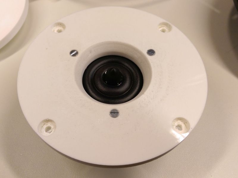

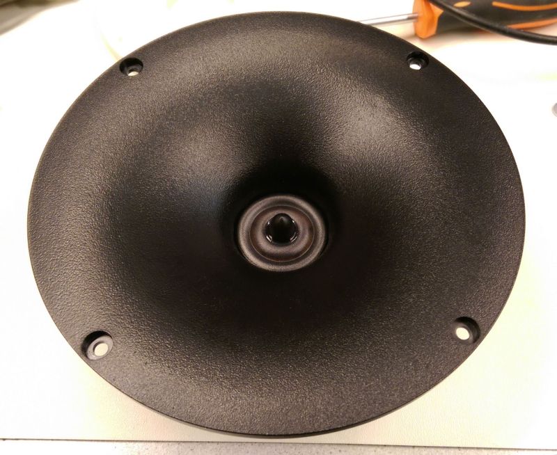

Adapter plates are here!
The adapter plates that XRK971 made have finally arrived. They didn't fit immediately, the throat hole had to be enlarged a bit with sanding cloth, and two nubs from the casting had to be cut off/sanded down from the waveguide in order to fully insert the throat through the plate. But after that was done, they fit nicely, and most importantly, the thickness was right. I will check and update the CAD drawing, and upload it so everyone can have his own 3D printed.
It's been a while since I last logged in. I need to make a small modification to the CAD file, and then I'll upload it, so you can print it yourself, or have it printed at a 3D printing hub or shop. As it currently is, the throat flare is a tiny bit too narrow, so you need a piece of sanding paper and some elbow grease to make it fit.
Corrected adapter plate STL file
And here it is...
It should be okay now, and if the throat hole is still too small, a light sanding will fix it.
I have used acrylic filler to fill the cavities in the waveguide, and I have used silicone caulk to glue the tweeter to the adapter plate in the same way the tweeter was glued to the original faceplate. This will ensure that there is no air leak from behind the tweeter into the waveguide. Although with my test cases I found out that it is highly recommended to give the tweeters their own compartment, so that the pressure from the woofer does not act on the waveguide.
And here it is...
