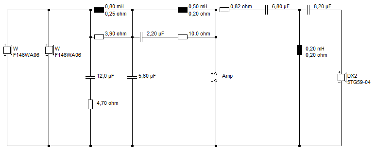

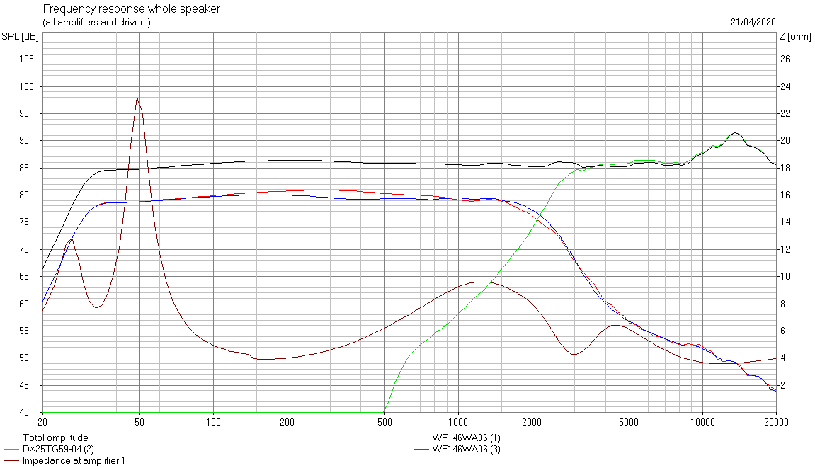

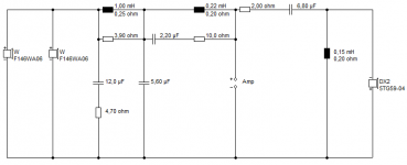

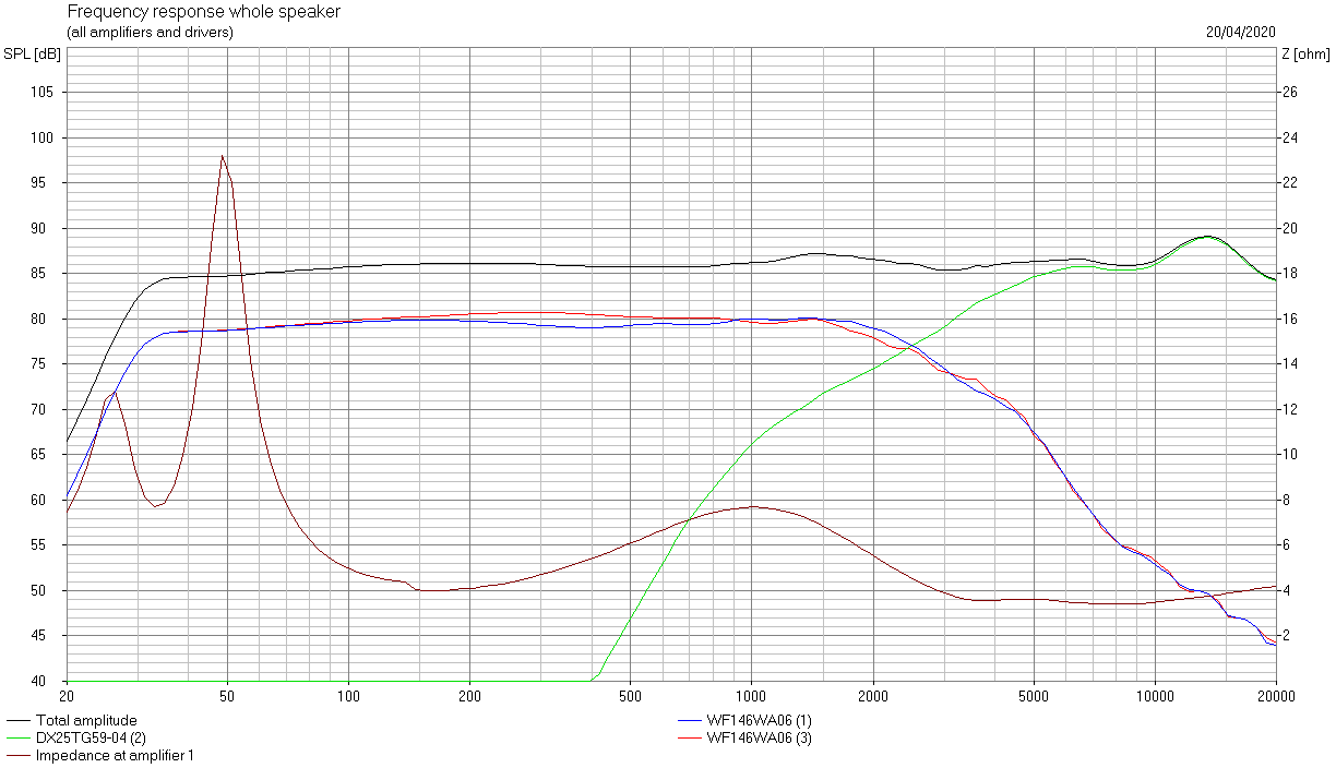

I think I've got a starting point in the design. I just don't know the phase data for the tweeter. I traced the curves to get impedance and FR. I like the small bump around 1.5 kHz - from past experience, this sounds good to me. Otherwise, it's looking ok for a start, I think.
I've used a few of Wavecor's cheaper (pressed steel frame) small drivers - they're excellent: flat response, efficient & easy to cross over, and work well in a smallish box. 50L is way too large, low bass extension is not one of their strong points. I'm currently using the WF146WA01s in 20 L, tuned in the mid 40s.
I kinda don't care about bas extension, as I'm planning a small 2.1 system but I need a relatively cheap bass/mid and I have my eyes on the WF146WA06. Your measurements looks quite alright.
