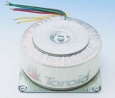

Transformers (3 of them) will be approximately like this. Please let me know if yours will have different sizes:
http://cgi.ebay.com/500W-Toroid-Toroidal-Transformer-Int-Power-amplifier_W0QQitemZ250439486758

I'll use different transformers, but maybe not that different in size.
I'll give you the exact measurements.
The rest is ok.

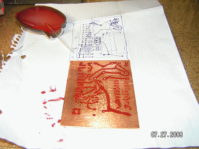

Drilling holes in the power supply PCB... However, it is time consuming task to make PCB such a way, but it would cost $150 for one board and few days to wait. Hundred of PCBs for prototypes to save money on quantity is not a good idea: prototype is a flexible thing and may be changed many times until is done.
Traces are drawn by so called Grandpa's method using a paint. Tomorrow I am going to etch it using Ferric Chloride. It removes all copper clad leaving what is covered by the paint. The board contains B+ and filament rectifiers, filter caps, and voltage regulators.
Etching the PCB in a Ferric Chloride that I'm afraid may be already weak. One of places where it can be bought is there: http://www.j-tron.com/category/PC_Board_Making_Chemicals,_Accessories.html
It comes in powder form, and needs to be dissolved in water slowly and carefully, since water may start boiling. Rubber gloves and eye protecting glasses are needed, the work should be done in well ventilated place. It must be stored and used in glass or plastic vessels.
However, when I bought the powder it contained an instructions' paper with corresponding warnings.

You can get a little more life out of FeCL by heating it up to about
100 degrees F and bubbling air through it as you etch. The etch
rate increases with temperature. Time to get out the fishtank heater...
